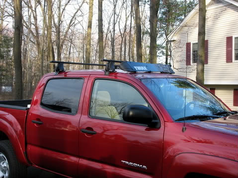

    Here is my Thule setup. I bought it at Rack Warehouse.com which is actually local to me. Its on year-round (bars/feet/fairing). The J-Hulls I only keep on when I'm in season. They come on & off easy. I can put three 12 ' kayaks up there. :thumbsup: The system works great for lots of things, not just the boats. Also, my nerf bars help with securing the straps. I have to say this is one of my favorite mods. I opted not to have the lock cylinders so at first I did experience a whistle on the driver's side tower. A piece of electric tape stopped the whistle & blended right in. Anyway here it is:

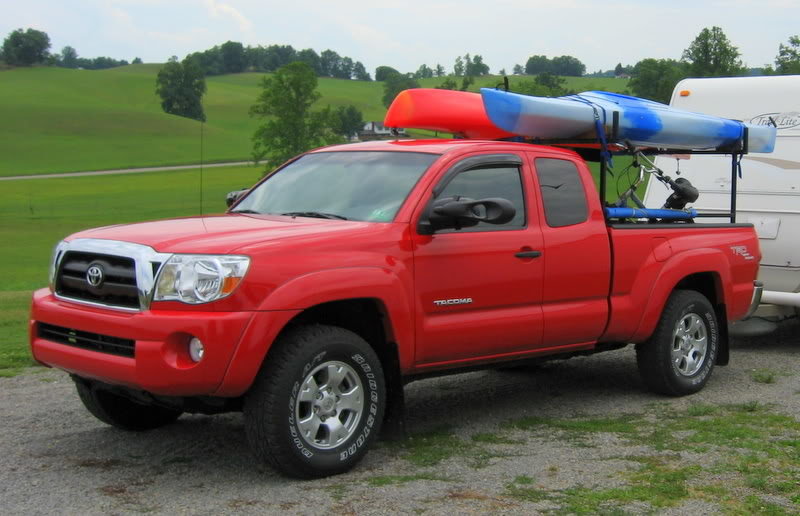

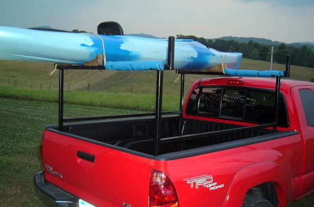

    You may want to make your own rack. I made me one 7 years ago, I made it to use in my 2001 Tacoma and then had to change it a little to work in my 2005 Tacoma... today it is still going strong in my 2008 Tacoma.
    When I was shopping for a rack I wanted one that could easily haul 2 - 12' Kayaks. I also wanted one that I did not have to drill any holes in my new truck and one that did not touch any painted surface. I could not find anything like that so this is what I came up with.
    It mounts by using two bolts in the existing d-ring holes in the back of the truck bed and two turnbuckles in the front of the bed. All you have to do is take out two bolts, loosen two turnbuckles and set it out of the truck when not in use.
    ES-6, jamestown, AsadaTaco and 2 others like this.

    Nice rack ! :eek: he he. Seriously though that is well thought out, what part of West by God ? I call Parkersburg/Vienna home .

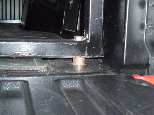

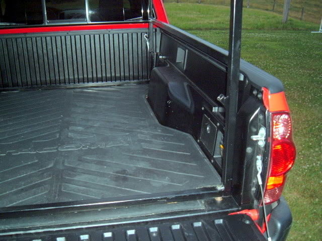

    Here are some pics of the mounts, the rear of the rack bolts in where the factory d-rings are mounted and I had to make a small spacer to go between the rack and the bottom of the bed.

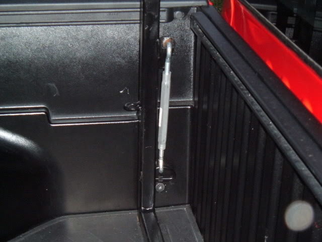

    The front of the rack just mounts to the d-rings that Toyota sells for the front of the bed. I use one turnbuckle on each side.
    The pieces of square tubing that you see welded on the rack at a angle was how I mounted it in my 2001 Tacoma. I used 4 turnbuckles that went through the square tubing and hooked on the factory front and rear tie-down points.

    one more pic

    Thanks for all the pics rachunter! I like how the frame is boxed at the bottom and your have bars above the bed rails. Nice to lock stuff down like bikes etc. Cool rack!
