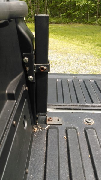

    These are permanently bolted to the bed, the racks slide into them. Took a little bit of cutting and drilling, but not much. Metal was a bit thin behind the tailight housing so I used extra large washers. This might not be everyone's cup of tea, my truck is my DD and weekend runner, so it isnt kept pristine. I like saving money and making things work.
    Rear anchor:
    Front anchor (used carraige bolts in the tie-down rail)

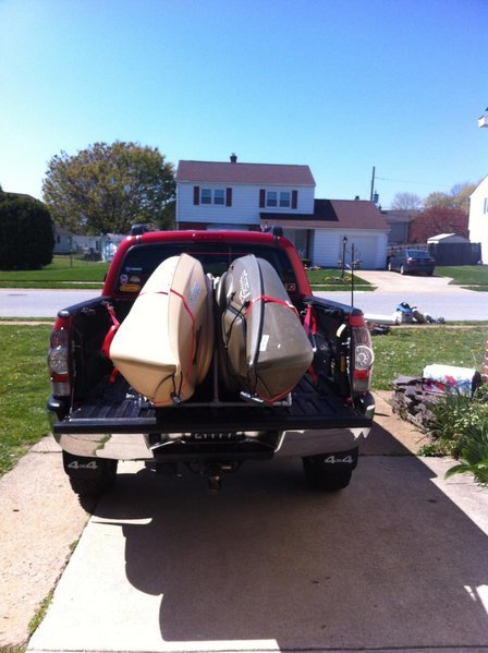

    i only have 10' sit ins, and with some PVC, i made a rack to stand them on their sides.
    its shaped like a double U and the yaks sit in the center of them. like 10 bucks worth of PVC tees and elbows.

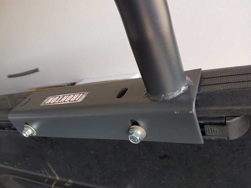

    I just purchased the Northern Tool Ironton 4 post Utility Truck Bed rack! Right now it's $50 off and only $79.99. What's great about this thing is that it's ready to accept hardware to bolt it straight to the BED RAILS in our Tacoma's. Can't believe I haven't see anybody post this yet or figure out that this thing works with the bed rails. I will be using it to haul Kayaks as we just got a travel trailer and used to just put them in the back on the bed, but they are too long with our travel trailer. I didn't want to pay $300 and up for a rack and this fit's perfect. Sturdy too.
    It'll take me about 5 to 10 minutes to remove also as I just use the t-slot nuts off of Amazon and a socket wrench. Comes off in 1 big piece.

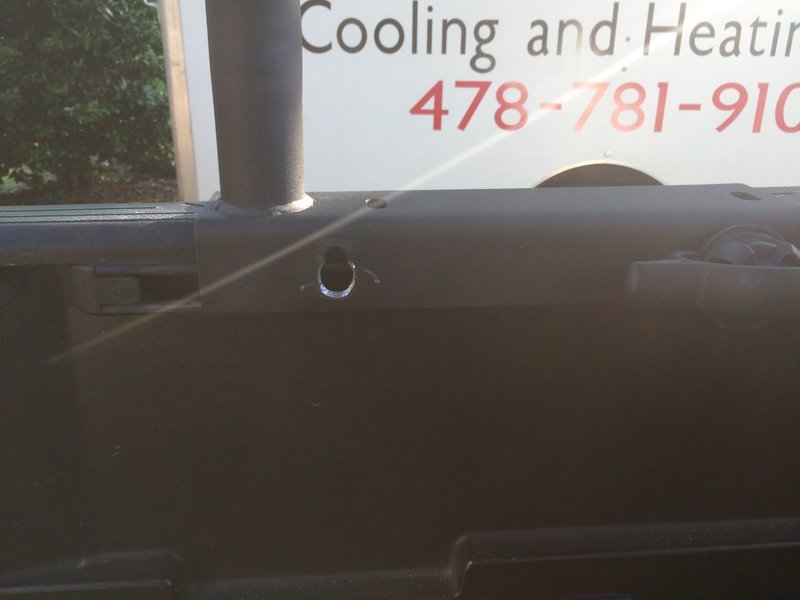

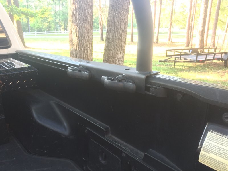

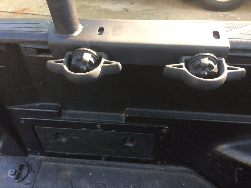

    I bought the iron ton from northern tool then dremeled out holes to be able to pop in the bed cleats for easy removal/installation
