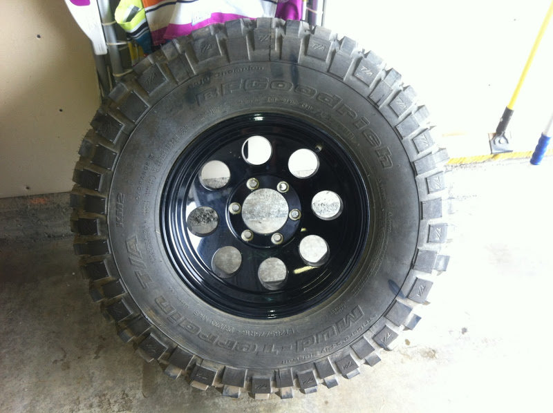

    Good cheap wheels. I am about to have 5 of those wheels for sale for $150 if you want to save some cash. $300 if you want the tires too. Tires are 285/75-16. You would probably be better off running the 265's though.
    16x8

    I'd have interest in buying these... if
    they are the Wheeler's/ProComp 8069's @ 4" bs ?
    they look glossy so I didn't think they are 7069's
    I could make a drive to get them...
    don't need the tires tho'
    let me know.
