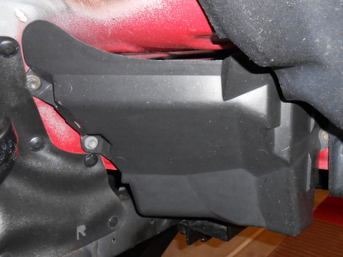

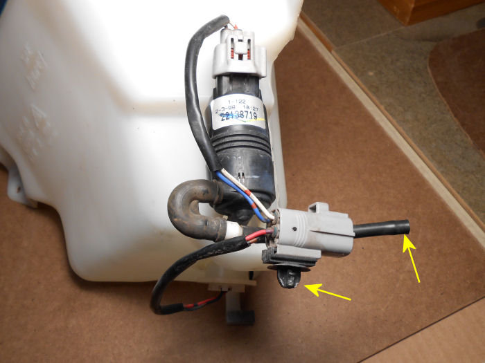

    I just replaced the reservoir on mine due to the typical cracks on the neck. There are 2 tanks, standard and "cold weather". Mine was the larger "cold weather", $80 from Camelback Toyota.
    There is a "shield" for the "cold weather" tank, it keeps rocks thrown off the tire from battering the larger tank.
    OP in your pic the pump is nearly upside down. There is a little "nub" on the top of the pump (bottom in your pic) that fits into a slot on the tank. If you are talking about the 180 deg molded rubber hose directly off the pump, there should be little wire spring clamps on each end. If you are talking about the little plastic 90 deg elbow about 3" past the pump or the rubber 180 itself you will just have to improvise with vacuum hose as I do not see these parts sold separately or at all for that matter. Make sure the leak is not from the pump/tank grommet or the low level sensor/tank grommet.

    It seems to be the elbow. I inverted it to be the way it is now and it seems to be working without a leak.
    I'll reorient the pump to be upside right. I'm doing my best without much of a manual or anything to go by. If I change it to being "up," the hose will come out facing the back of the truck. Right?

    Here is a shot of how things are arranged on mine. The clip on the bottom of the harness plug fits into a hole on the shield. A 90deg plastic elbow, about 3/4"x3/4" goes into the end of the hose.
    I noticed the pump nipple that goes into the tank had a very sharp "barb". It could easily cut the grommet when removed.
    The shield fits like a second skin to the tank.

    So based on what you've told me here my leak is no longer an issue. Apparently the pump being upside down was the issue. This works just spiffy now. Thanks again for your help and advice!!
