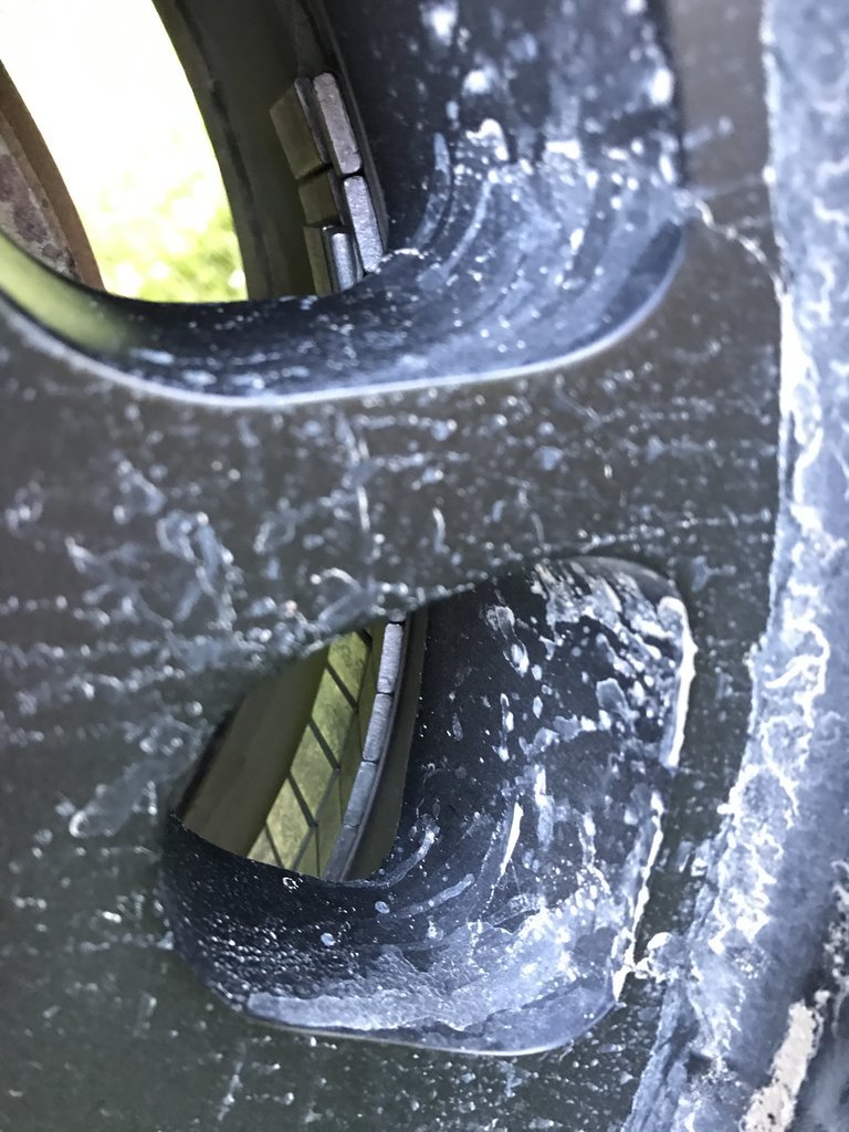

    Like the title says, Firestone has tried to balance my 285 75 16 BFG's on Method wheels twice now and I still have considerable steering wheel shake above 55 mph. I'v already done a 2,000 mile trip since having them put on and will be doing another 1500 miles next weekend, so hopefully this isn't causing abnormal wear.
    Here's a shot of the weights.. the tech said he just had to keep putting more on. The front desk guy said they don't do road force balancing because of the time involved. Is this something I should look for in a shop, or should I bring in balancing beads like they suggested?

    Are they being dynamic balanced or static balanced? Are they brand new tires or are they chopped to shit? Has the tire been broken down and spun 180 degrees and rebalanced? Do you have a bad wheel? Some wheels call for a shit ton of weight. Most balancers have an option to balance a bare rim to see if it's out of wack.

    18 oz. All except 1

    In my entire automotive career I have maybe roadforced 2 tires. If you balance off-road wheels the right way you will never have to use road force. There is an art to it. Aftermarket wheels in general give a very crappy ride. Just the way it is. Even oem wheels can be garbage. I have one bad wheel on my truck. Trd off-road beadlock wheel. No matter what tire I put on it, it calls for 8oz of weight in the exact same spot. Needless to say that one stays on the right rear.

    I would balance the bare wheel and see what numbers you get. If it calls for a bunch of weight you got some crappy wheels

    Another question to ask is if their balancer is calibrated. If I have problems with chasing weights I recalibrate the balancer and it usually seems to solve the problem
