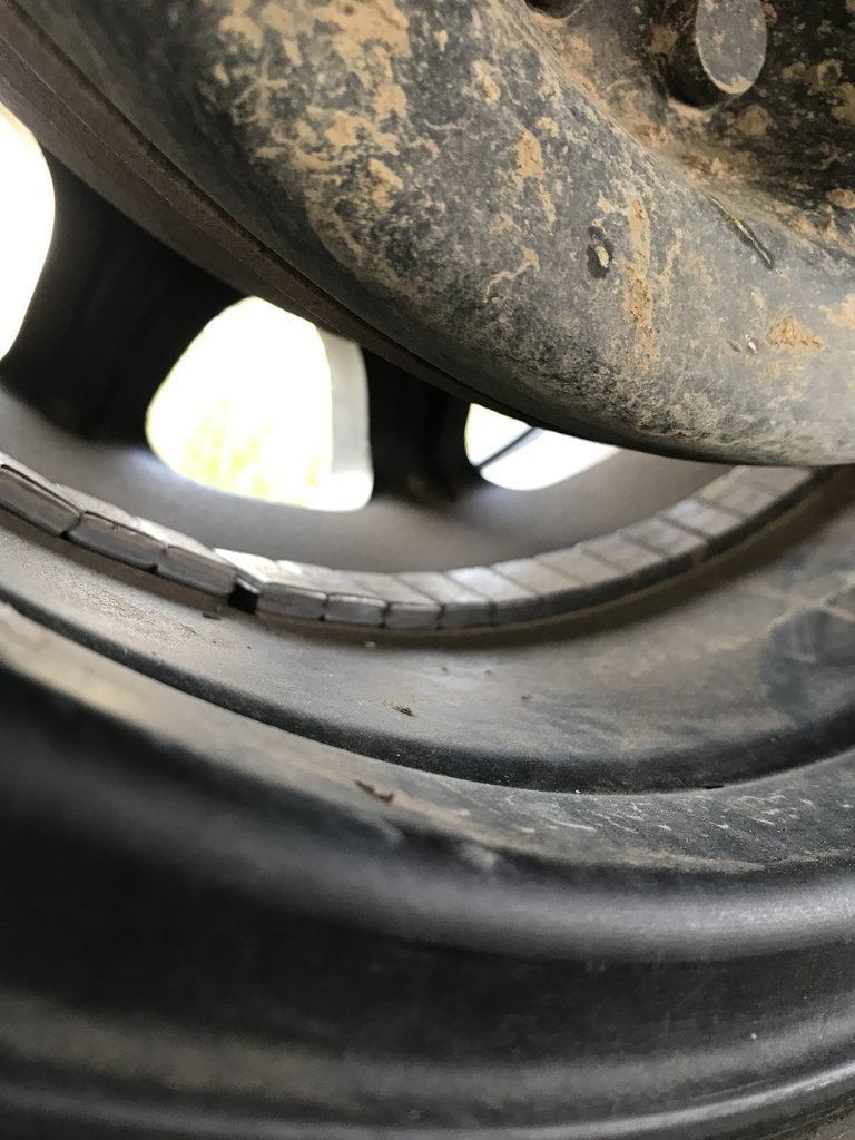

    Probably spoke too soon.. pretty annoying vibes on my highway drive yesterday. Checked the wheels out and they still have a lot of weight:
    Not sure if I want to retry a 4th time at another road force shop or just try mounting the ko2's on my old fj wheels and try selling the methods at a loss

    It might be the tires. I had a similar issue with my 285s where two of them took 13oz. Discount tire road forced balanced them with no luck said both weren't out of round and might have been a bad mold. They ordered me two new tires at no charge and those only took 3 oz.

    Are these new tires? If not, Cupping can cause balance problems that can't be fixed.
