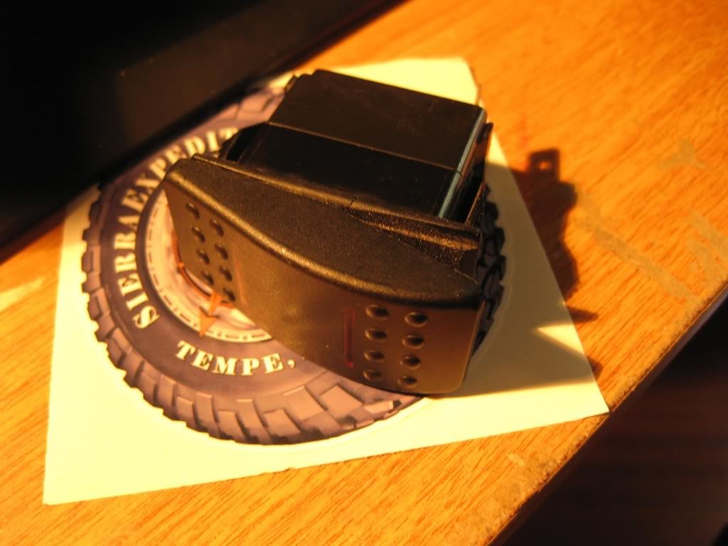

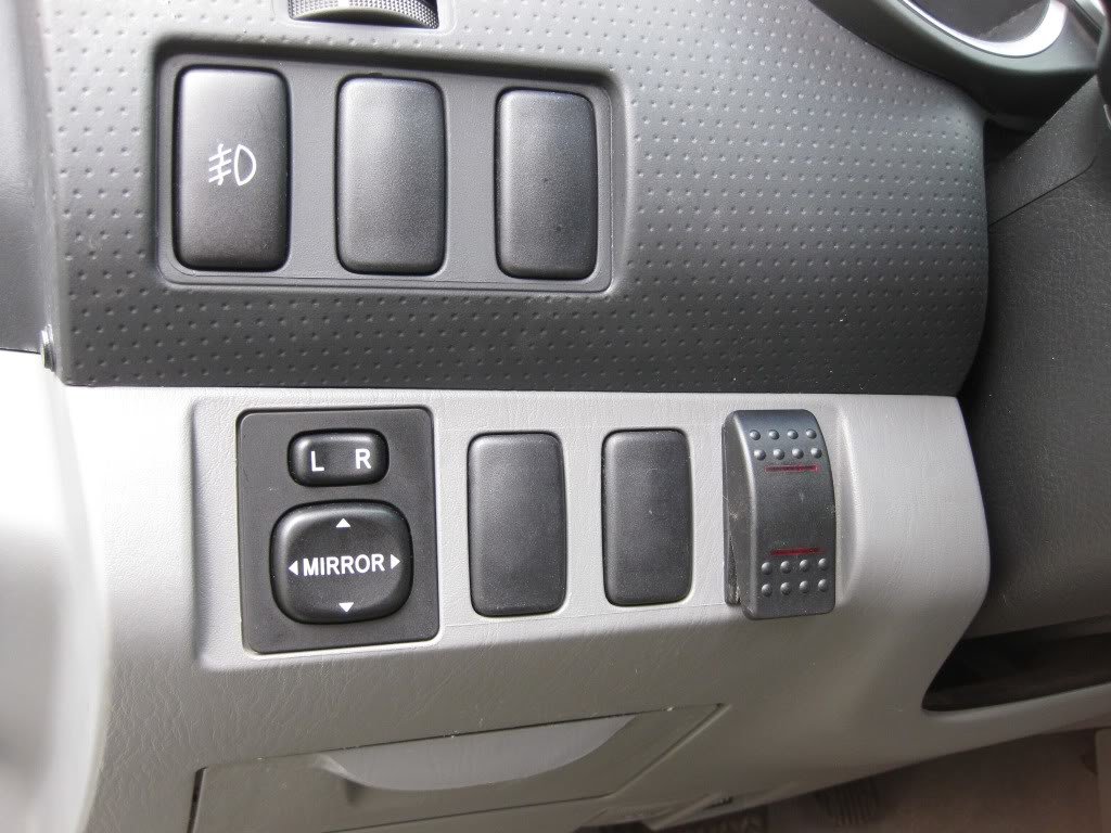

    I got a Carling On-Off-On from OTRATTW.com

    I also got the Diff Lock cover for it. So I know that it "enables the diff lock" and no one knows that it's actually to kill the ABS.

    Don't those switches bulge out a little? I have seen one in pictures before and it seemed like it did.

    They do stick out, about 1/2", not a big deal though. Also they are not an exact fit, just Dremel out the hole a little.
