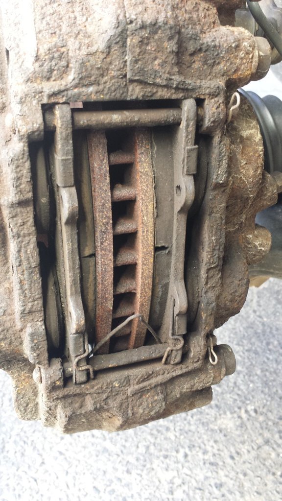

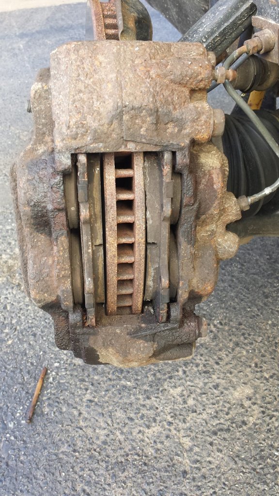

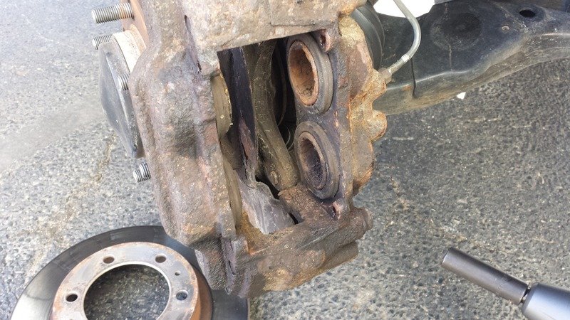

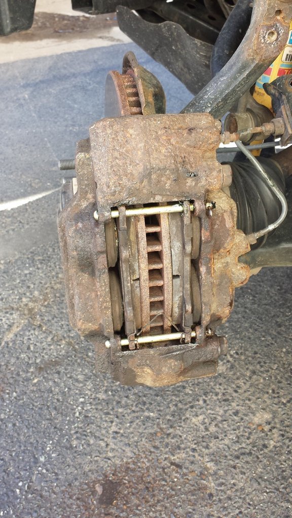

    Ok guys im embarrassed to post these pictures ... but here is what i found.
    i pumped the brakes with the truck off until vac assist was gone and the pedal held firm and held for 30+ seconds with no movement. I watched the drivers front soft brake line as best as i could while doing a balancing act and pumping the brakes and did not notice any expanding of the lines .... now here is where the problems started. With the wheel off and me pumping the brake while watching the back of the caliper/pads i could see the pads flexing and only the middle of the pads moving slightly. The pads were certainly not sliding on the pins as they should.
    The caliper/pins and such were way more corroded/rusted than i thought they were.
    Took a fair amount of pounding and pulling to get the pins out as they were frozen in the caliper. The pads were not moving on them at all. They got tossed

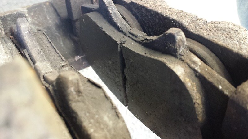

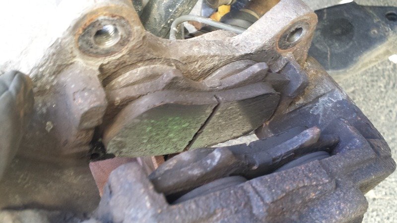

    The pads were frozen to the pins, to the pistons in the caliper and to the caliper body itself. They were not moving what so ever. I think the only braking I had was the middle of the pad flexing. surprisingly the pads didn't look terrible and were not worn all that non uniformly

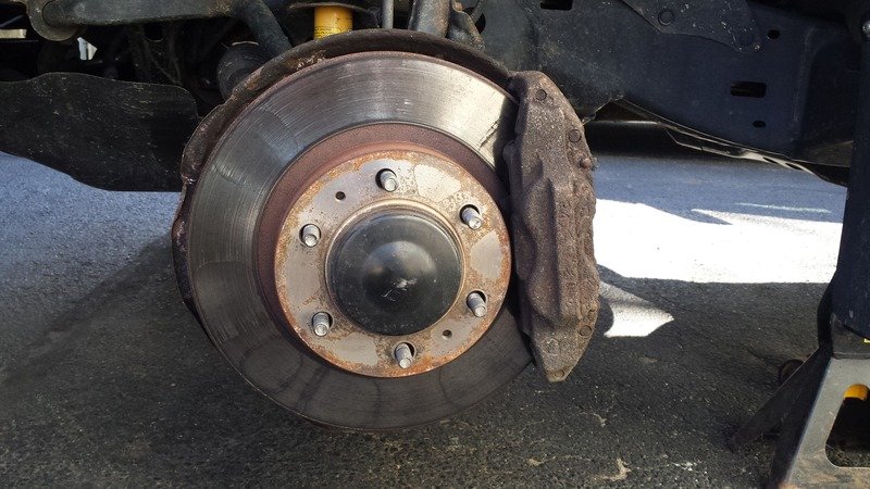

    What do you guys think of the rotors ?
    It took a lot my 24" pry bar to get the pads out of the caliper bodies. I cleaned up the pads where they make contact with the pistons/body of the caliper. applied a very think layer of caliper grease to them to keep them from sticking and installed them back with new pins with some grease on them. Everything seems to be working and sliding like it should be at this point.
    I put everything back together with the parts i had after cleaning them up for the short term and the brakes are 10x better than they were. I guess I did not realize how bad they were. The inside lower piston on the passenger side caliper is frozen and i could not get it to retract. I am leaving on vacation this week for 3 weeks so i dont have time to put replace it all before i leave. When I get back I am planning on replacing both calipers and getting new pads. The rotors have a warranty on them so i will probably turn them in for new ones as well.
    At this point im just happy i didn't crash from it being the way it was or hit someone else. I am certainly adding a check to my regular 5k mile maintenance to check the brake pads/pins and making sure they are freely sliding. I am usually pretty good about keeping a eye on stuff like this and killing corrosion/rust before it gets to bad but I guess I have been slacking on this one. Lesson learned.

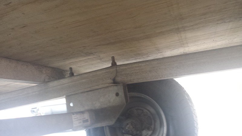

    On another disappointing note i found this today also when i went to pressure wash off the trailer from last weekends trip. Guess I dont have to worry about pulling a trailer for a while until i get it fixed/replace the trailer. The main frame rails on both sides cracked right where the axle bolts to it. Is it summer yet ?

    Your plan to replace most of those parts is a good one. The rotors could be fine, just measure to be sure, then clean up with some scotch pads if they are ok.
    Be sure to get into your rear brakes as well. They are likely what has been primarily stopping the truck; I suspect the front pads have barely been engaging due to the calipers being partially frozen. Betting you'll find a fair amount of service work needed there, just to have things all cleaned up if nothing else.
    Thanks for reporting back for those of us who like to learn from stuff like this! Be sure to bed the new pads properly. It doesn't matter if the rotors are cleaned up or new, the pads still need bedding............
    With the cleaning and new parts & Castrol LMA brake fluid with a good bleeding, you'll be amazed at your new found stopping power!
