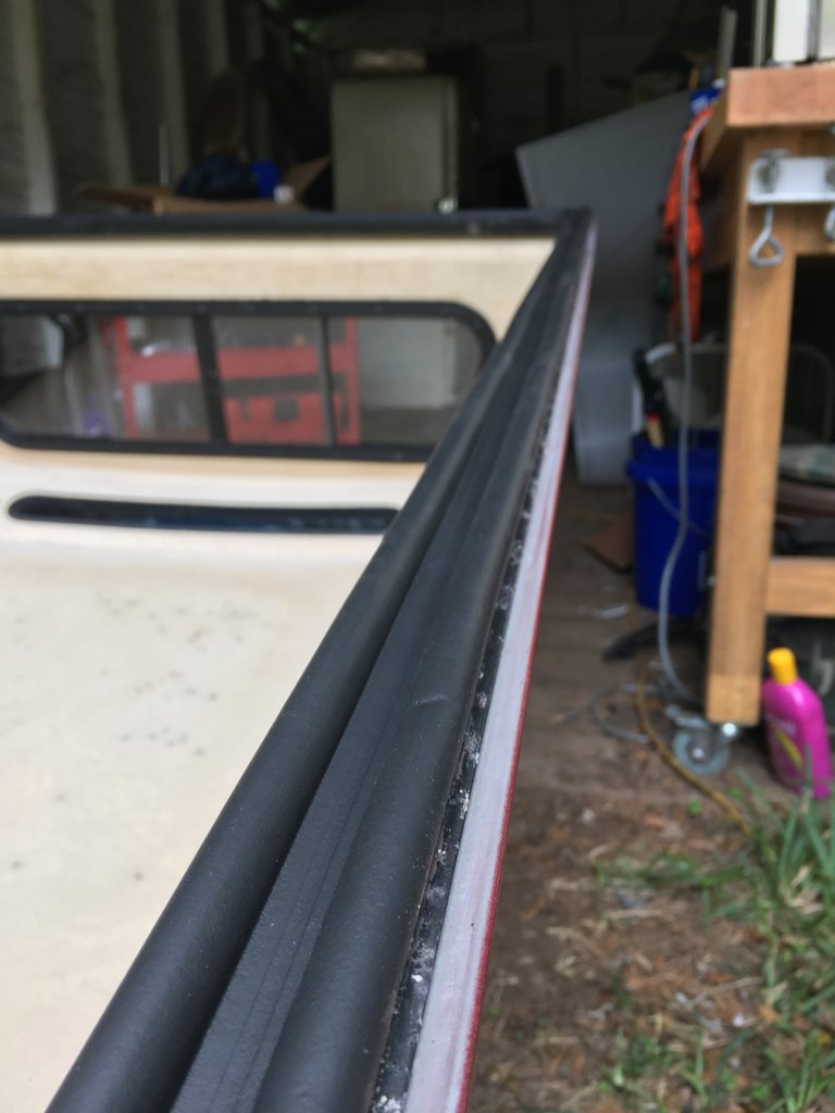

    Yep the one I posted above. https://smile.amazon.com/dp/B00NCC0SY6?ie=UTF8&psc=1
    I mitered the front corners and did one continuous strip starting at a rear corner. I left the outer "bulb" intact when I cut the miter. I still have some small leaks at those corners just due to the way the bed is designed. The kit comes with some butyl rubber you can use to fill in small gaps.
    I talk about it briefly here: https://www.tacomaworld.com/threads/tiffany-the-taco.374490/page-8#post-16172629
    I just pulled the topper off and placed it upside down on the grass. I will say, make sure you know where the seal will line up with the bed rail. I didn't make note of this and mine ended up a littler farther inboard than I wanted. It still works fine, it just hangs into the bed a little.
