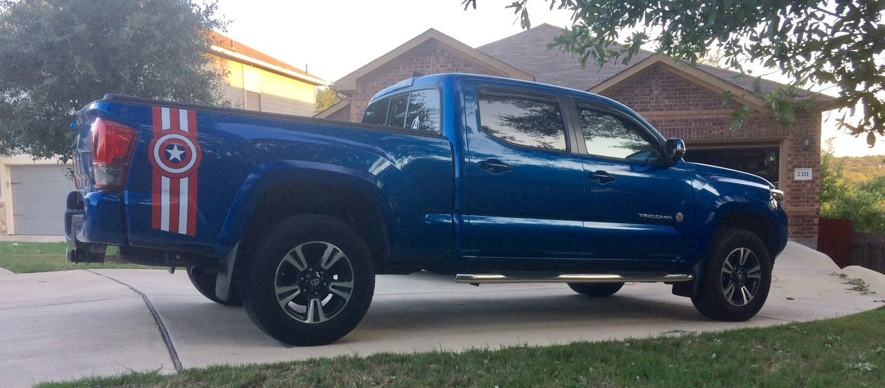

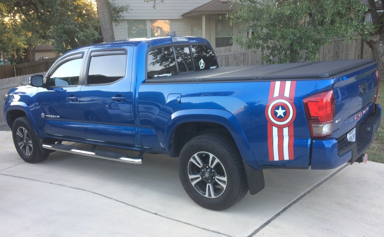

    So I've gotten to play a little bit today thanks to @amirak.

    Looks awesome! It will be hard to miss you driving around town.

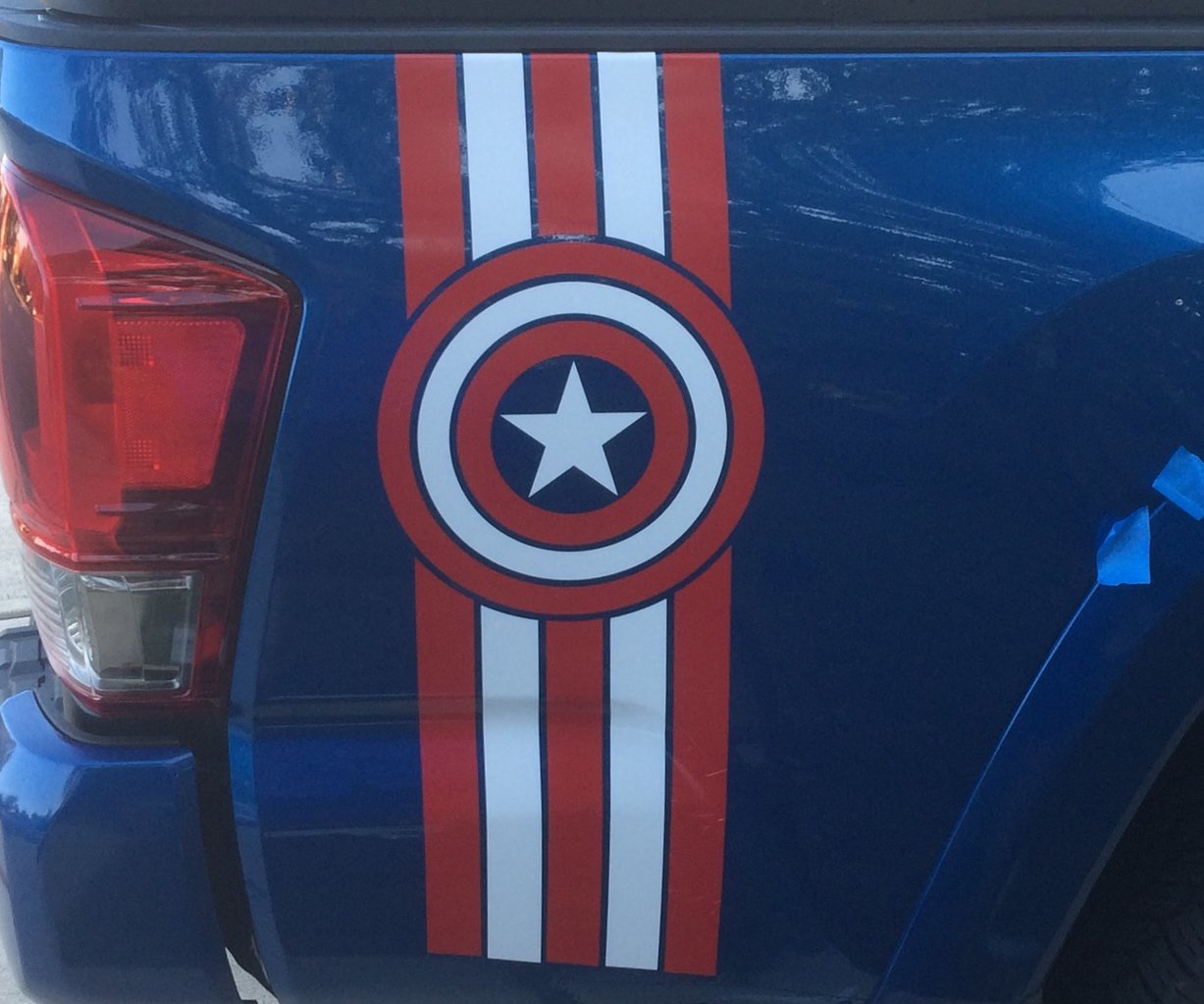

    You cut the bottom at an angle? They look really sexy. Great install.

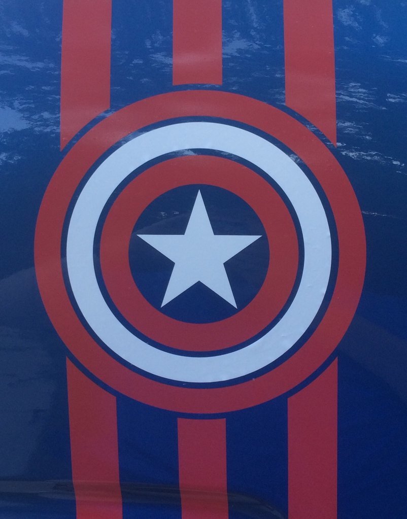

    Yes. There's a thick, clear rock chip protective decal down there, and I didn't want the two interfering with each other. The angle loosely follows the flow of that clear decal.
    The red got a few bubbles, and there are quite a few creases trying to get around the curved furrow down at the bottom. I'm expecting that sitting in the sun will bake those bubbles out. The white, going on wet, came off without a hitch.

    Always wet soapy will result in best install. Leave it in the sun and later pop the small bubbles with a very new and sharp xacto knife. Good work. You are now Captain America truly and fully.

    Usually Oracal 651 is so flexible it will blend in with clear decals already on the car. All you need is a low-powered hair dryer and gentle fingers. In you case, the diagonal cut you made made the decal pop. Good work.
