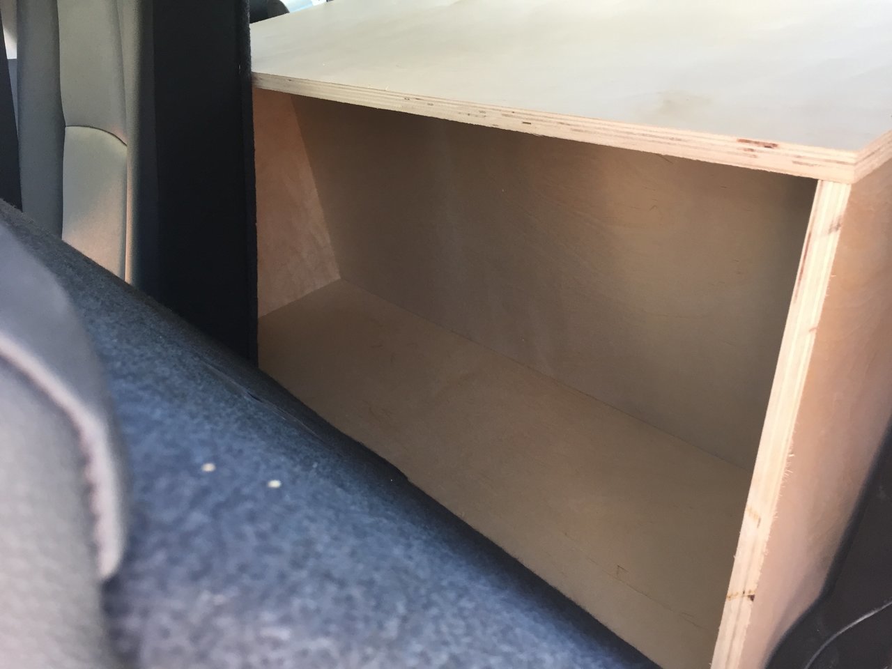

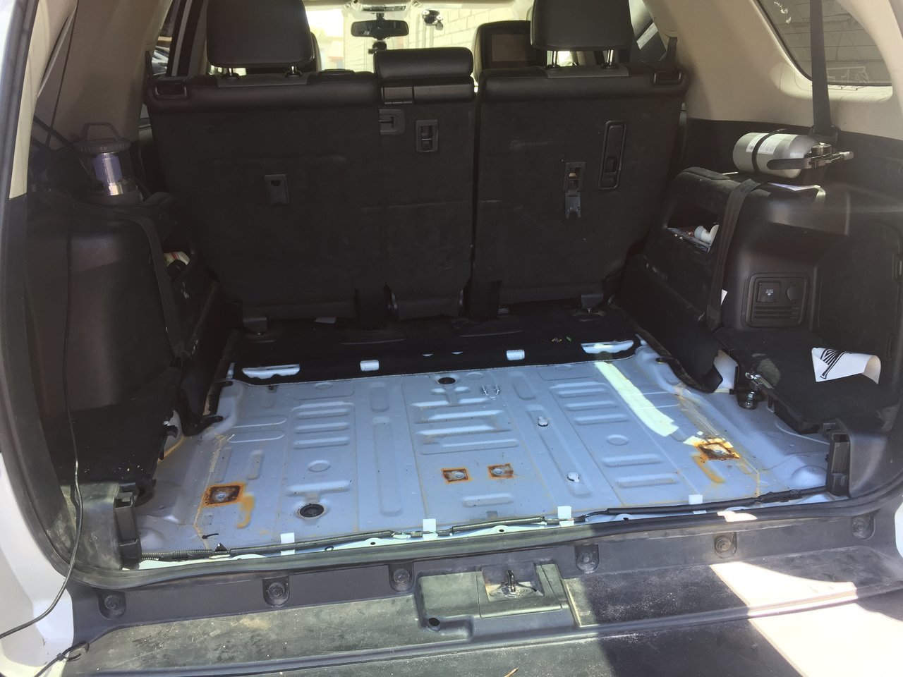

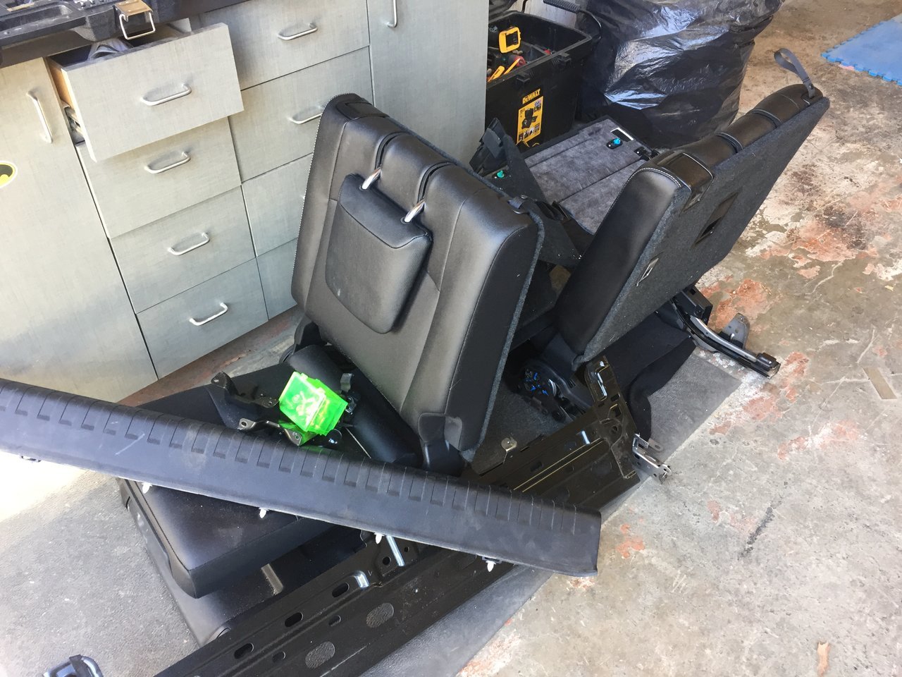

    Cargo slide/fridge slide drawer system/sub box being built
    That pic is just of the third row finally being removed

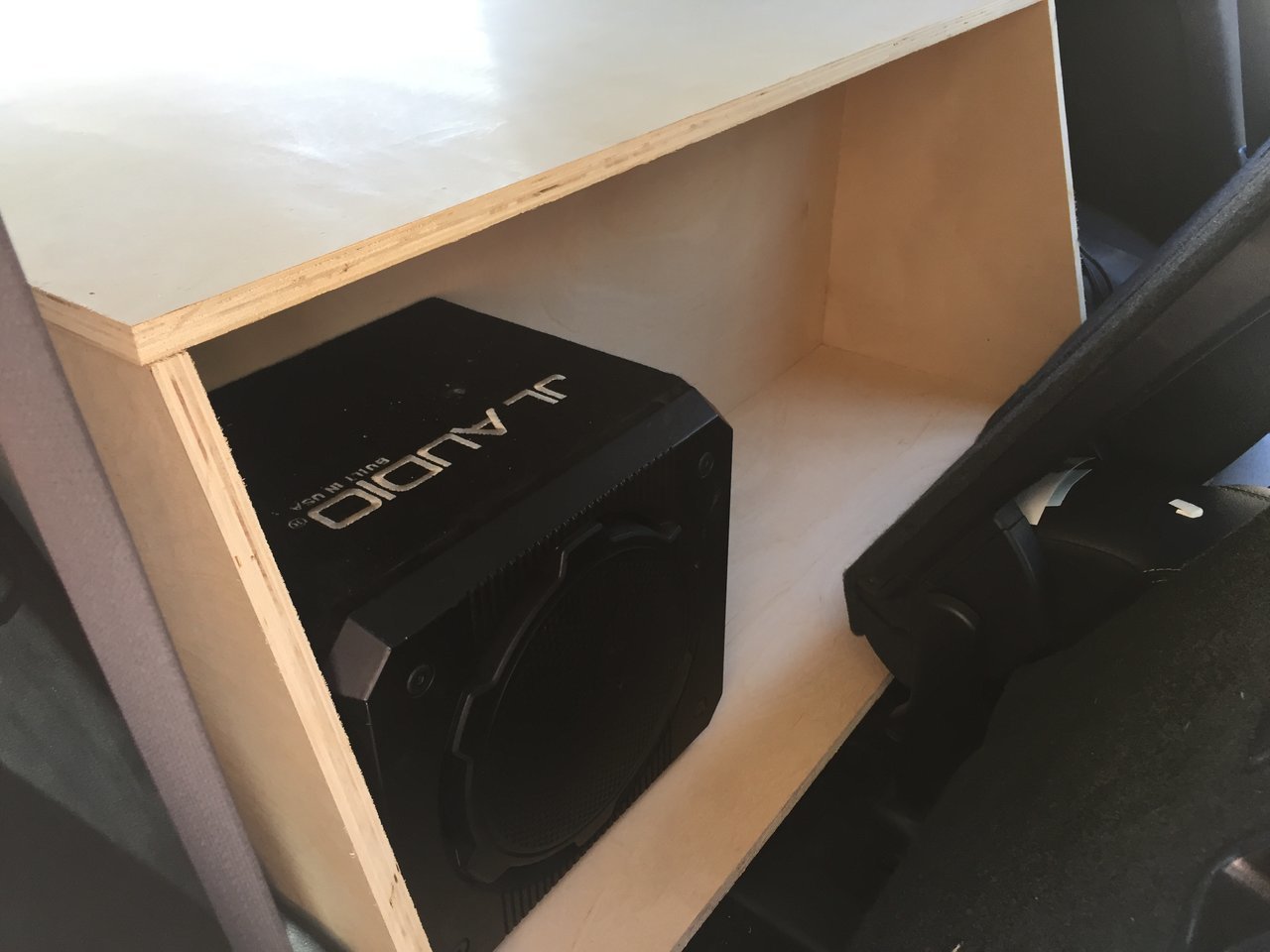

    Update on the first prototype
    Lost 120 lbs of seats.
    Drawer boxes. One will have a cooler and one will have a slide for a tote that can strap down to it. Someday it will be a fridge instead of a cooler.
    My favorite part is the hidden compartment for the sub and whatever else I can fit.
