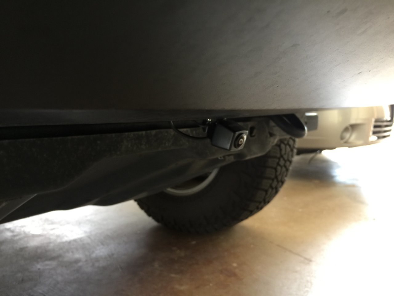

    I mounted my camera under the front license plate OEM holder, worked great. I am waiting to hear about my problem, I contacted the company and sent them a picture of my HU
