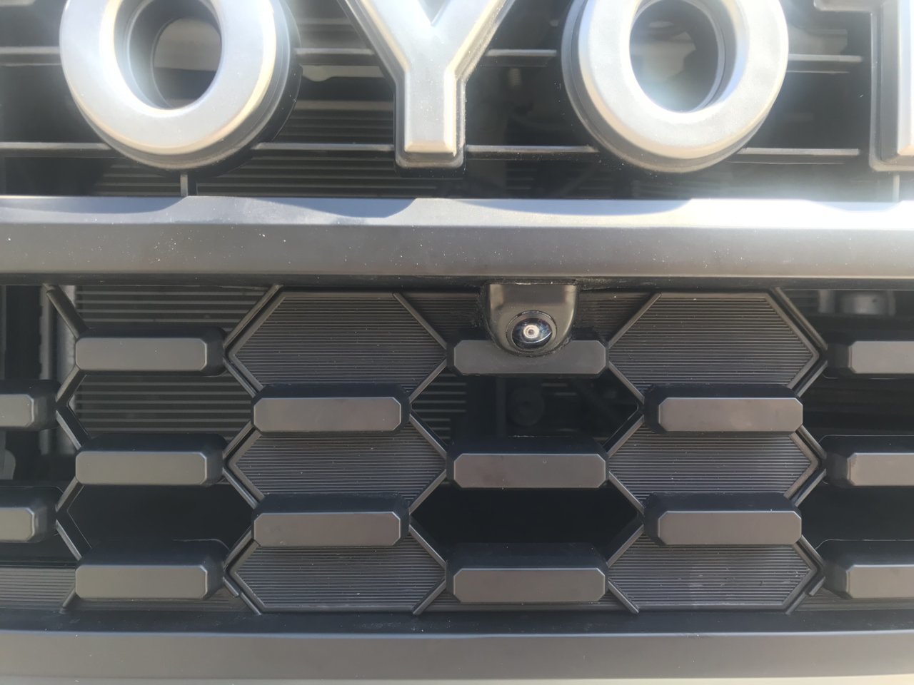

    Just installed the module. Had the camera installed in preparation. In hindsight probably shouldn't have installed the camera incase it didnt work but luckily it was fine and everything is working like it should. Did not test drive and check the function but will be on the look out for whether I have any issues in regards to TSS or anything like that. Camera is installed in front of the sensor as close to center as possible.

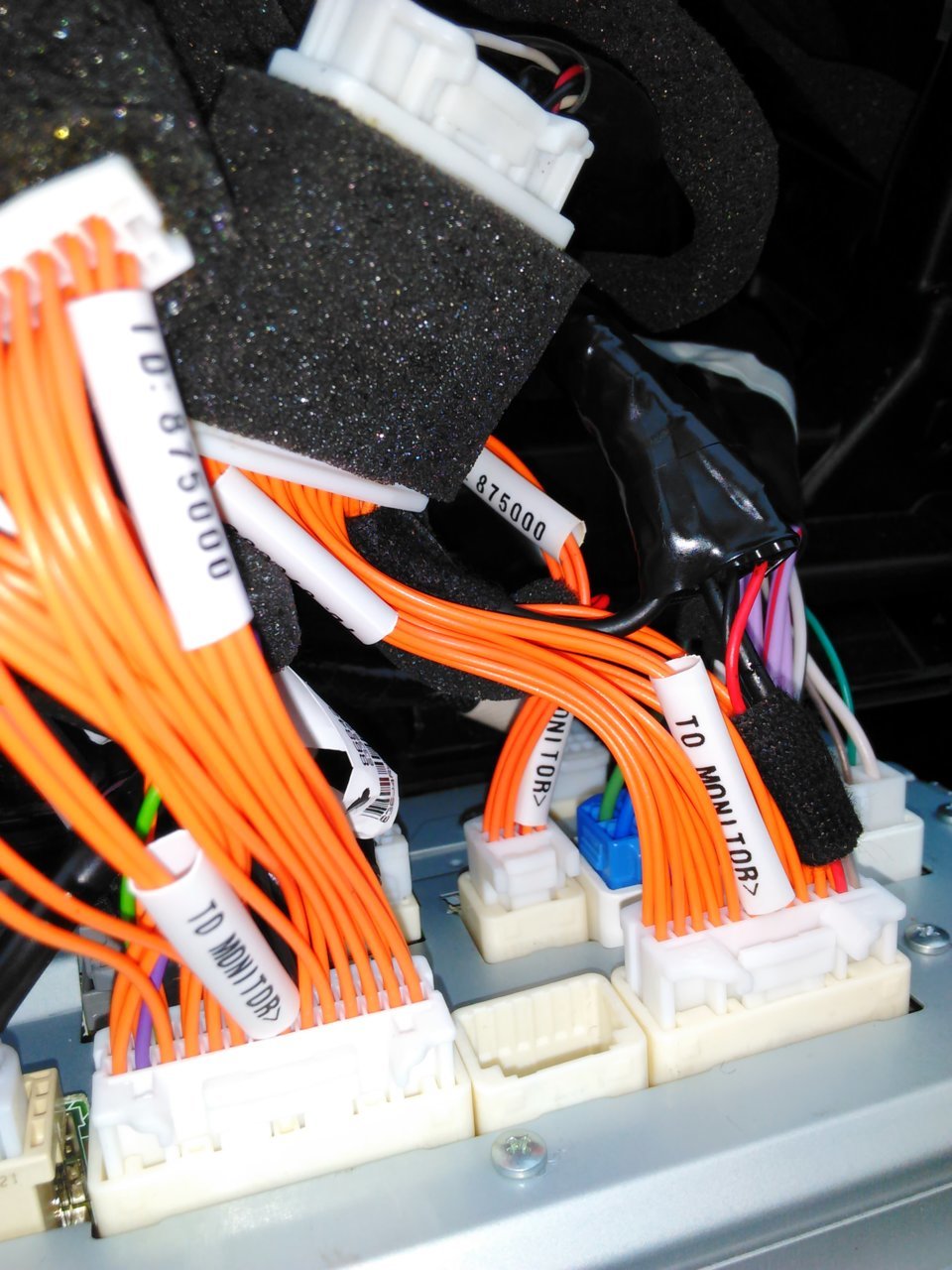

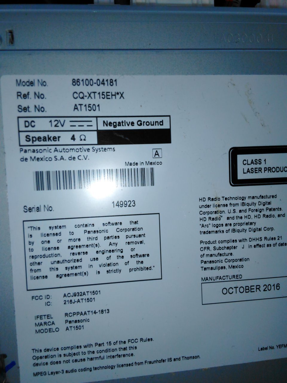

    I just finished the install and noticed that the connections on my radios head unit are slightly different than the OP's post.
    Everything works great it's just the connections are different.

    I noticed the same thing. I think it was the smaller plug was in a different location

    I really don't remember if it did or not but it did have the flush mount part threaded on not the wing mount so I had to swap those around

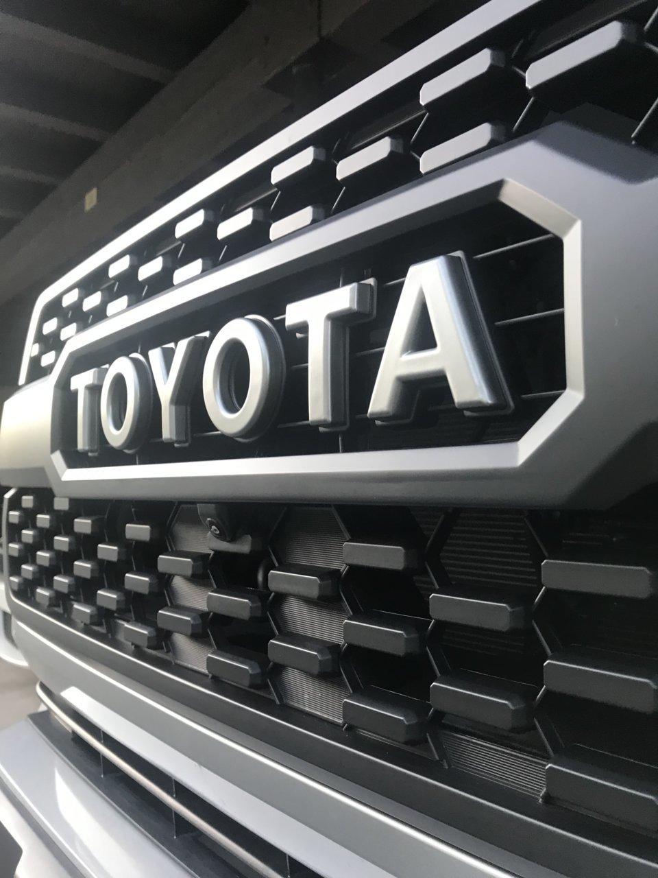

    Just installed it a day ago, money well spent. Tried to keep an OEM camera look With the grill.
    The unit also works with mirroring system. I didn’t like how the mirroring unit heated up so fast so I removed it in the install.
