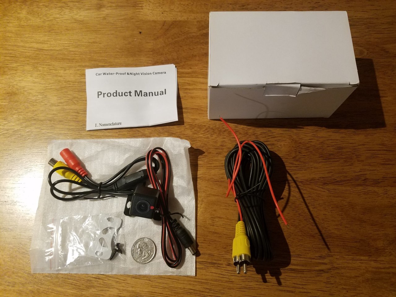

    This is the Natika camera kit I got. The connector on the camera is a single plug with no RCA connector on the camera side. Only the extension end that gets plugged to the HU or CS kit has an RCA and trigger wire built in to the cable. I figure that I don't need the red and black power cable and may just snip them off so I have one small cable to run. I'll probably run the excess cable under the driver side carpeting in a wound bundle to keep the excess there.

    Don't snip off the red and black power cable. That's what powers the camera !
    I bundled the excess cable up and zip tied it up behind the dash. It would be a bit much to stash under the carpet.
