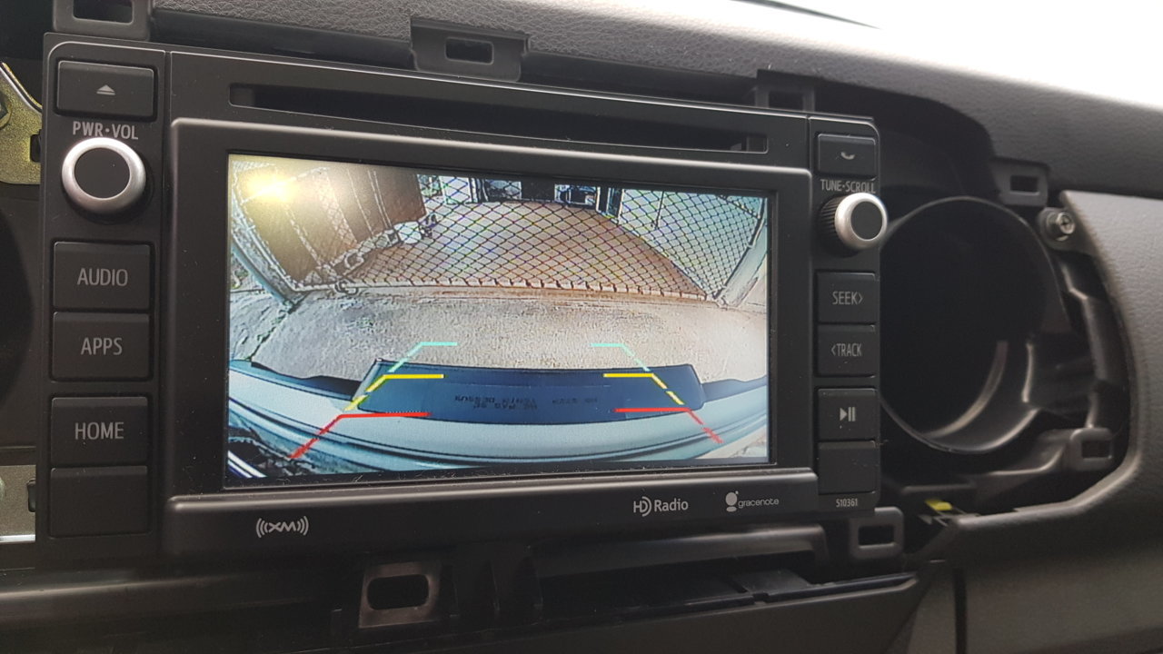

    Looking good ! When I first installed my front camera, I kept the grid lines activated, thinking that I might later disable them. After a while I decided that the grid lines were barely noticeable and handy sometimes.

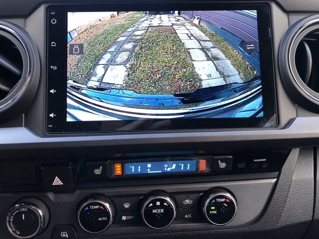

    I finally got my Nakita front camera securely mounted in the grill with a 3D printed adapter. Parking is so much easier and the interface on the head unit is easy to use.

    Looks like an Android head unit. Did you use the CS controller with it? What model head unit. Very clean looking install.

    Yes, it's a Dasaita PX6 Android 9.0 unit. Not sure what the CS controller is. Everything on this unit was plug in play.

    Got it! That's not required with this head unit since that functionality is supported out of the box. Thanks for the explanation.
