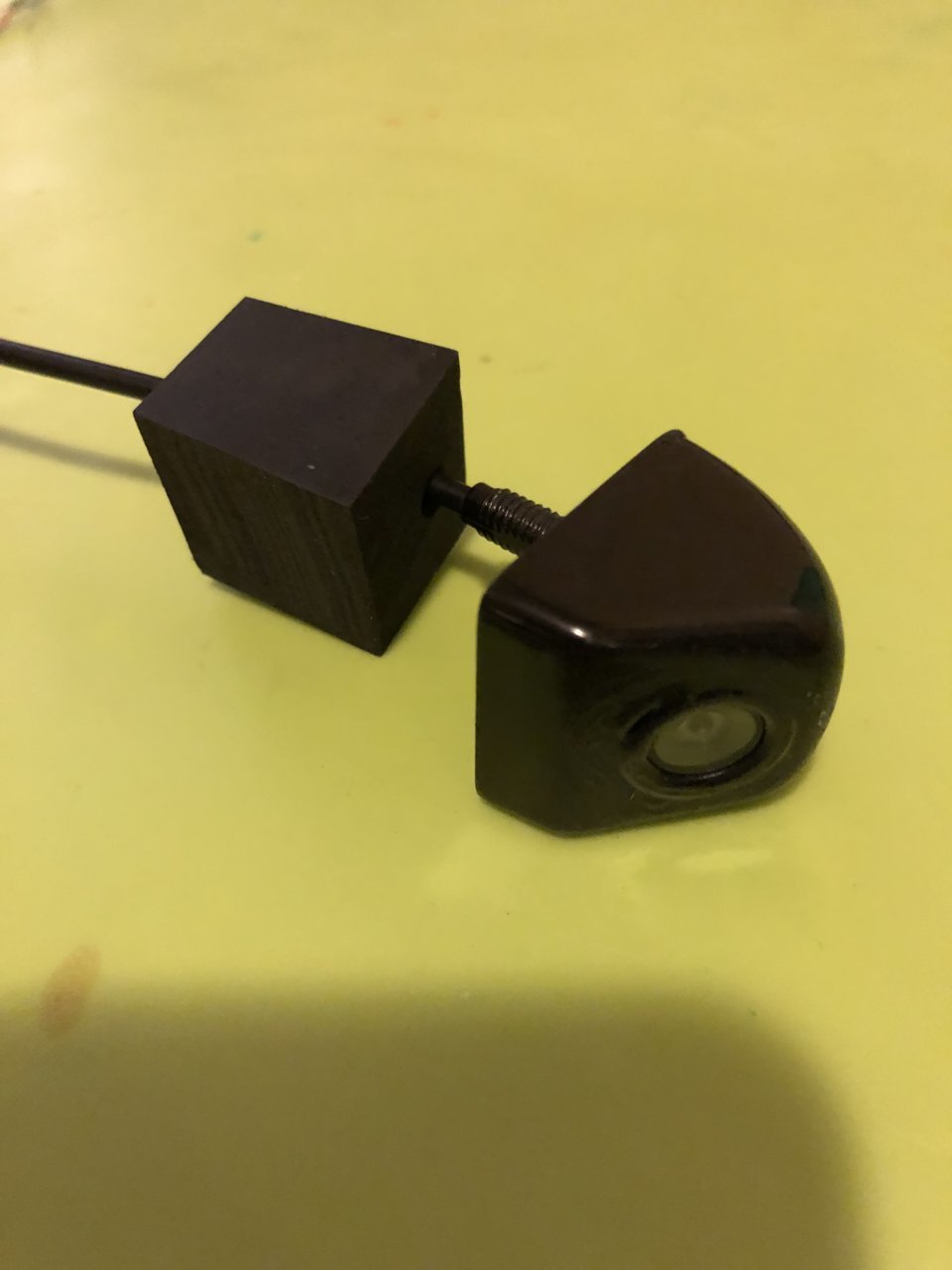

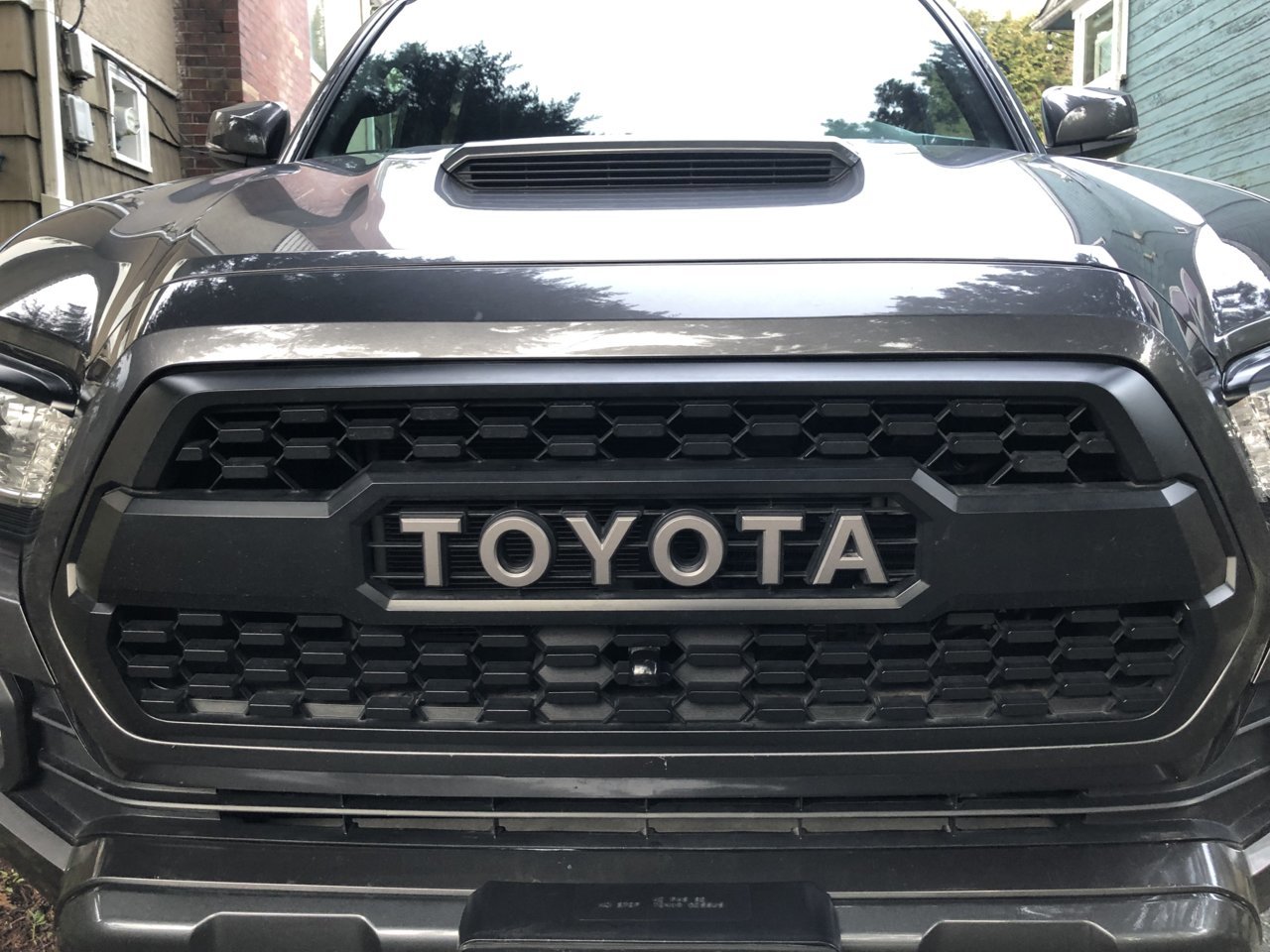

    I did my install today. I cut a hockey puck to mount dead center of the insert, as I didn’t want to notch or drill into the pro grill. Wedge it into the grill.
    Super easy install. My only negative comment is that it takes .5 of a second longer to see the rear camera when shifting into reverse.

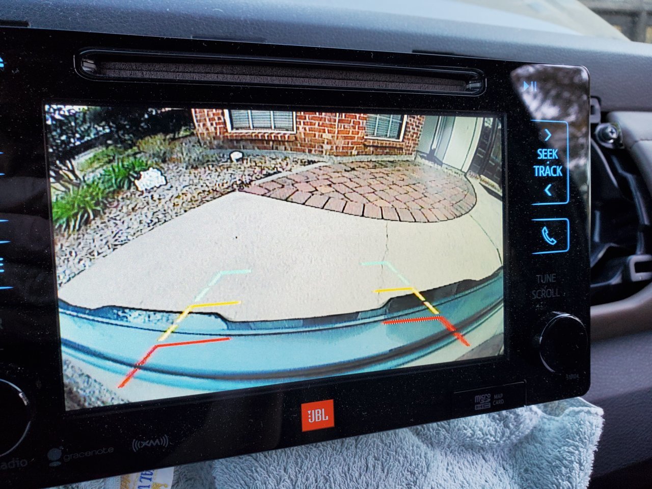

    @abidar @payrow or someone else that has installed this.... especially if you installed it on a Entune JBL Premium . . .
    WHERE is the RCA connector that goes to the truck's OEM rear camera? Or is there an RCA connector to that cam?
    Am I supposed to connect the "Rear" RCA jack on the CS cabling to anything? I'm not seeing any existing RCA plugs anywhere. :annoyed:
    Thanks in advance!
    EDIT: I guess I answered my own question by plugging in the front cam temporarily and reconnecting the battery then trying reverse and fwd with the shift lever. So for anyone else wondering, the OEM rear camera doesn't have an RCA plug to connect. The HU gets its signal from one of the other harness connectors.

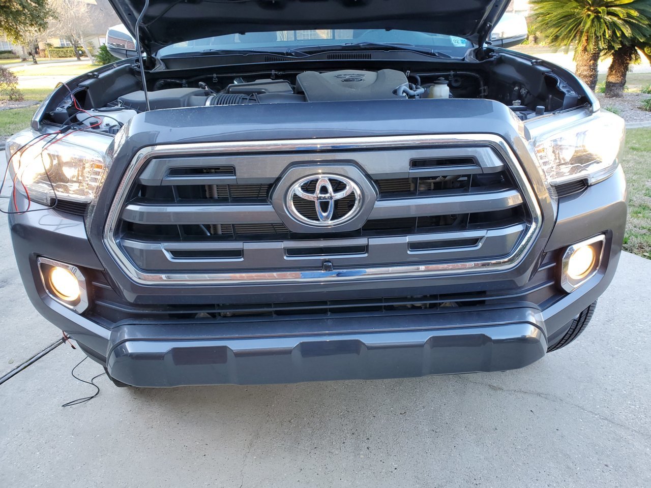

    I haven't run the wiring through the firewall yet, but I found a centered mounting location for the camera (in just about the only place possible on a 2017 Limited grille) . . .
