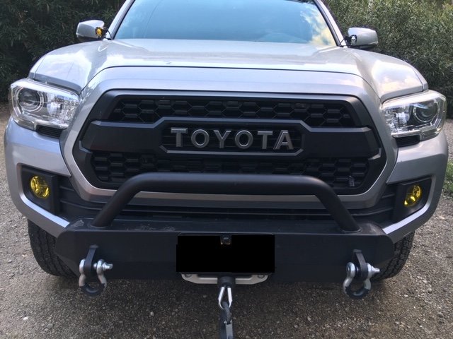

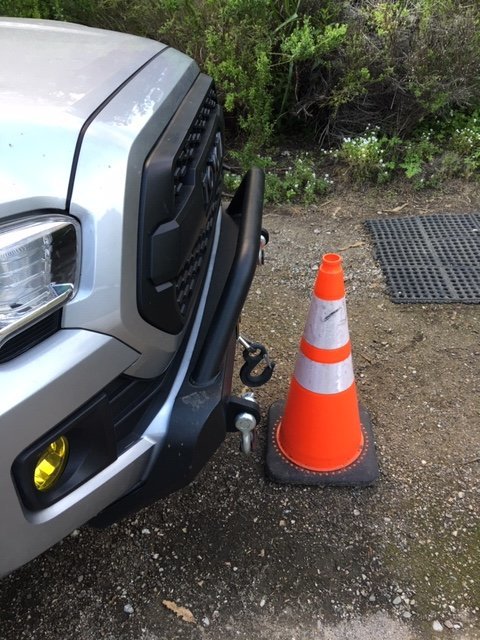

    Car Solutions/Natika Front Camera on Warn 100044 bumper
    Very happy with the Car Solutions system, especially for the convenience of steering wheel control of the camera as opposed to separate switches.
    The Warn bumper hoop obstruction makes the hanging camera install from the Pro grill described in this thread impossible.
    I drilled the bumper on center and installed the Natika WD-011 camera there. The front bumper almost disappears and the winch hook provides a great distance perspective.
    Foster Imposter, DES2009 and Tmaloy like this.
