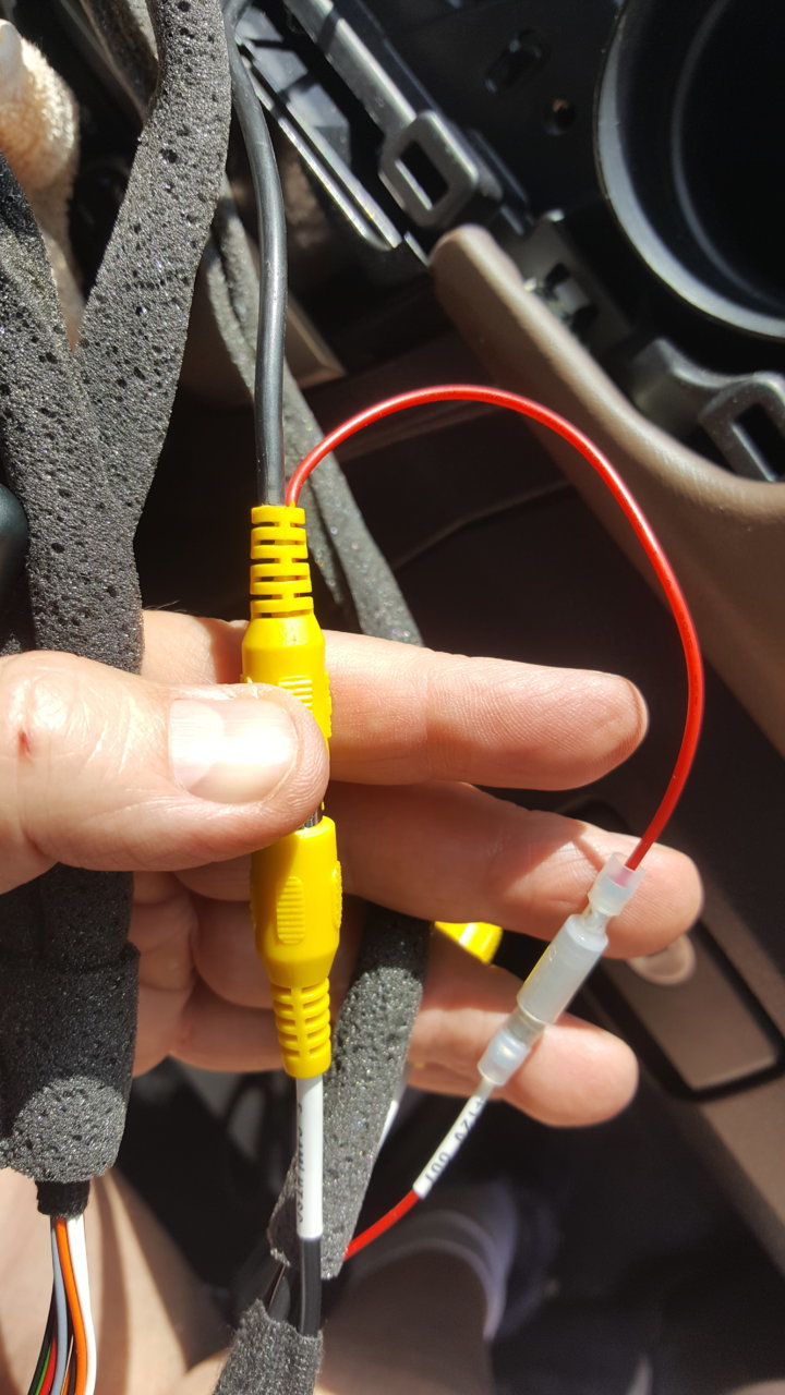

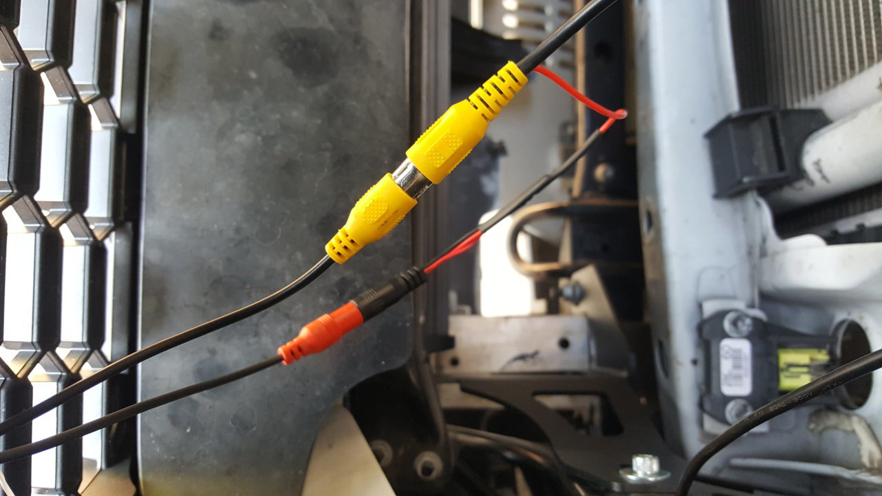

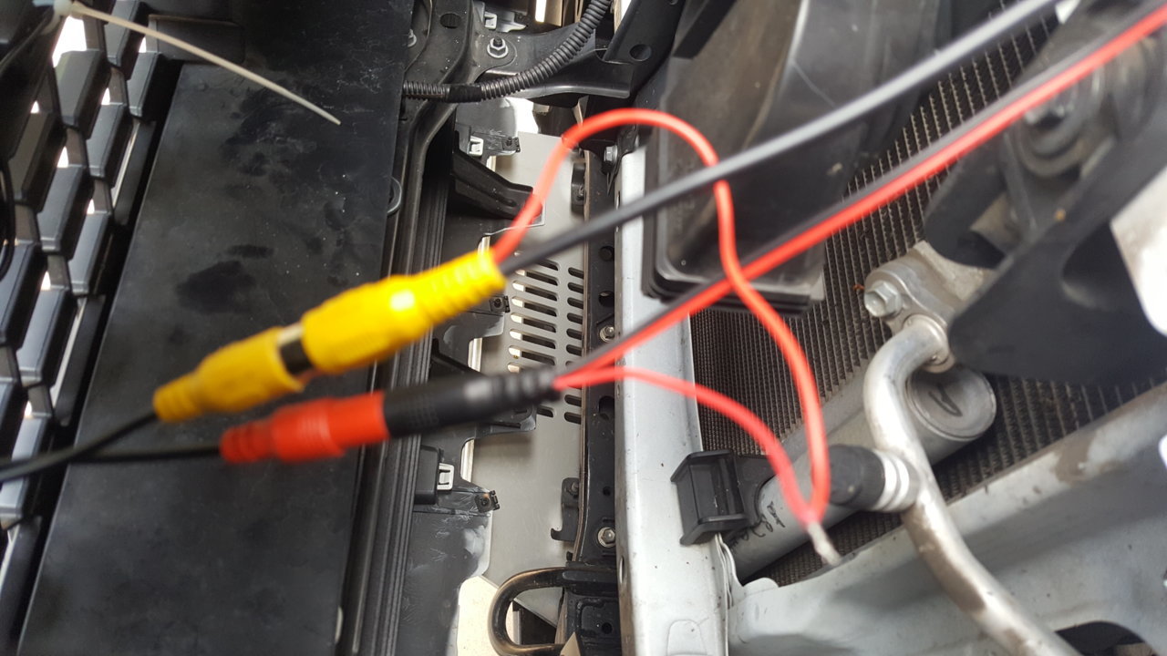

    Installed Car Solutions 2 (CS) unit with no issues. To power the front camera, I connect the 12v + wire from the CS harness to the red wire integrated into the video feed cable supplied with NATIKA camera kit.
    On the camera end of the video cable, I cut the paired red/black wires and connected the single red wire to the camera power input - all worked as designed.
    To prevent rattles, I wrapped the car solutions module in 1/4 inch foam and stuffed in a small void on the driver's side of the radio.
    Bottom line: Easy install with no additional switch required or separate camera power source.
