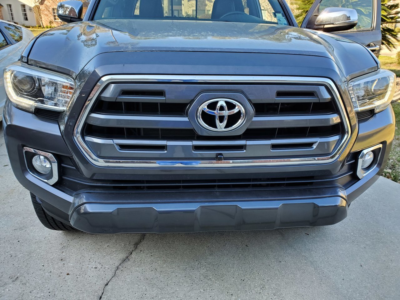

    The hardest part is finding the "perfect" location for your camera, so it shows as much of your front bumper (and what's directly in front of it) as possible.

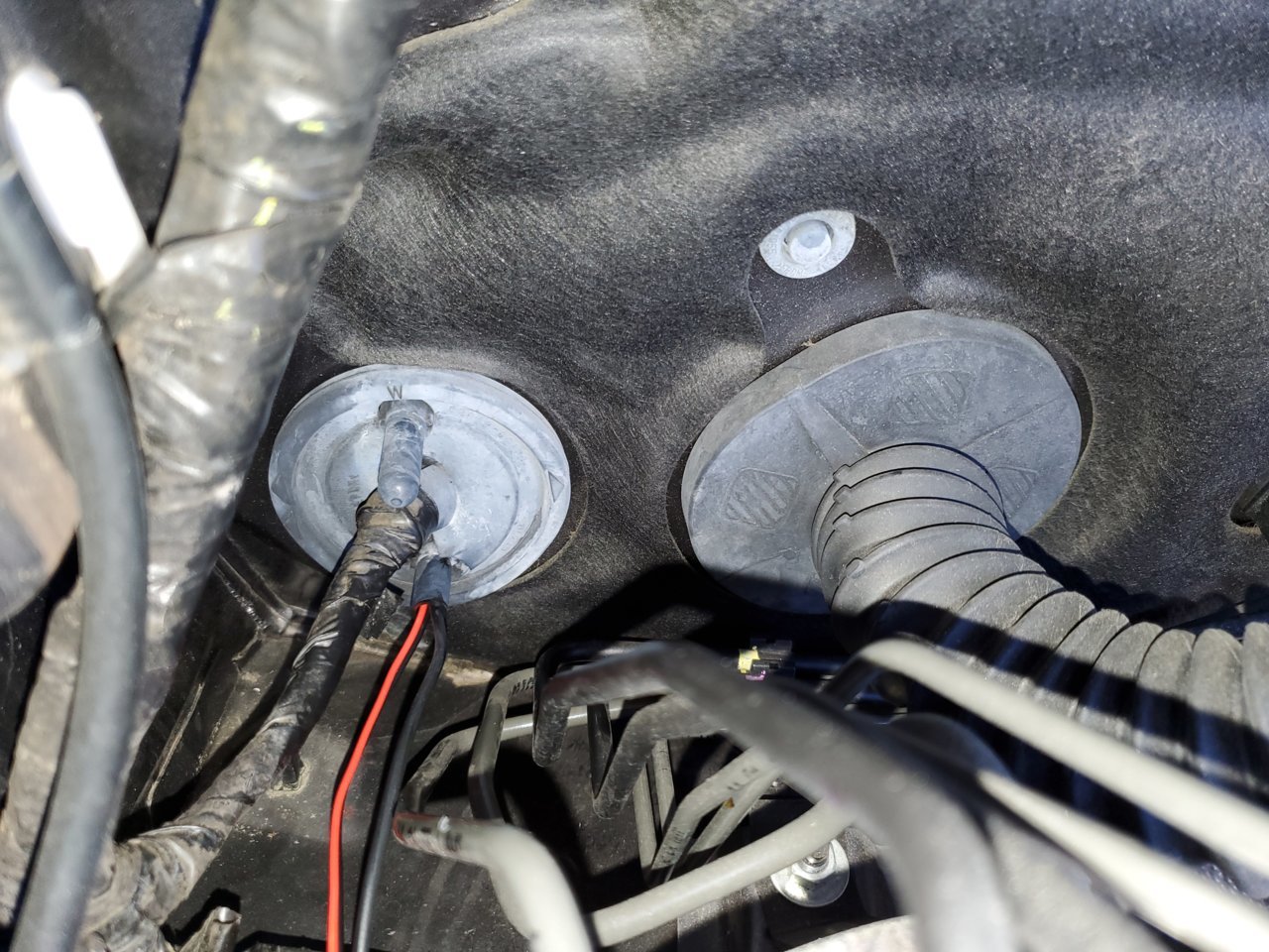

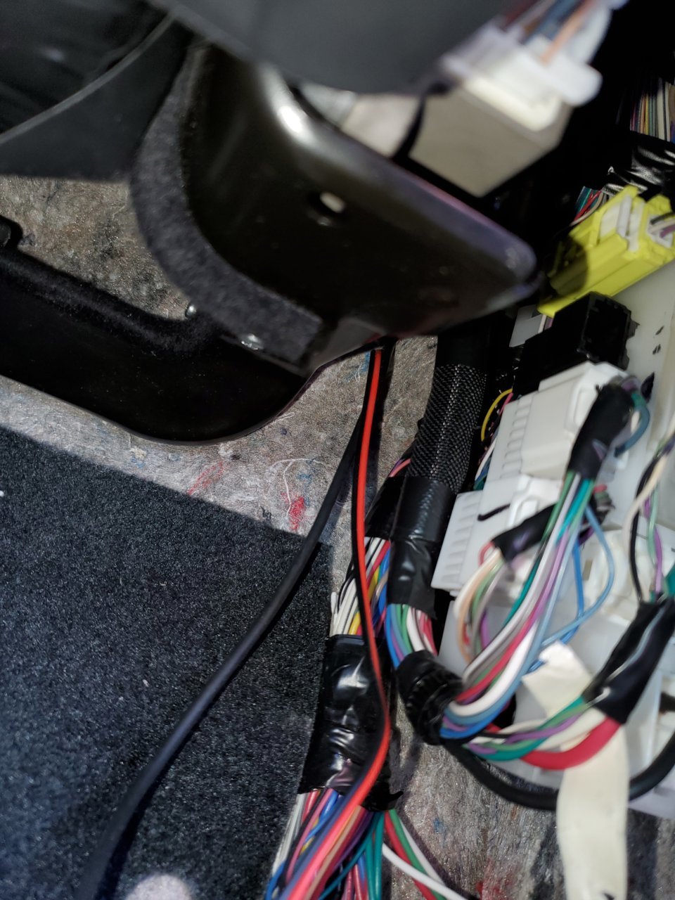

    Aside from that, getting the wiring through the firewall was pretty tough. I chose not to push/pull the RCA connector through the firewall grommet.
    The RCA connector appeared to me that it was larger diameter (fatter) than the Natika 4-pin connector and the molded plastic "junction box" in the Natika cable.
    I pushed a piece of a coat hanger from the engine compartment into the cabin. Then I stuffed the end of the Natika 4-pin connector into the biggest/fattest plastic straw the I could find, then secured it with tape.
    I attached the other end of the big fat straw to the coat hanger. I lubed up the straw with Magic Lube that I use for my swimming pool pump/filter.
    Then I had my wife provide (mostly moral) support from inside the cabin while I pulled on the coat hanger from under the hood.
    After gently, slowly, and steadily pulling, the 4-pin connector came through. Then I lubed up the molded "junction box" part and eased it through, pulling gently and steadily.
    I immediately plugged it into the camera and was relieved to find that it still worked. :broccoli:
    Under hood, passenger side (I later covered all this with split-loom tubing)
    Inside Cab, passenger side

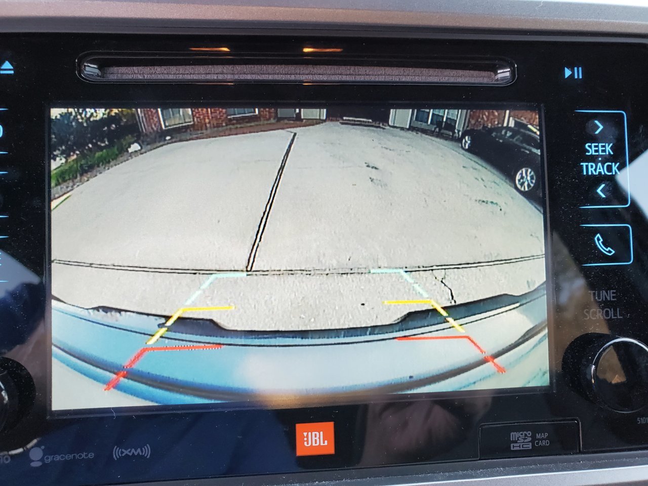

    I have the stock 2017 Limited grille so I didn't have much choice of where to put the camera, since I wanted to keep it perfectly centered.
    This is the view, although after this pic was taken I installed one of the Natika shims to angle the camera slightly more upward/outward.

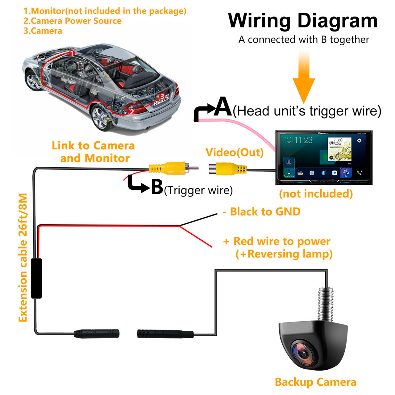

    This is the wiring diagram provided by Natika for the WD-011 which I have. This diagram shows the 4-pin connector and the "molded junction box" that I referred to.

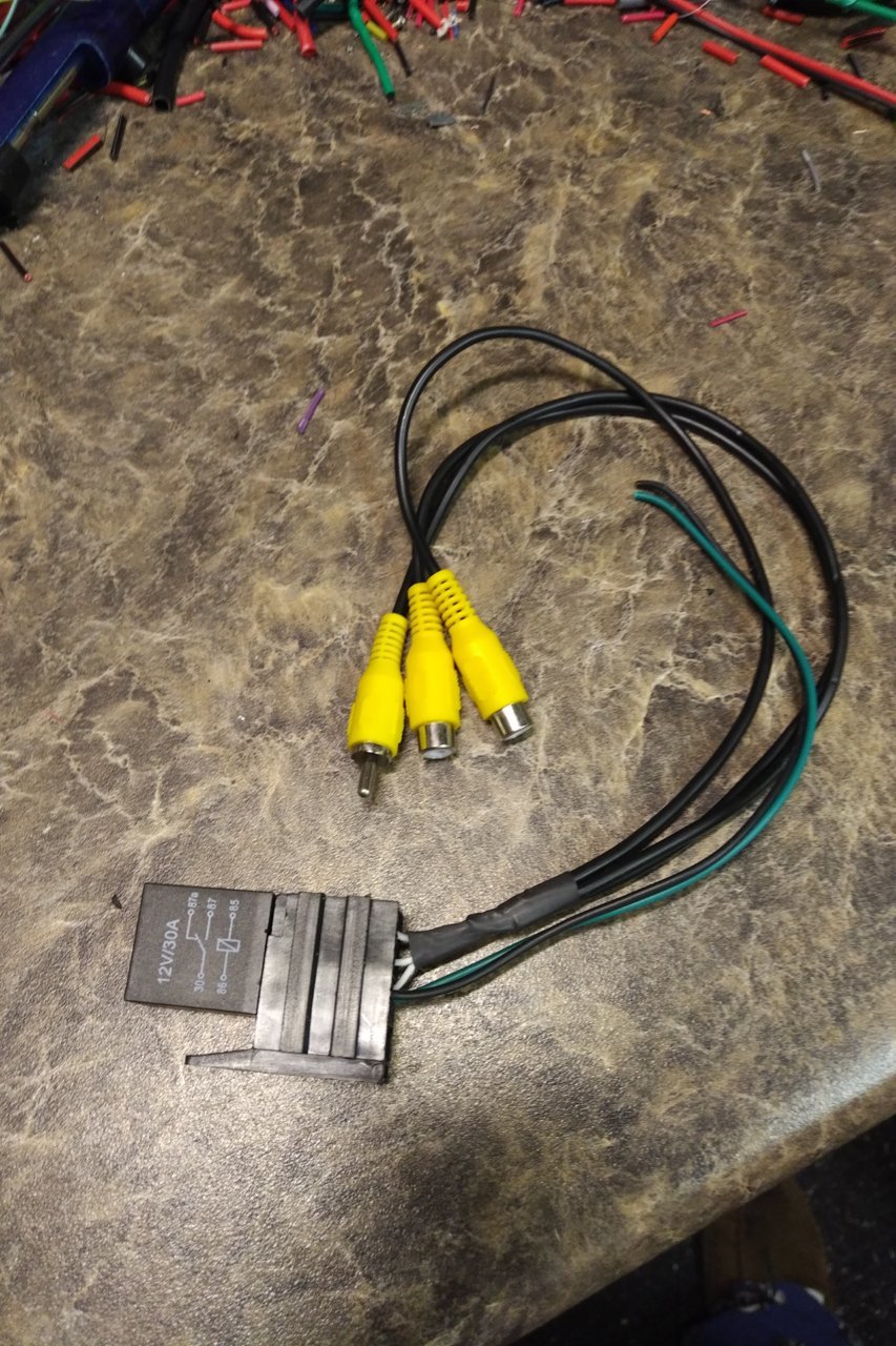

    The anytimebackupcamera.com site I think will sell the relay wire harness separately. Or you could build yourself. I can send you a pic of the relay.

    This is the pic of the relay that you can connect to the MESO modified shift knob.

    You need the basic relay like I posted above from anytimebackupcamera.com or you can build one yourself.
