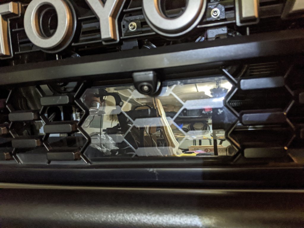

    Good deal that they have a new kit for the 20-21's! I was gonna suggest to give em a call but they are a Hong Kong phone number
    What camera are you gonna use? I have the TOPTIERPRO from Amazon & works great with the kit

    I am thinking about using the commonly referenced Natika based on generally good feedback, but it doesn't look optimal for mounting - round bodies may be easier to munt in grill, not sure - I'll check the toptierpro out too.

    Did you have to drill into the Pro grill to fit the camera? or mount it some other way?

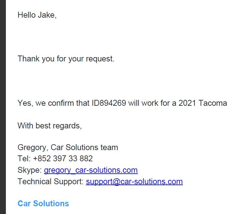

    In early march 2021 I ordered the Car-Solutions / Germes Labs camera adapter for my yet to be delivered 2021 ORAC. Specifically I ordered and received: RFCC Car Camera Control System for Toyota Touch 2 CT17-19 / Entune 3.0 (Product ID: 894269) – having been told this was the right one for my inbound truck.
    Upon examining product I noticed they went to the trouble of enabling firmware upgrade functionality. As my truck is scheduled to arrive in a week or two I contacted car-solutions tech support to inquire if firmware updates had been released for the unit I ordered back in early March 2021. Apparently there have, sort of – see email chain below – they inquired if I had touch lock system which if I understand their question I do in TRD OR .. Anyway, not sure if I should install firmware update or not prior to receiving truck and installing front camera / adapter.
    Wondering if anyone else has updated firmware, or knows reasons for update (or roll-back). Firmware provided for update has “old” in directory name, which is odd. Comments / insight welcomed as I seek more info from car-solutions.
    Email chain, mine in italics:
    To: support@car-solutions.com
    Subject: product ID: 894269
    Hi, I purchased product ID: 894269 RFCC Car Camera Control System for Toyota Touch 2 CY17-19 / Entune 3 a few months ago and have not yet installed. I notice you went to some trouble to enable firmware upgrades with this product, so I am just wondering if there have been firmware updates since my purchase that I should get after prior to install next month -thanks.
    Subject: RE: product ID: 894269
    Hello.
    Is your car equipped with the touch lock system? If so, please provide a clear picture of the sticker on the adapter.
    With best regards,
    Yuriy Demchenko Technical Support Department
    Yes, my 2021 TRD Off Road has touch lock system. Pictures of adapter labels appear below, ty.
    RE: RE: product ID: 894269
    Hello. How to udapte:
    1. Disconnect the RFCC adapter.
    2. Switch the 6th DIP to the ON position.
    3. Connect the RFCC adapter to PC by microUSB cable.
    4. RFCC will be seen as a flash memory. Extract the "firmware.bin" file from the archive and copy it to the root of the RFCC flash. When asked whether to replace the file, confirm.
    5. After copying, disconnect the RFCC from PC, turn the 6th DIP to the OFF position and then connect back to the car.
    Please inform me about the result. (attachment: firmware_old.zip)
    Update: recently provided firmware works fine, installled today and works as advertised. Used tacogarage mount on an OR grill with Nakita cam, surprisingly had to cut purple wire as image initially upside down - solid mod.
