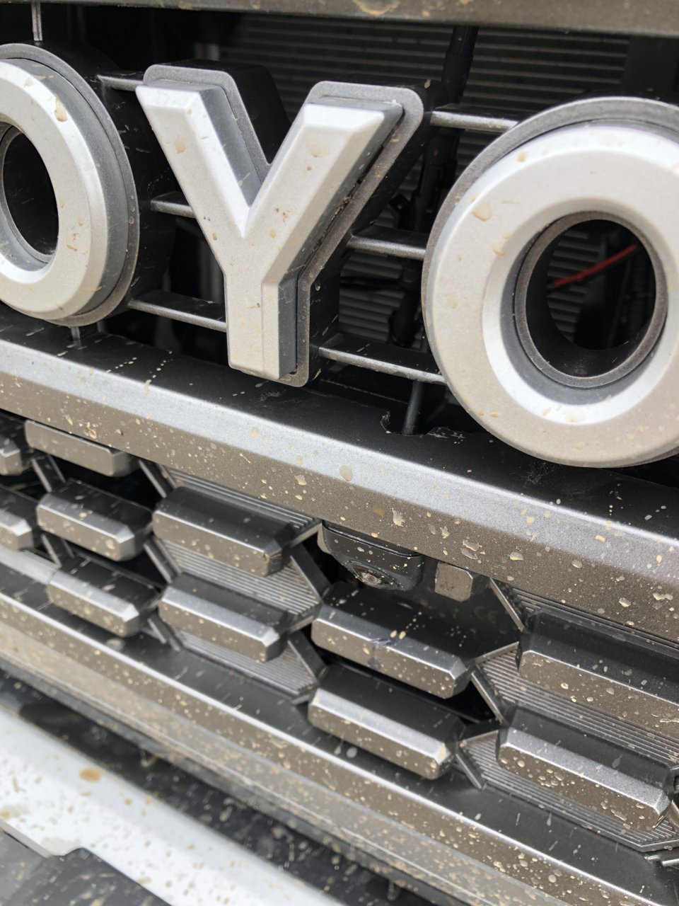

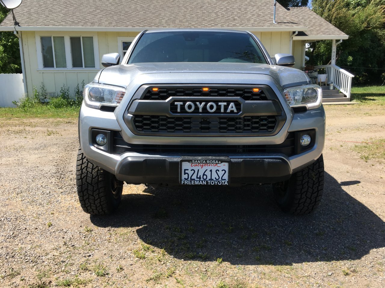

    I had replaced the original grill with on an OEM Pro grill.

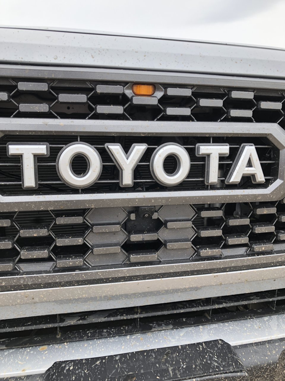

    I just installed this exact setup, same camera. Works awesome, I didn't see his video until after but I appreciate the post. I love how it looks factory, no extra buttons to install. It works flawlessly using the mode/ up/ down buttons on the steering wheel. If you hold the up button on either camera the camera will stay on the screen until you exit out by hitting mode again.
    I installed my camera dead center of my fake pro grill and it was a pain in the ass, I had to notch the garnish cover. Turned out super clean and the view is dead center of my truck which I wanted.
