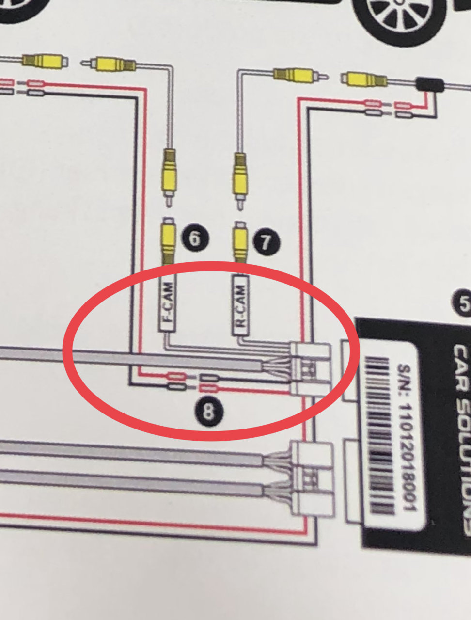

    I'm not going to pretend I'm the expert on this, but after installing my own, I only saw two input locations. One for the front cam and one for the backup cam. I think the only way of doing this would be to re-purpose one of the inputs for your dog cam or use a separate system for the dog cam.

    I just received mine in the mail few minutes ago and noticed this as well and didn't hear anyone else chime-in about it which is a pretty major flaw in their installation booklet.

    Didn’t notice that as I was looking at the wires from the harness labeled front camera + 12v and front camera - 12v. Who reads instructions these days?

    Post #59 mentioned the error.

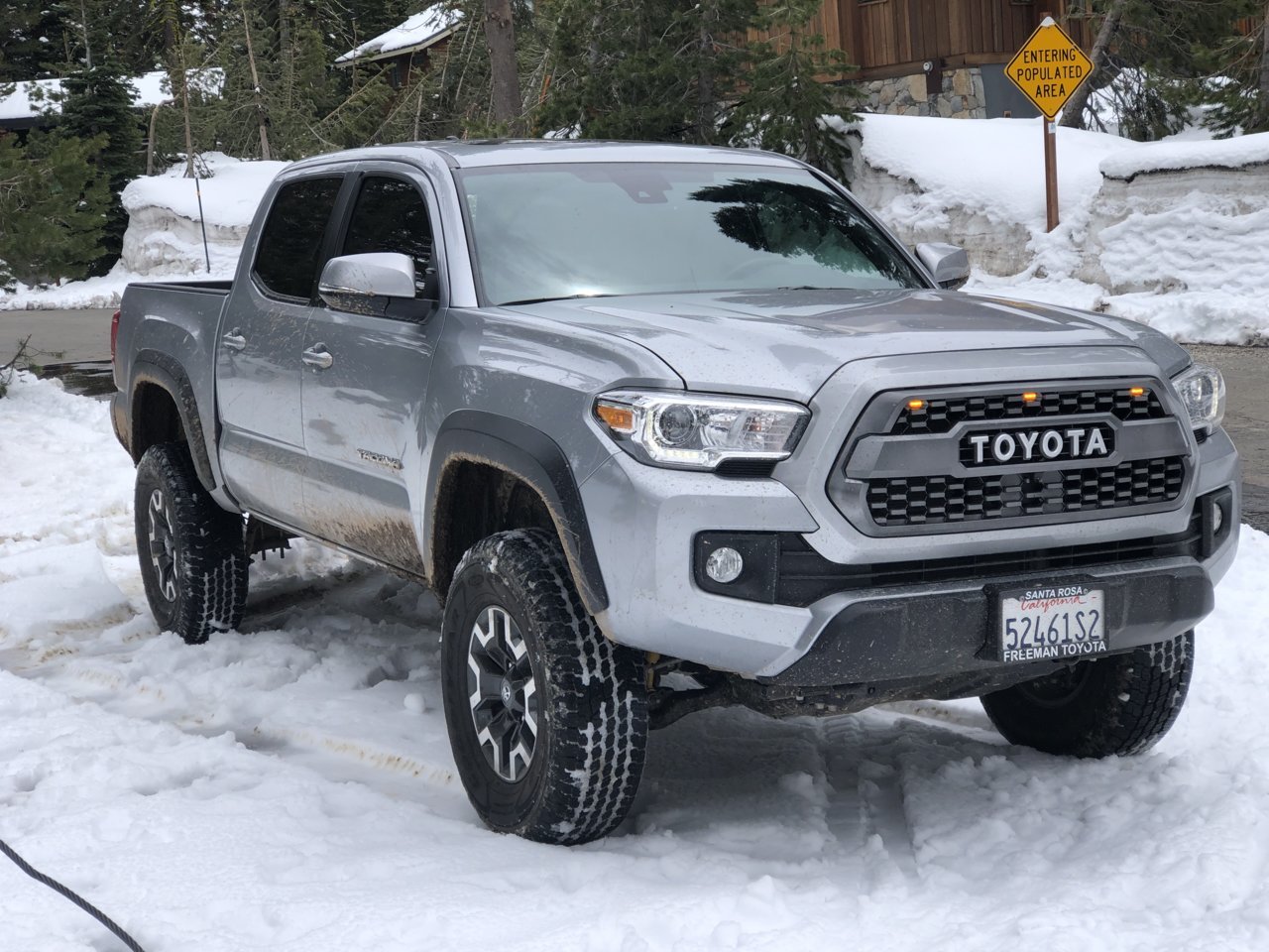

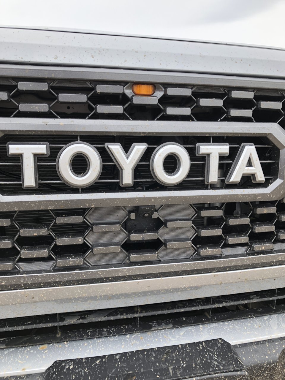

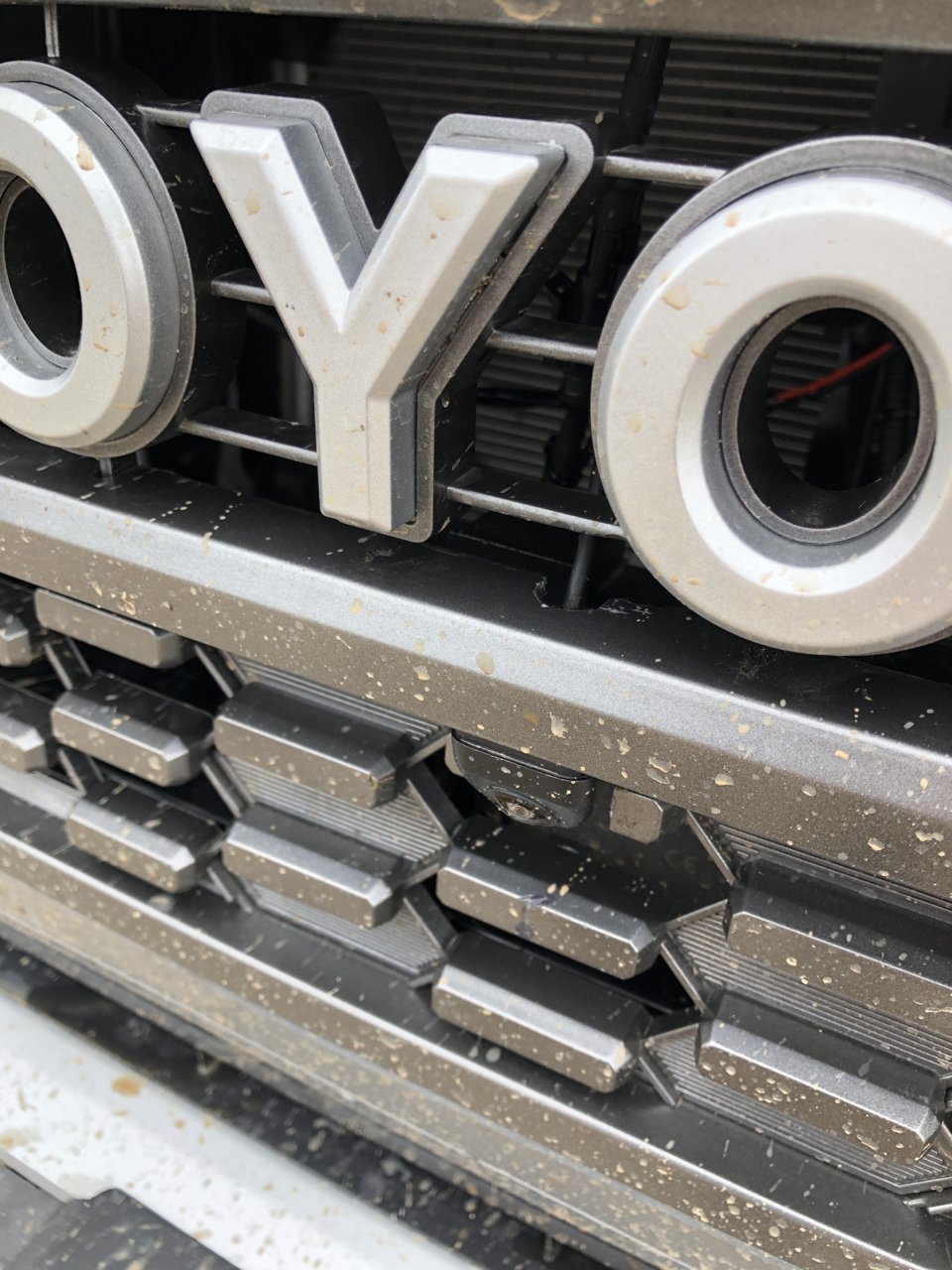

    eBay 7 days for me too straight from Hong Kong, but I live in Cali and close to the shipping ports. Ordered the camera on Amazon prime, 2 days of course.
    Pics of my installation, I wanted to go dead nuts center of the truck. Worked out good, I had to Notch my eBay pro grille. No problems with my tss either.
