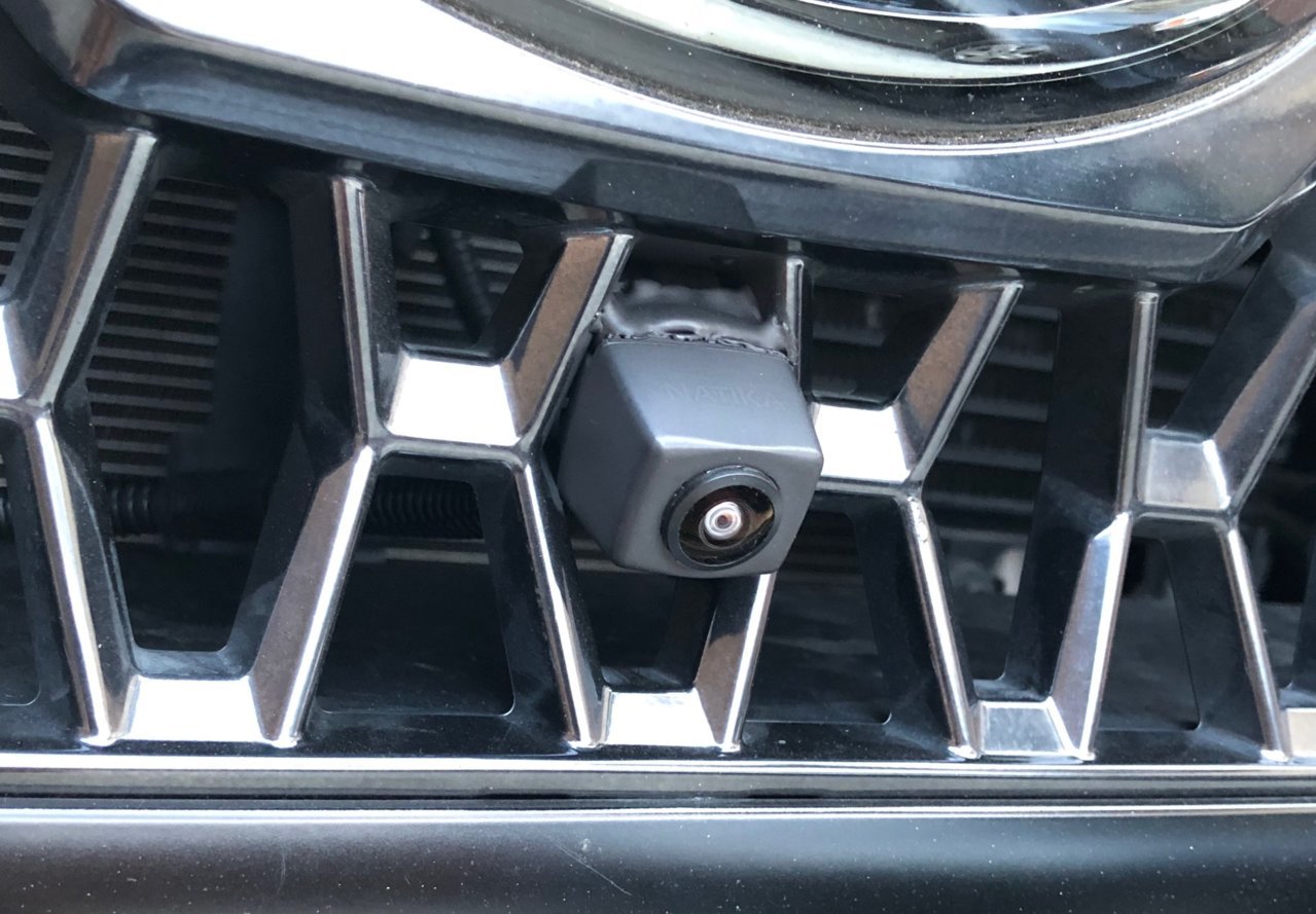

    Anyone install a front camera with the trd off road grill?
  5. Jun 21, 2019 at 8:05 PM
    #85
    payrow
    payrow Well-Known Member
    Aug 8, 2009
    #20858
    500
    Los Santos
    '18 DCSB Sport

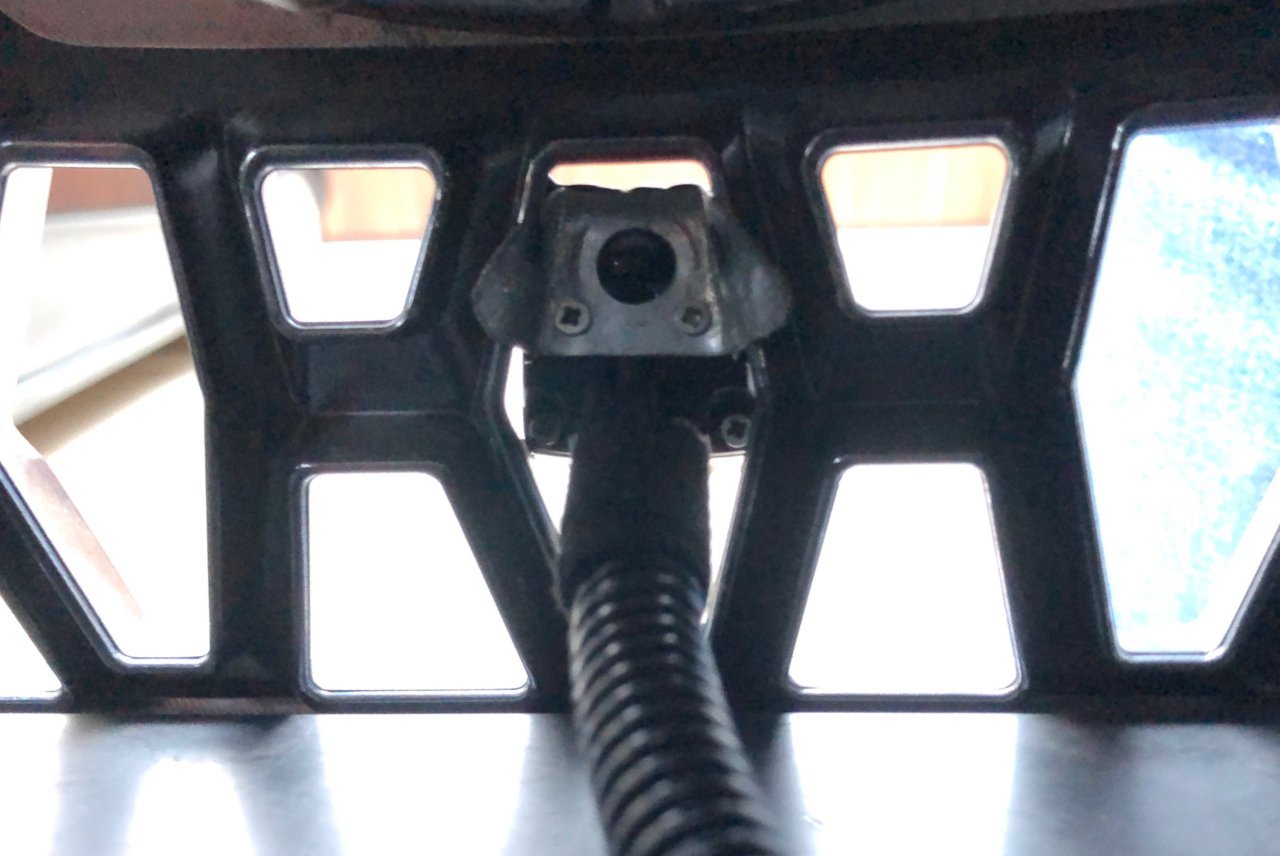

    I installed the square shaped Natika like this. Used a piece of metal on the back. I used the two stock screw locations that the camera has on the back. Bent the sides over to hold it into the grill. Then I melted some black hot glue in the void at the top. It's very solidly attached and gives me the angle I wanted. Use it to make parking a breeze. I hated trying to park in some spots not being able to tell how much room I had.
    BTW you may be able to use/modify the bracket that comes with the Natika - I didn't try - just crossed my mind o_O
    IMG-1495.jpg That's a piece of that metal/galvanized (plumber) stuff that comes in a roll.

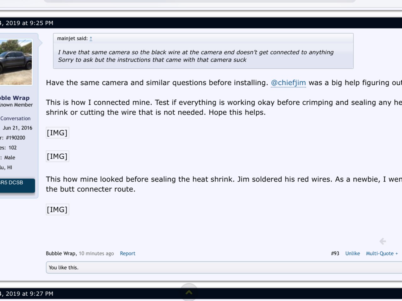

    Your pictures didn’t show up

    Do they now? I was editing my post.

    8DAA8441-5C8C-4342-9981-ECEF7931BADF.jpg Nope
    This is what I see

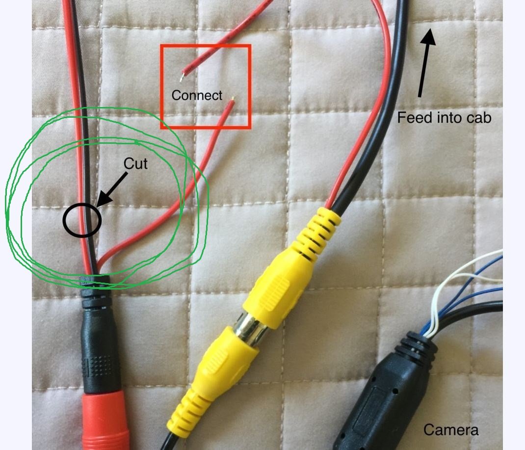

    *Just a quick heads up - may not be very obvious.
    The wires circled in green have to be isolated otherwise you will create a short. The black wire is common ground in the circuit and the red is common hot.
