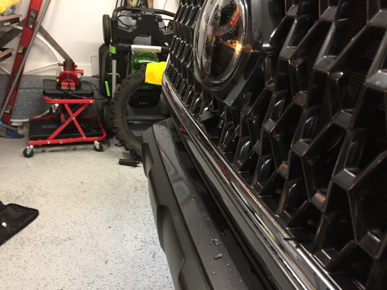

  5. Jul 4, 2019 at 4:32 PM
    #105
    mainjet
    mainjet Well-Known Member
    May 24, 2019
    #294275
    195
    Alberta
    2019 Tacoma off road
    Ray 10s Diode dynamics Hidden Light bar Toyo AT2s

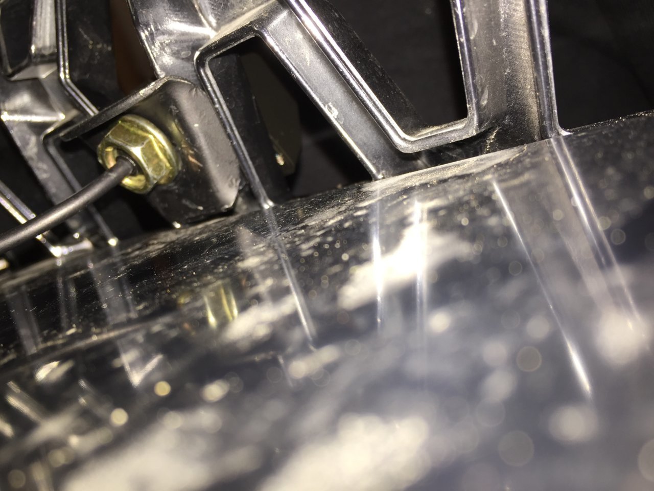

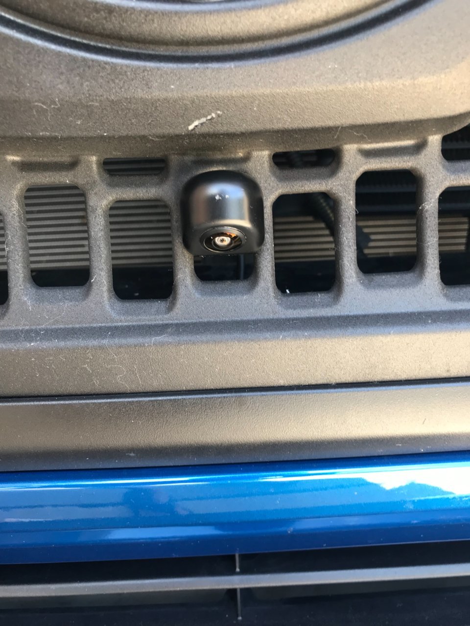

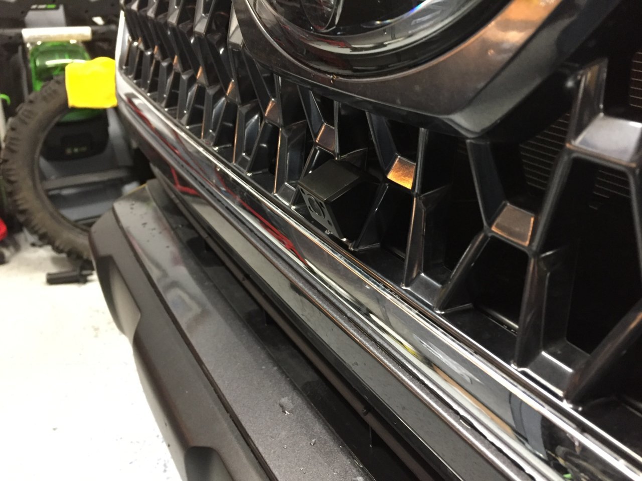

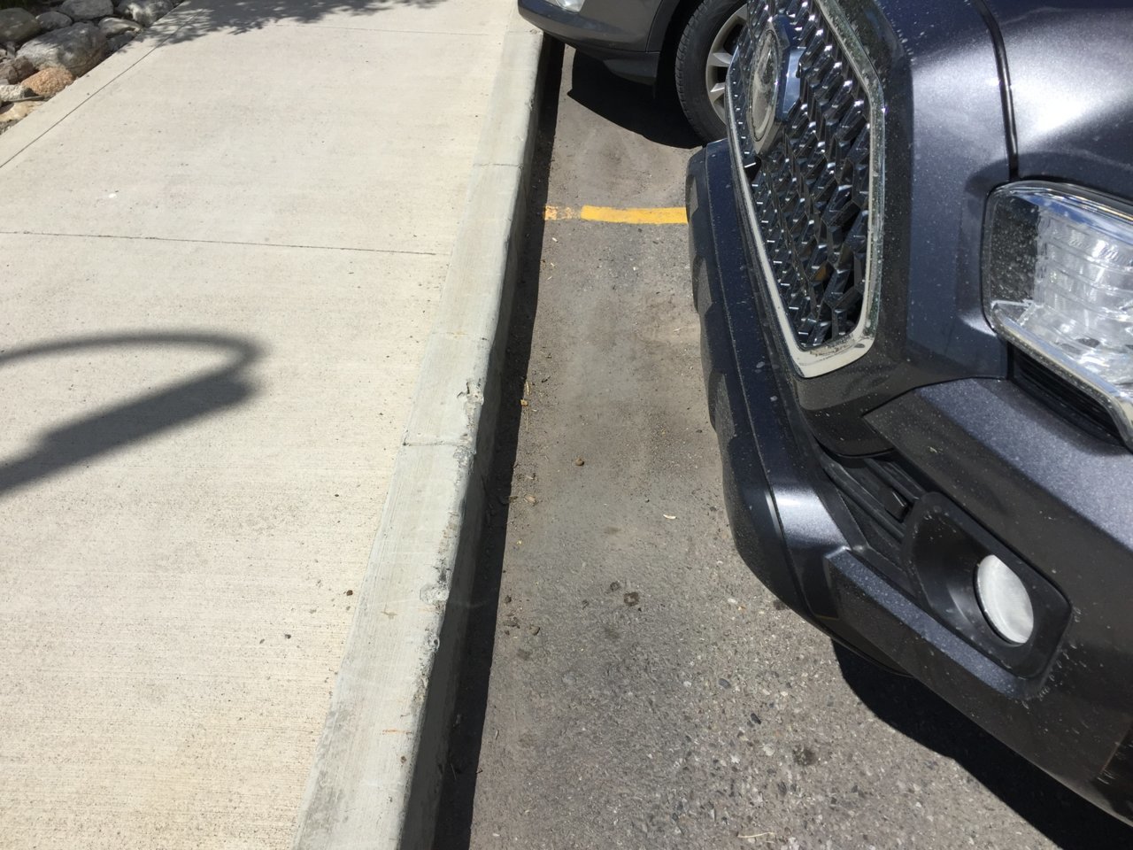

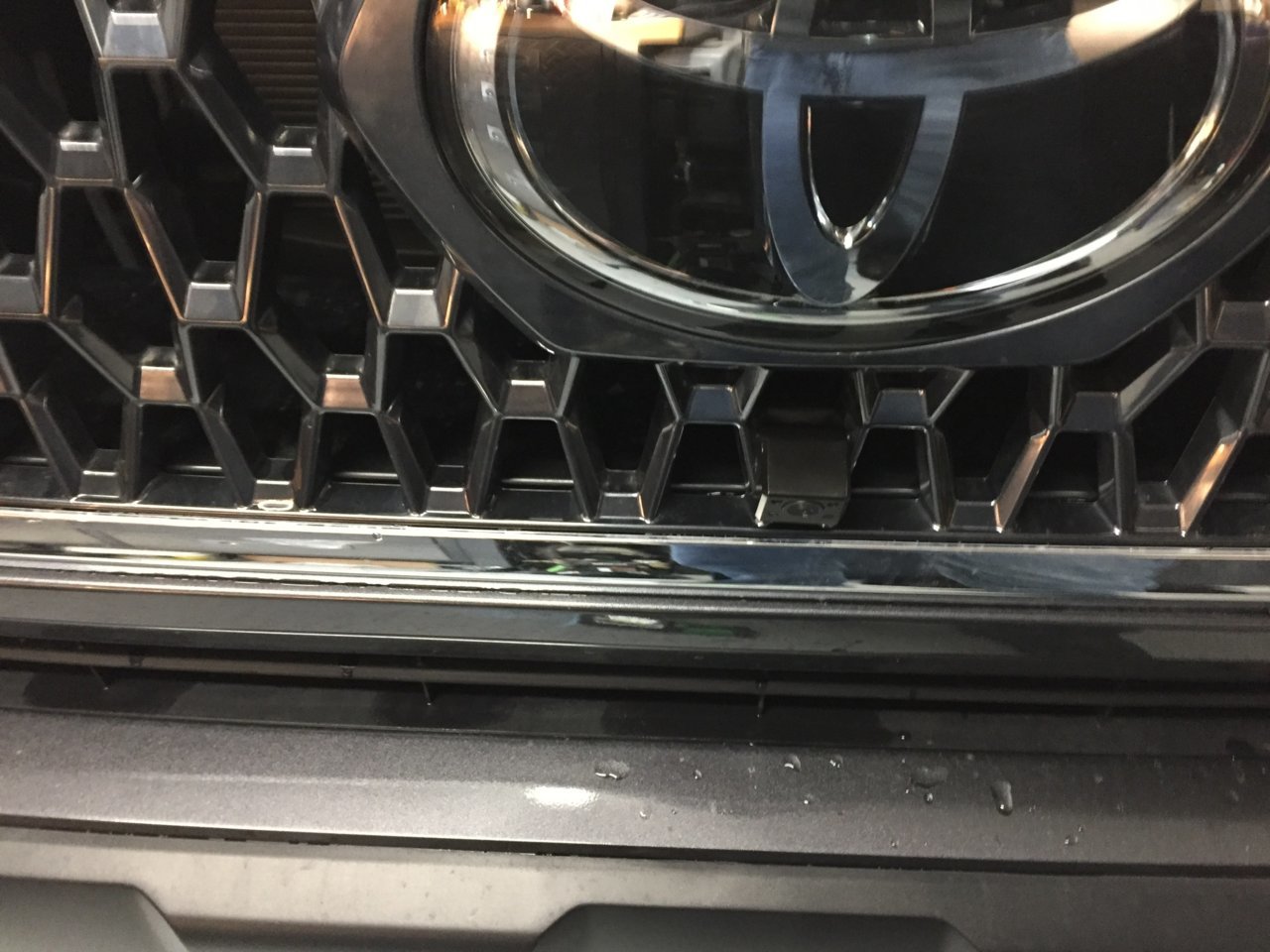

    32BA2B06-60A9-4635-85FC-D1FC20B0C255.jpg FA870FC5-6B05-441D-B146-75287EA55465.jpg 896D7332-95DA-49C1-8EB9-F8786756D17F.jpg So got it all installed today I think it looks pretty good
  6. Jul 4, 2019 at 7:14 PM
    #106
    shootsright
    shootsright Well-Known Member
    Nov 17, 2018
    #272987
    87
    2019 TRD Offroad
    None yet, chomping at the bit for the first one.
    Would dig seeing the backside mount.
    mainjet[QUOTED] likes this.

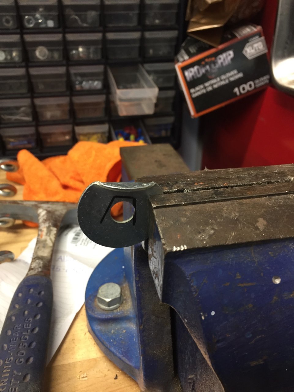

  8. Jul 4, 2019 at 7:55 PM
    #108
    mainjet
    May 24, 2019
    #294275
    195
    Alberta

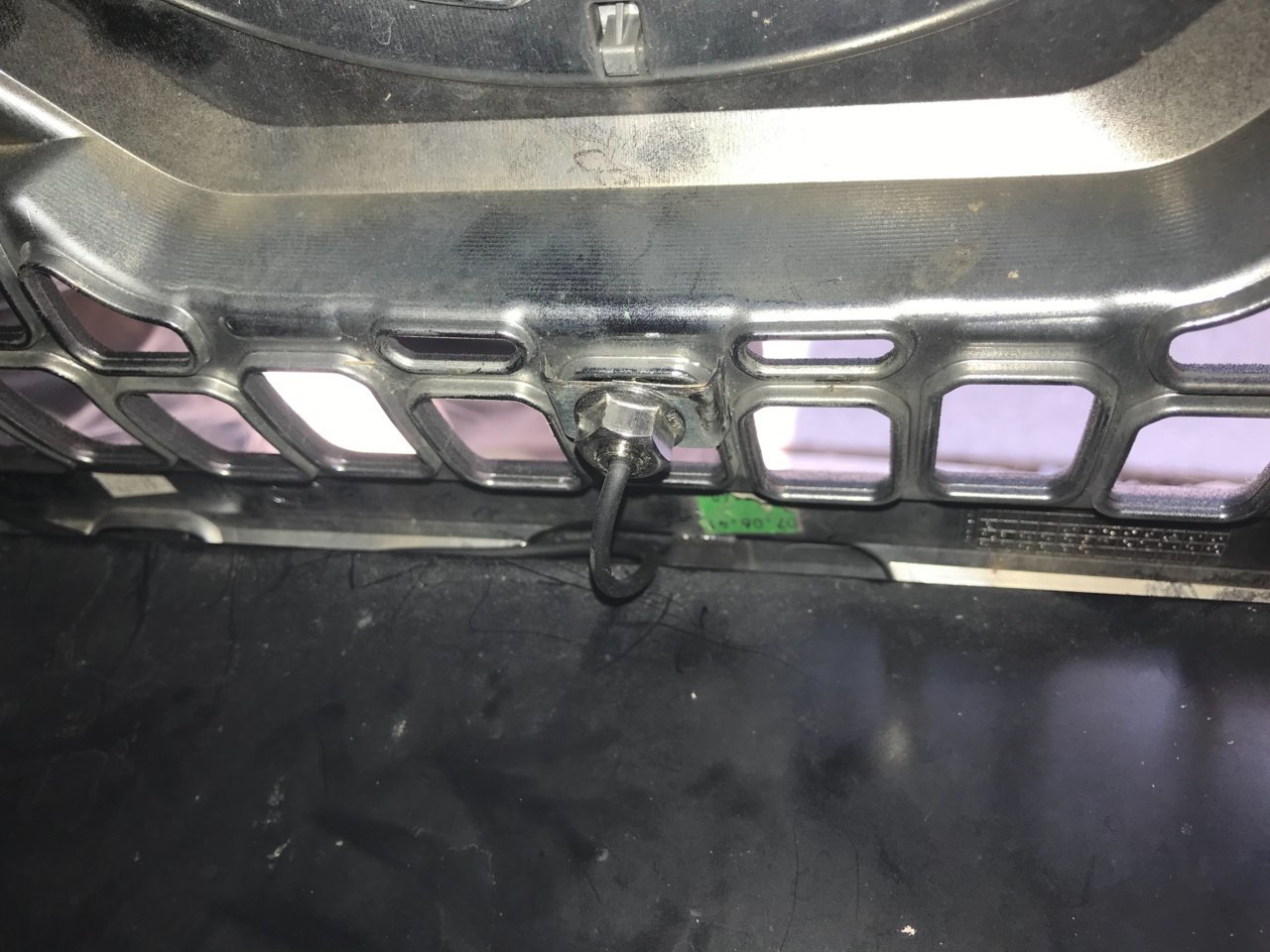

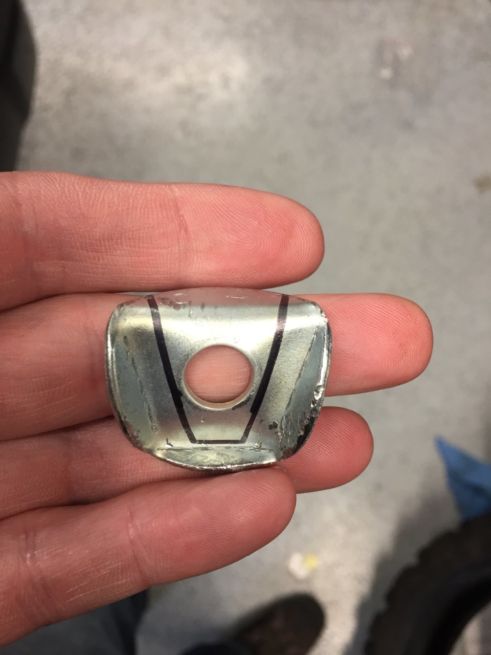

    [/ATTACH]

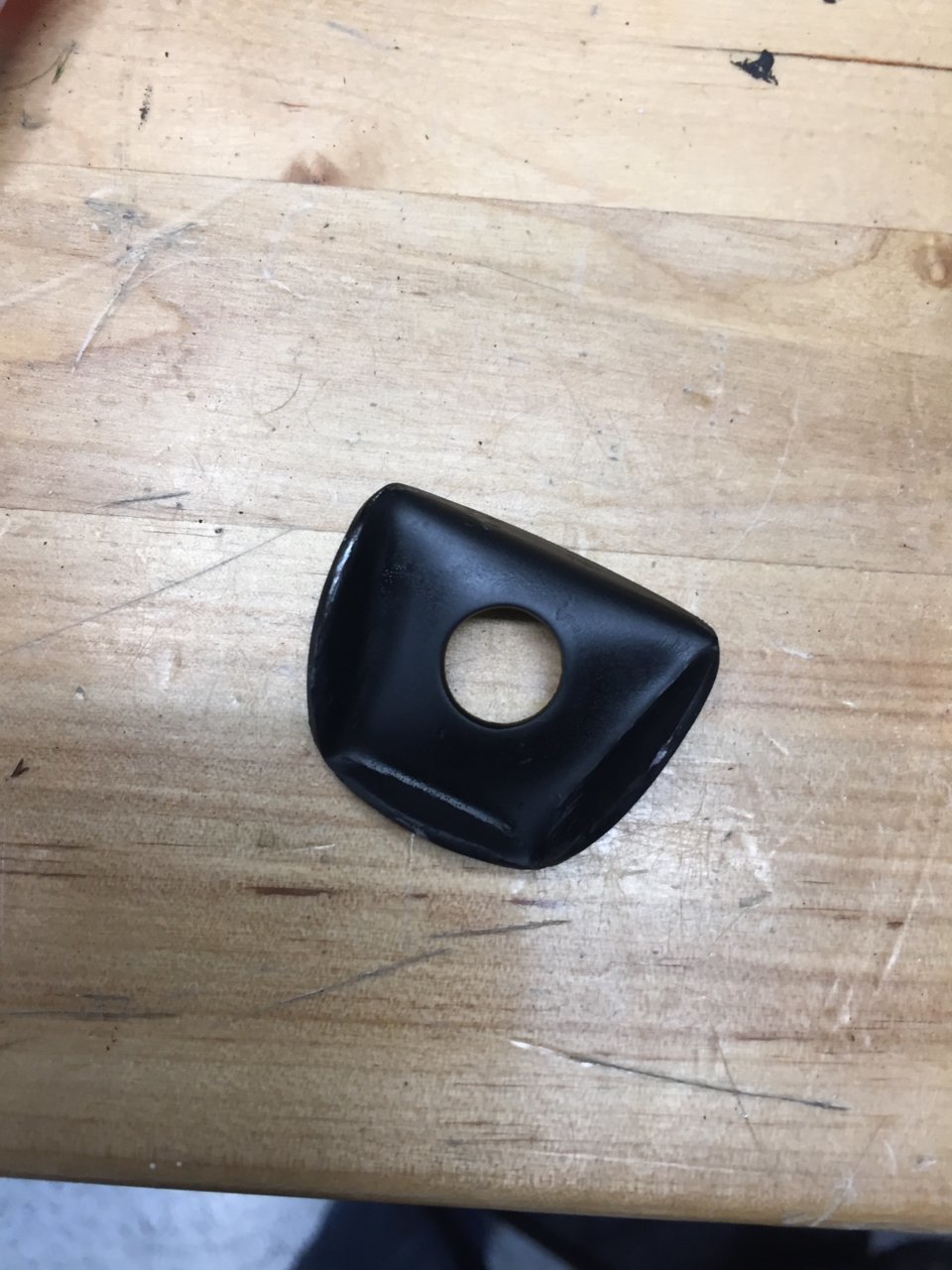

    Took a washer (well 3 before I got it right) and bent it in a vice.
    mtip, C41n, CraigF and 10 others like this.
  9. Jul 10, 2019 at 7:43 PM
    #109
    tlkraus1965
    tlkraus1965 Member
    Jun 12, 2019
    #296181
    6
    Tim
    2017 TRD Sport
    I used a small portion of bracket material used to hang garage door openers with. Strong but still easy enough to bend. Worked perfect. Thanks for sharing your idea!
    mainjet likes this.

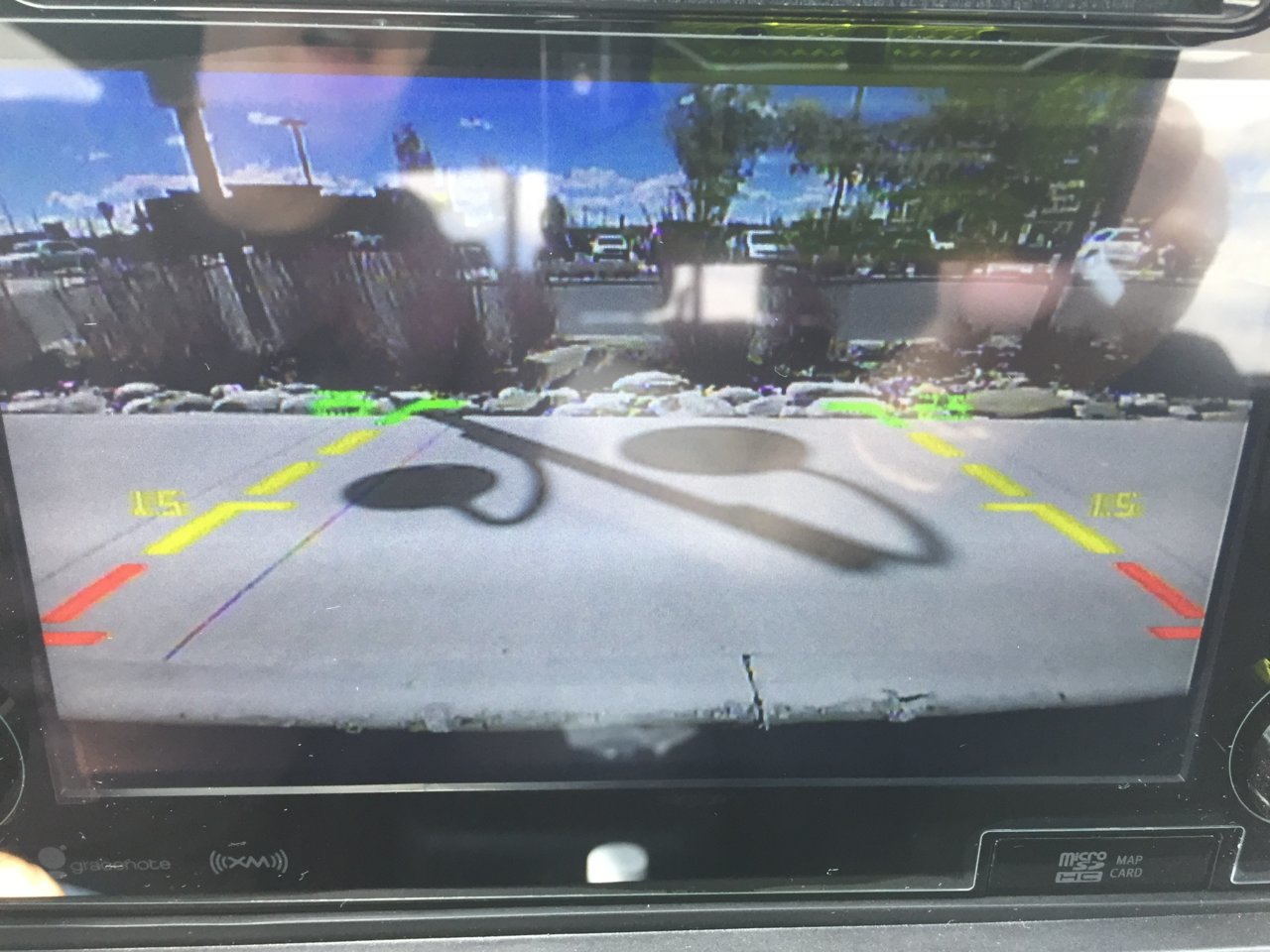

    Los Santos
    '18 DCSB Sport

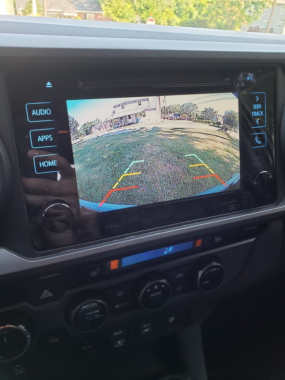

    Can you post a pic of the view through the head unit for the front cam? Thanks! :thumbsup:

  12. Jul 11, 2019 at 1:20 PM
    #112
    mainjet
    May 24, 2019
    #294275
    195
    Alberta

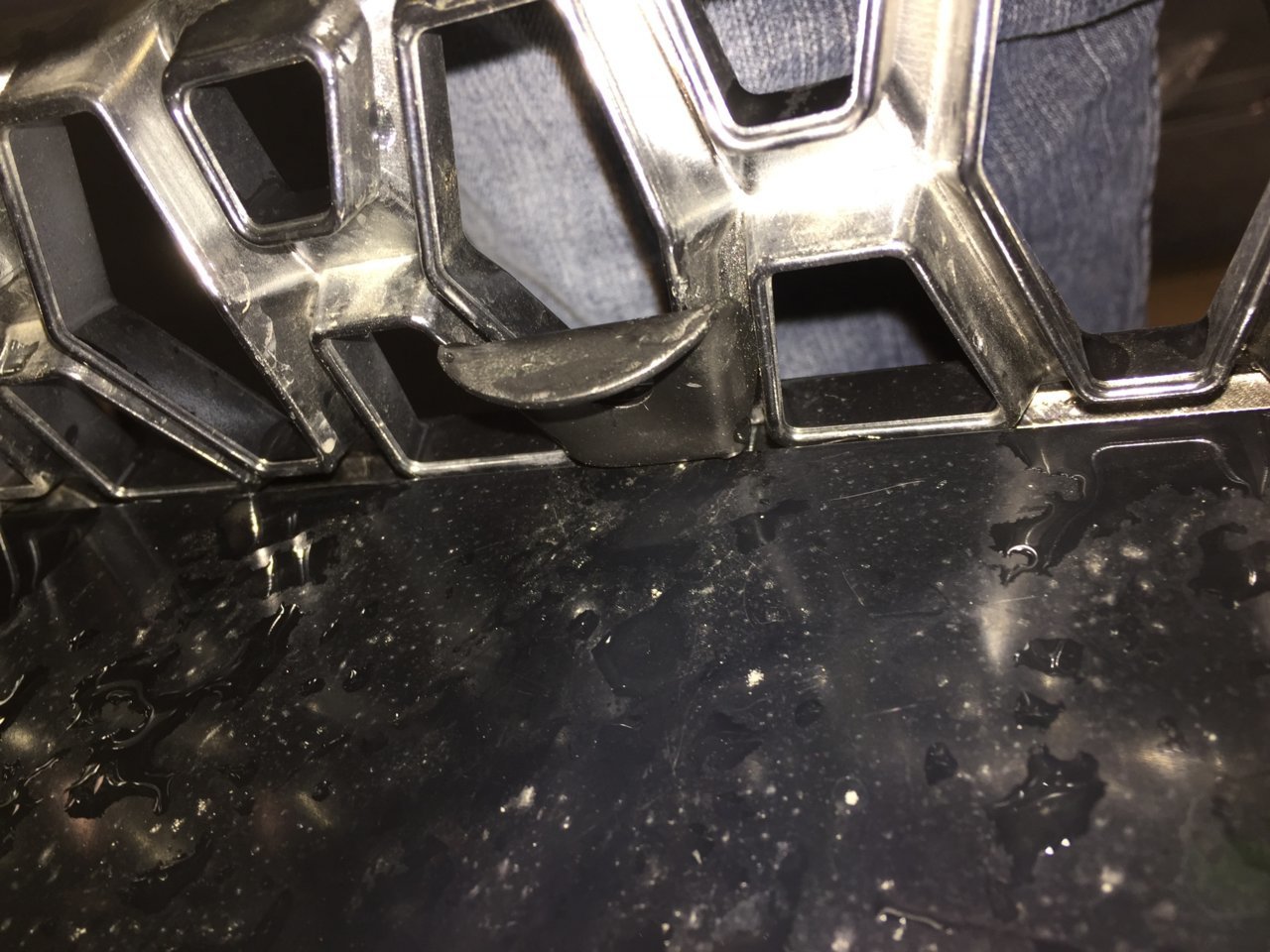

    Tim
    2017 TRD Sport
    Garage door opener hanger bracket cut down and bent to fit.

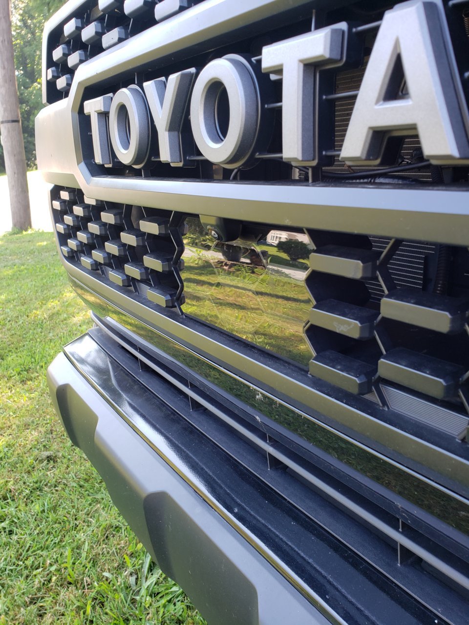

    South East PA
    2018 Black TRD Off Road DCSB MT
    Just finished doing this mod and its a pretty Sweet set up, love that there are no extra buttons or splices into any wiring, hardest part is running the front camera cable into the cab. :thumbsup::cheers:
