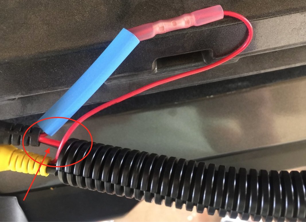

    Yes, with that particular camera the black/red wire are not needed. Whether you cut them or not is up to you. This picture shows how @chiefjim did his install. After soldering the skinny red wires together, he cut his and sealed it with heat shrink.
    Since I used a wiring loom to protect the wire further, I decided to not cut mine, just taped the ends and ran it inside the wiring loom parallel to the RCA cable without connecting it to anything.

    Don't cause problems with your install...
    It is very important you isolate the wires if you end up cutting them. If the black and red ends touch - IT IS A DIRECT SHORT. Those wires would normally be used for camera power and the extra red lead coming out of the RCA ends would be connected to the reverse lamp to trigger the head unit and allow it to switch to the camera input.
    In the case of our trucks, we do not need to use the red and black to power the camera - we back feed it through the red leg coming out of the RCA's. This is the best way to power the camera because it is only on when it's needed and not all the time.

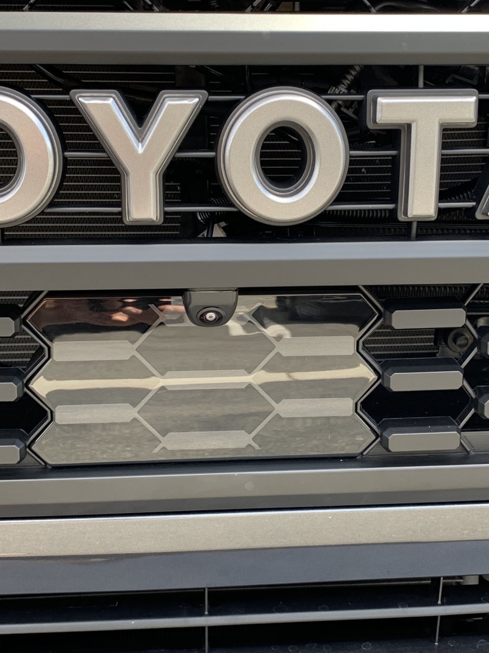

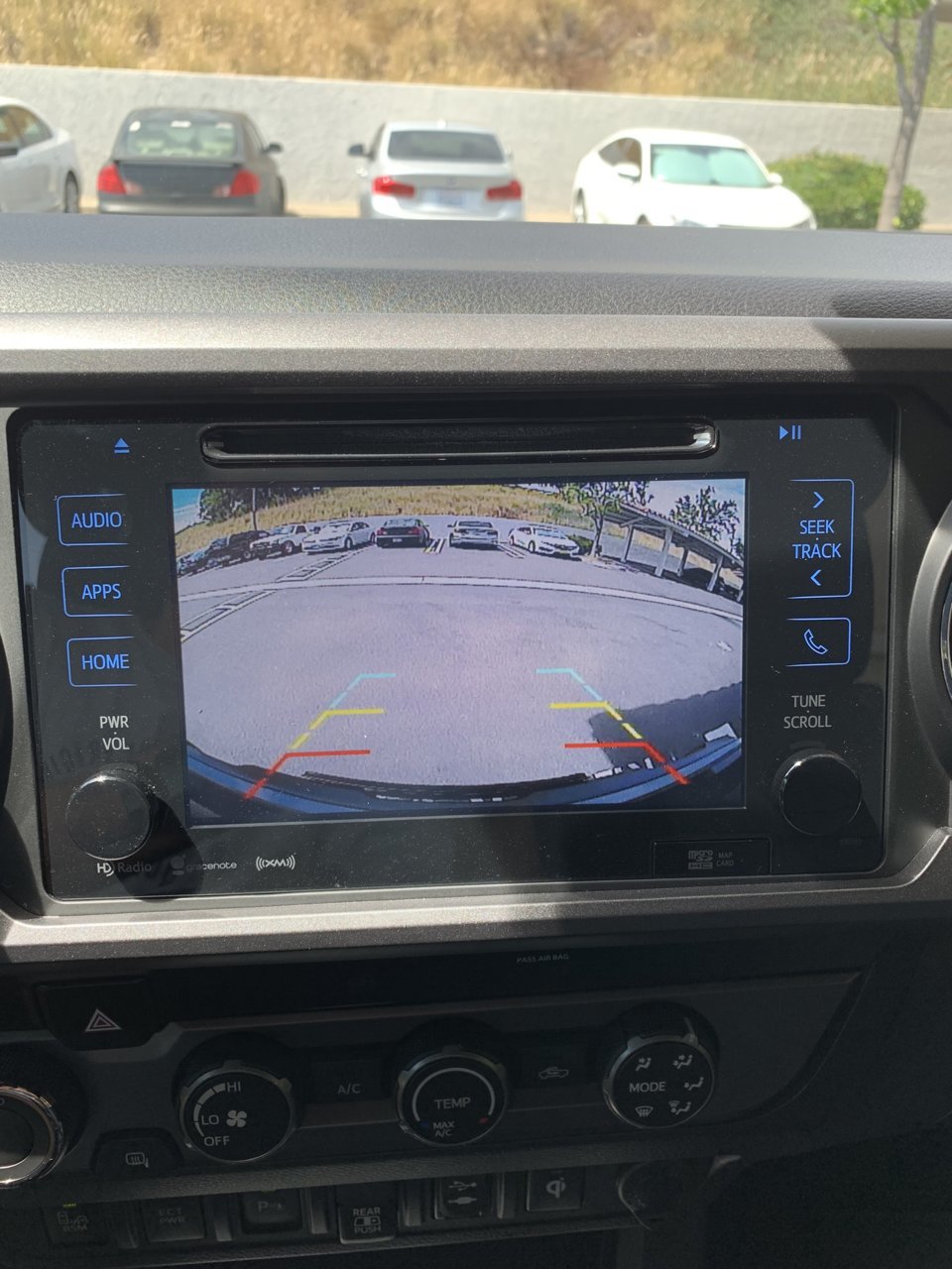

    Expedited shipping worked in this instance. Ordered on 7/31 delivered 8/2 installed 8/3. Installation was straightforward and camera operation using the steering wheel controls is awesome!. Grid line wire will be getting snipped shortly lol. Thanks for all of the information.
