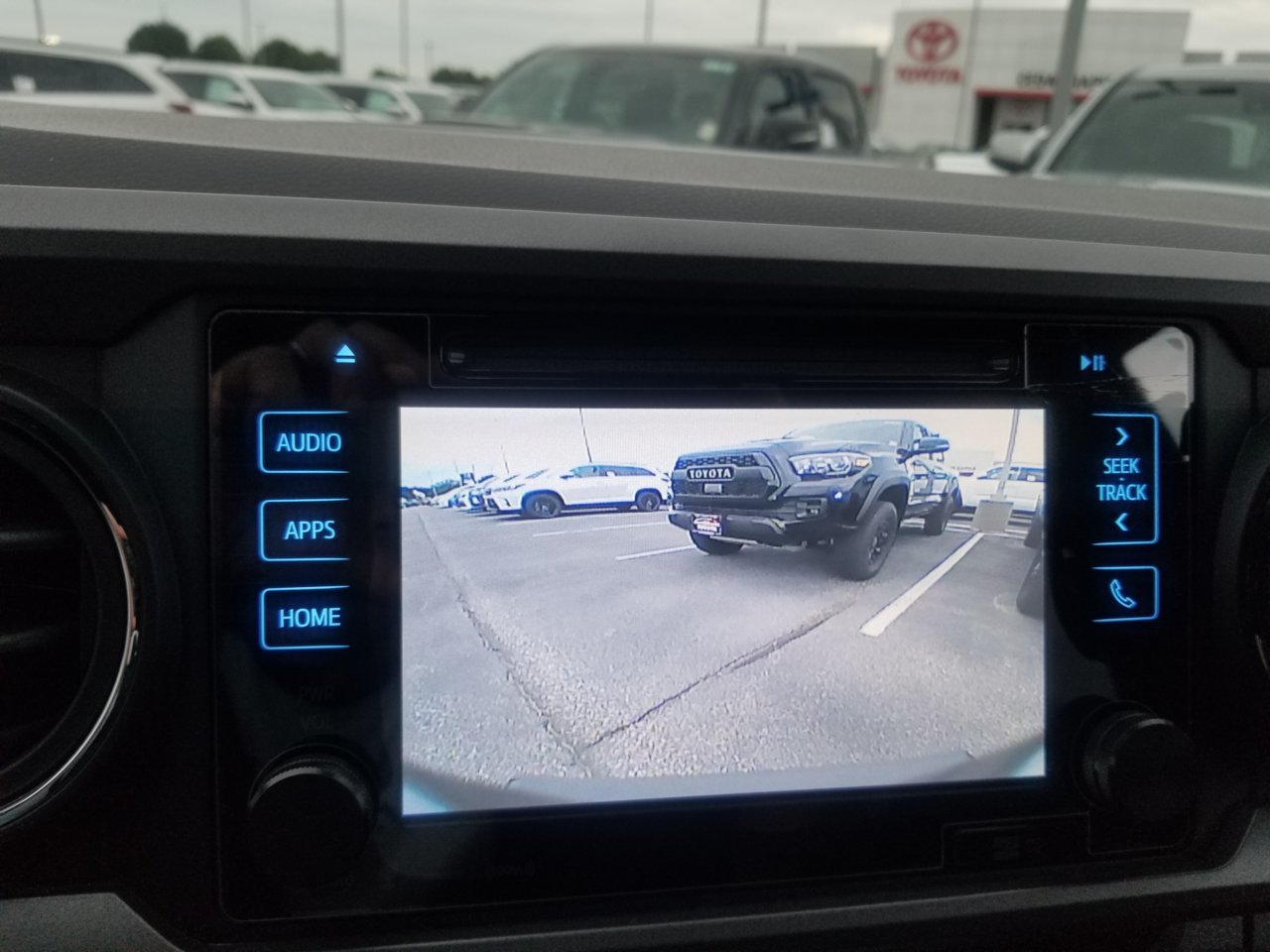

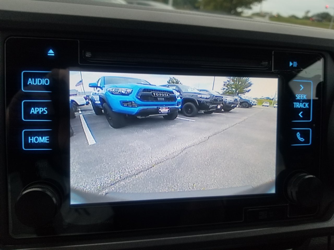

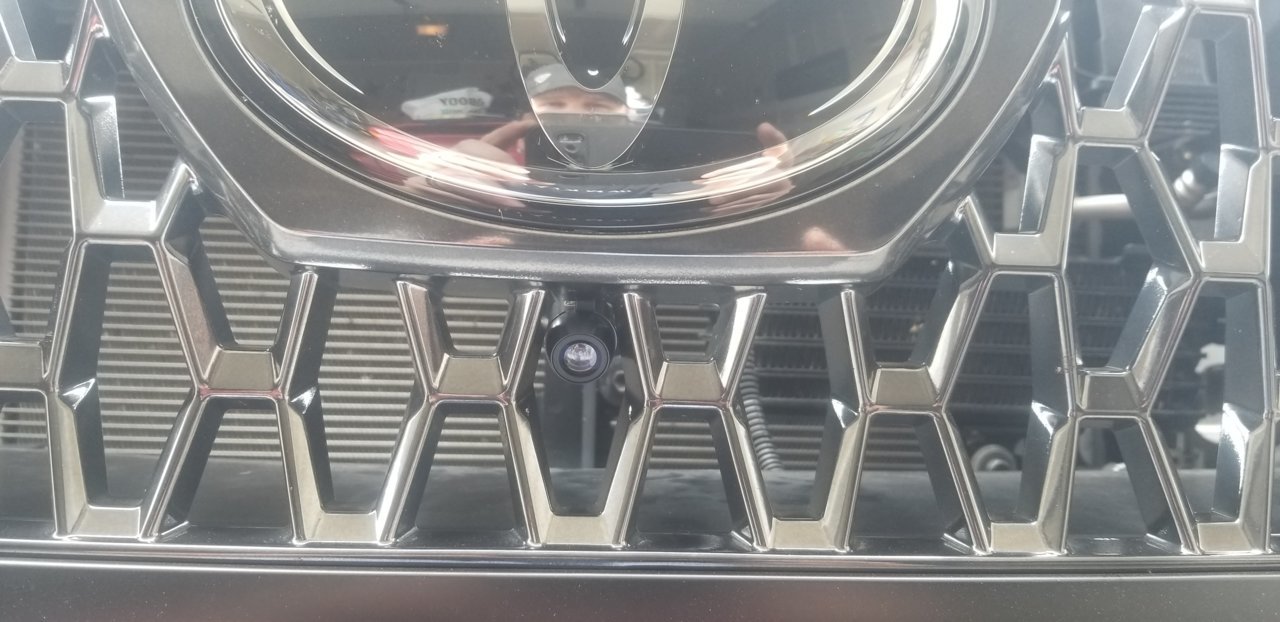

    Got the CS kit installed today & very impressive! Pretty easy install & the ability to lock onto either camera while moving is a nice feature.
    I got the TOPTIERPRO TTP-C12B camera off Amazon & mounted it under the grill badge/TSS sensor. I used the wing mount with a healthy amount of VHT 3M tape on top & bottom of mount. Seems to be holding in place very well. I've seen a few others use this camera instead of the Natika & decided I would give it a try.
    I was able to get the top of my license plate mount in the view to use as a reference point & the image looks better than the factory rear camera.
    *EDIT* Thanks OP there was a lot of good info in your post & this thread that made this install go great!!! :thumbsup:

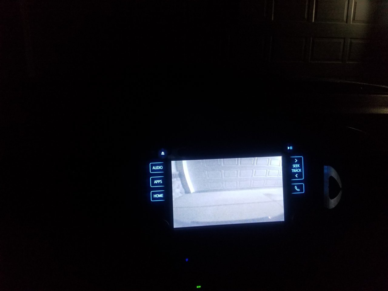

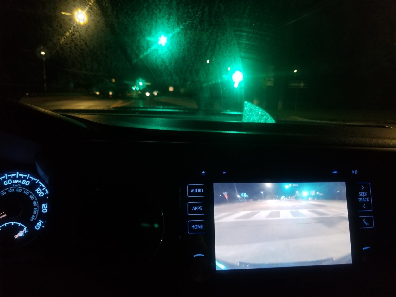

    So I'm pretty impressed with the night time view. Here is one at a stop light & one at my garage. Both you can see it's pretty dark. The garage door pic is with my headlights off but a outside light is on

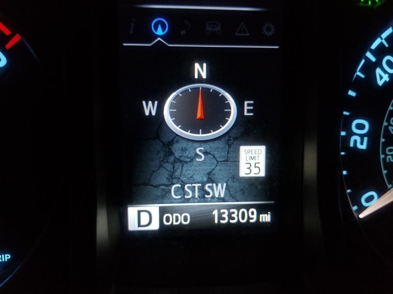

    One thing I did notice is with the manual lock onto the front camera the speed limit sign on the message screen behind the steering wheel disappears until the cameras are turned off. Here's the sign I'm talking about
