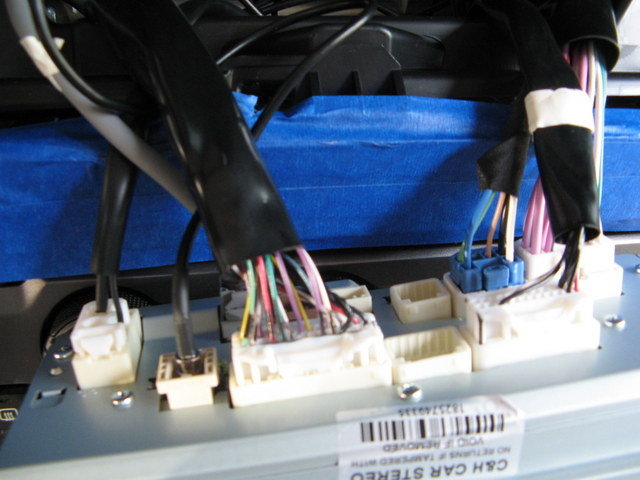

    Whats wrong with this picture, I am missing a plug and now scratching my headIMG_1229.jpg
    This is all I had to work with, I do not have plugs like shown in the install thread,now I do not know what to do

    That's weird. On my head unit, I was only missing the plug between the two larger plugs depicted on the bottom of your photo. I have the smaller plug to the left of the blue plug. I used the small plug in the back (to the left of the blue plug, where yours is empty) the large plug on the bottom left (plug to the left of your empty plug) and the large plug on the bottom right (to the right of your empty plug).

    I think it depends on which deck you have. JBL, Entune2 or SR/SR5 variants. Looks like you have the 2 larger plugs but does the small one match up with one you have there? Mine didn't exactly match what OP had either so I had to match mine up also

    I will pull it out again, I can plug into the empty spot but I have nothing to plug into the harness that came with the box, so I figured why bother using it

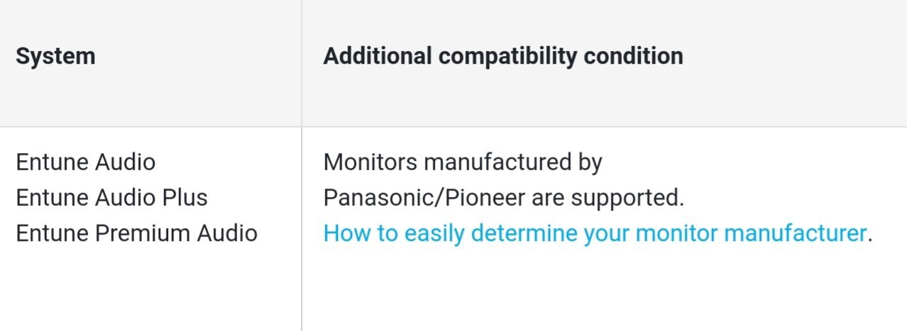

    Ok this is what I got from their website
    Amazon says FijitsuTen stereo is not supported so take a look at what stereo you have & go from there
    Sgt.Tee[QUOTED] likes this.

    How do you find out, look for a sticker ?. Can you give me the link, it has a place where you can easily determine your monitor

    Panasonic...and no cables left out. I guess I can try and plug in that plug but it will not receive one from the monitor, but the rca might have the necessary connection.

    Have you tried if it works? IIRC I didn't have that plug either and mine works just fine. I think it's an SR/SR5 thing, even though I have an SR5 and don't know much about the SR. But I think the HU are similar, if not the same. (knobs on top, not on the bottom)

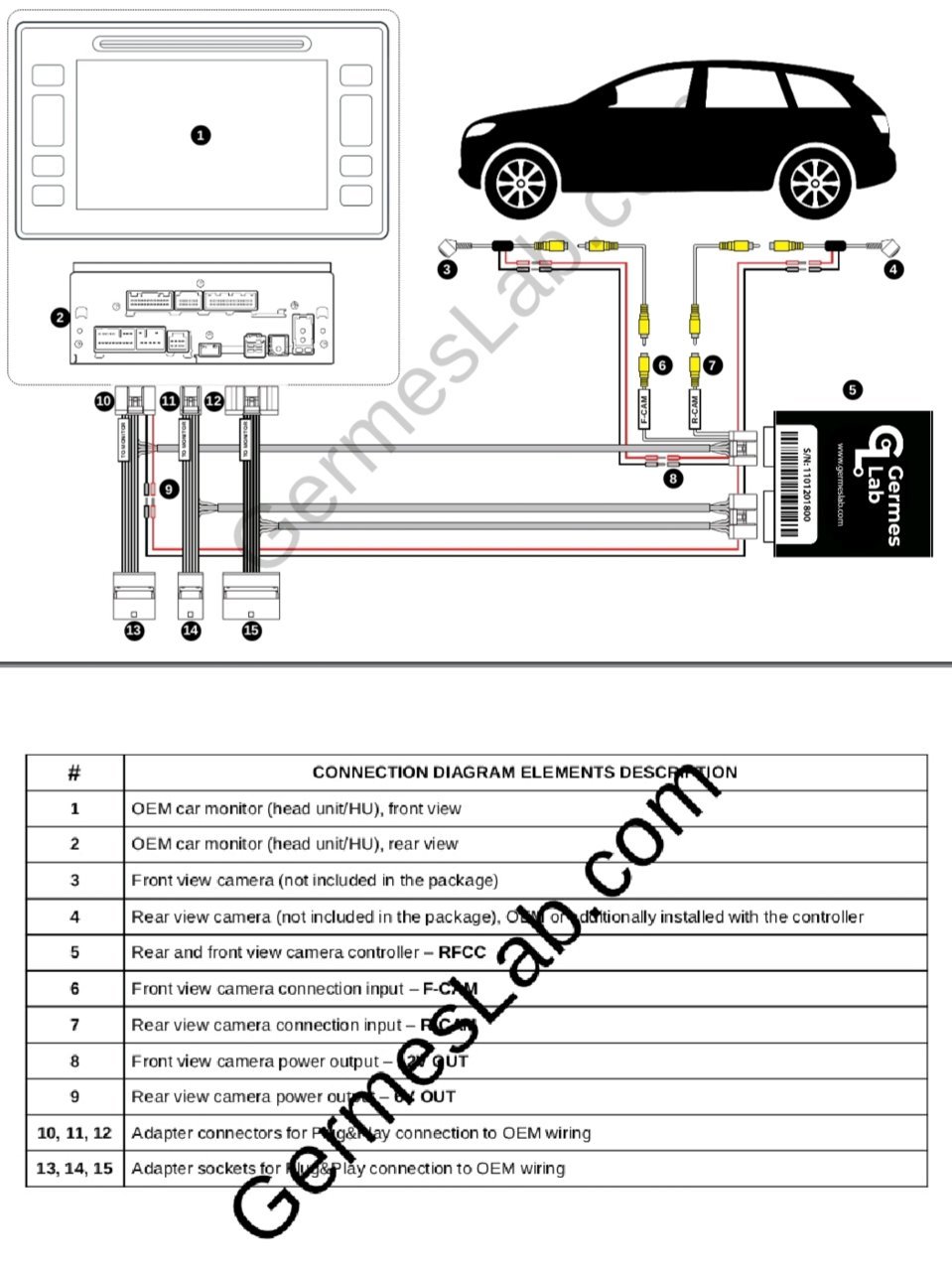

    #232988
    1,224
    Midwest
    2018 DCSB - 2021 Rav4
    The 12V lead from the harness is the correct one. I went back & read that your using a stereo from a 2014-2019 Sequoia which I went & looked that it is compatible with this kit you have.
    Here is a diagram from their website. Lay the harnesses out on a table with the media box so you can see how it all goes together. That is what I did. Ignore the rear camera. You wont have to do anything for that. As you can see one of the harnesses plugs into the box & taps that 12V power. The other 2 are joined & will plug into the box
