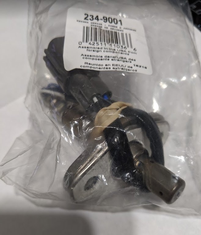

    Which brand sensor did you buy? Denso is the OEM sensor brand for these trucks, any other brand is a crap shoot as far as whether it will work well or not.
    Also beware of cheap prices on 'Denso' sensors on ebay and Amazon...lot of fakes on those sites

    Yes - my first thought also.
    Per the thread above - "I ordered and installed a Denso 234-9001 from Rock Auto." Whether or not it's a cheap knock off or whether Denso isn't as good as we think they are is a really good question.

    If its from Rock Auto then you should be good as far as it being legit, they are a reputable online source for parts.
    Toyota builds these trucks around the exact parameters of Denso sensor specs which is why they can be fussy with other aftermarket brands. But it sounds like you got the right one in there. I guess my other question would be, is the seal around the sensor good? If there's a leak around the gasket it might throw off it's readings and cause some weird behaviour

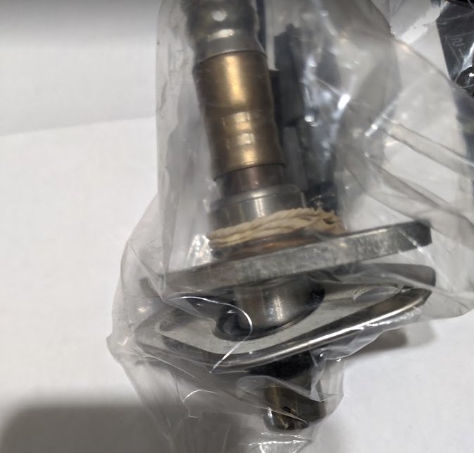

    I will report back.
    And yes I installed the gasket that was included.
