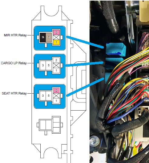

    I just bought a 2022 Tacoma SR5 access cab. I am having issues trying to find the relay location and connector for bed /cargo lamps. Is there panels that I need to remove?

    See the first post. The panel the houses the switches needs to be removed. (Driver's side)

    Ok, I removed panel. Do not see a harness under dash but I have a harness behind taillight.

    If ya don't have the cargo Lamp switch then the connector to it is attached to the panel you removed.

    Ok....looked again and found it. I was looking for a bigger harness. Put the jumper in to check power at taillight and had it. I also checked to see if I had power just turning on the dome light and closed door and still had power. So, I should be able to also use dome light switch to turn it on....correct? Also, would it be feasible to just install the jumper instead of buying the male connector?

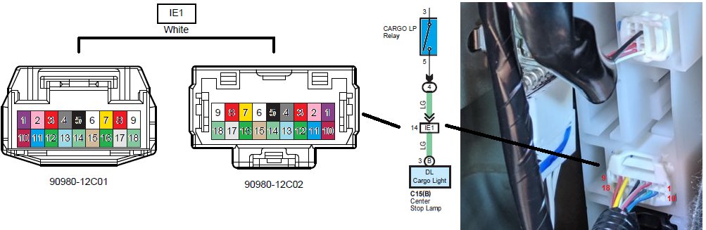

    Requesting help. I have a 2019 Tacoma OR that has a cargo lamp controlled by a On/Off/Door Open switch to the bottom and left of steering wheel. I just installed a Hooke Road rear bumper with 18watt LED lights.
    I would like to control the bumper lights with the cargo lamp switch. Can someone point me in the right direction? Can I wire a from bumper lights directly to switch?

    You have a various options, this is one;
    • Power wire of added lamps to the power wire of the Cargo lamps at connector IE1.upload_2022-7-15_17-19-0.jpg

    Thank you Caribe. Does the diagram show the positive wire going to the number 14 pin? Where does the negative wire go?Finally, where can I find the E1 relay in the truck?
