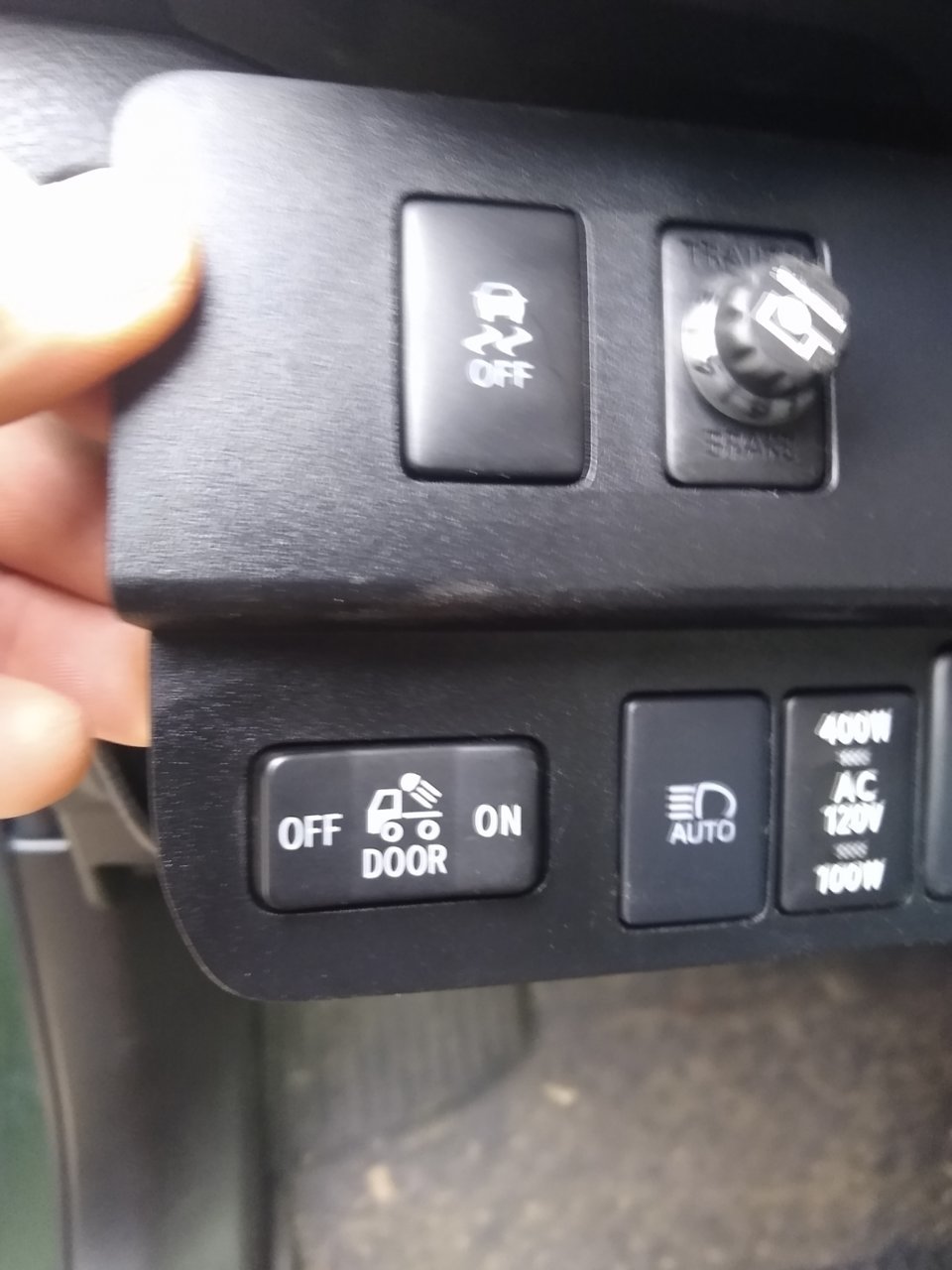

    I'm 99.9% sure the stock switch is the same as the many used 2007-2020 Tundra switches on eBay. I just picked one up for a 2007 Tundra for $27 and put it on my 2022 Tacoma sport Access Cab. P/N 191648 seems to be the same on the Tacoma and Tundra.

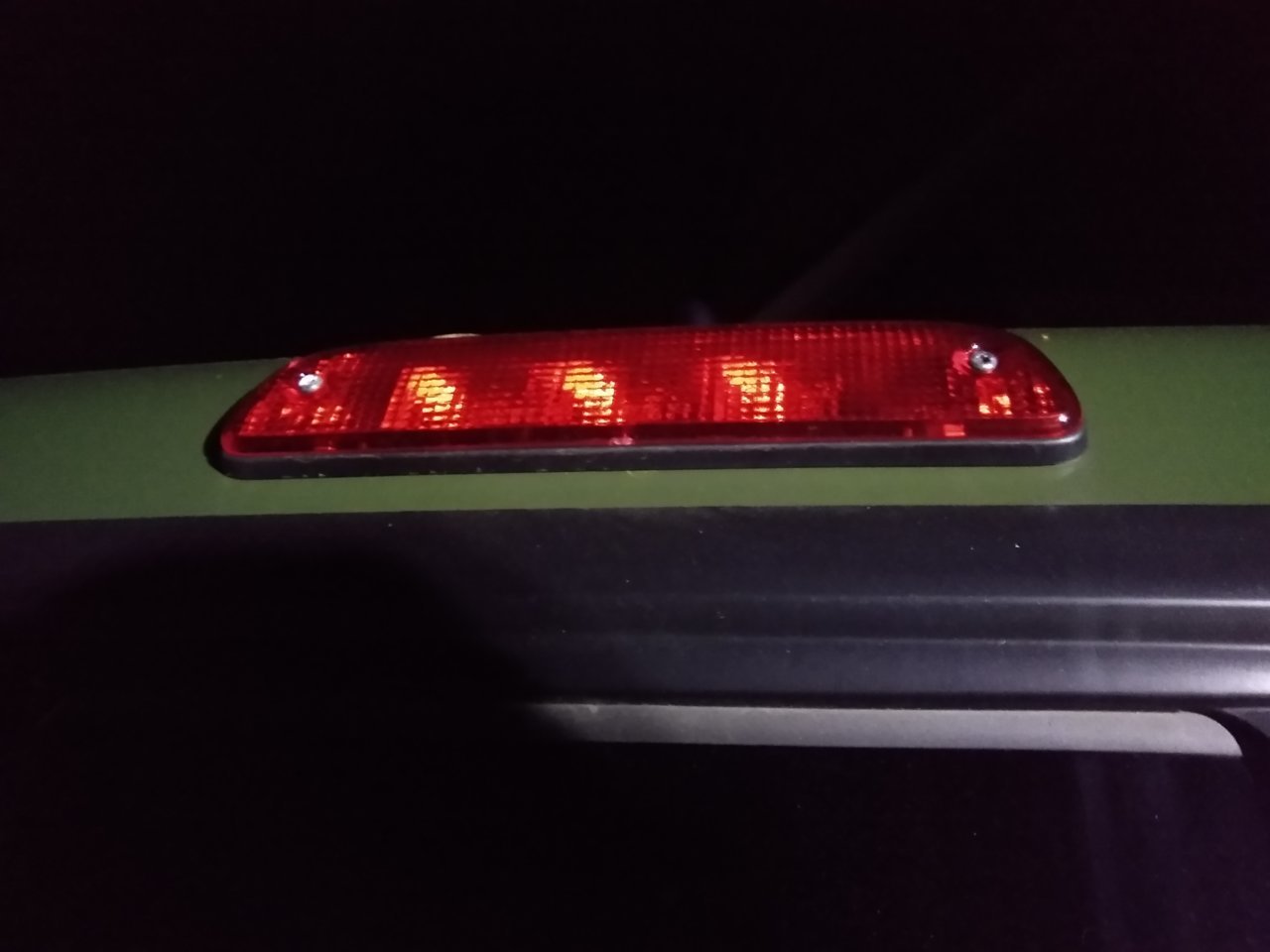

    Can you get a pic of your third brake light ?

    It's a standard AC brake only light (no bed illumination). I'll be using the switch for lights in the bed itself.

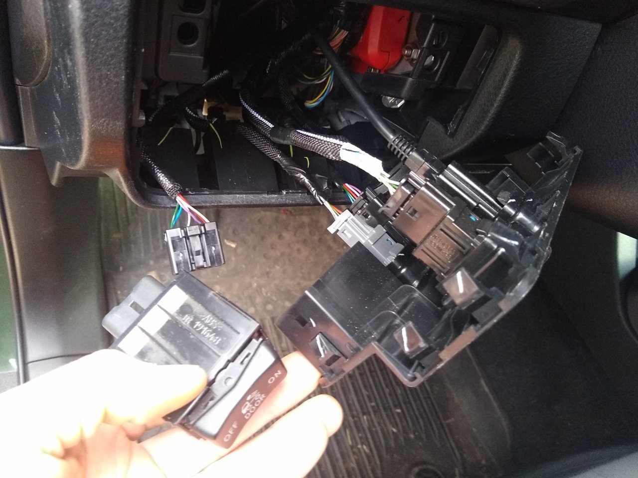

    Very simple on the later years of Gen3's access cabs. They already have the wiring in place from factory from cab dash panel to the rear taillight locations, in addition to the relay mentioned in this thread I think. No wires needed to be run. Just pop the switch in the blank spot in the cab, plug the harness plug in, then install your bed lights after removing the blanks and connect using the included 1' harnesses in the light kit.
    You can find some good videos of the whole process on YouTube also.
    Tested out tonight. Works properly in all switch positions. I'm not worrying about the 3rd brake light at this point..

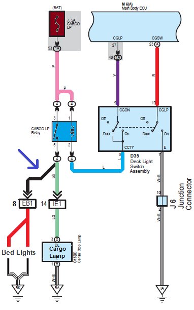

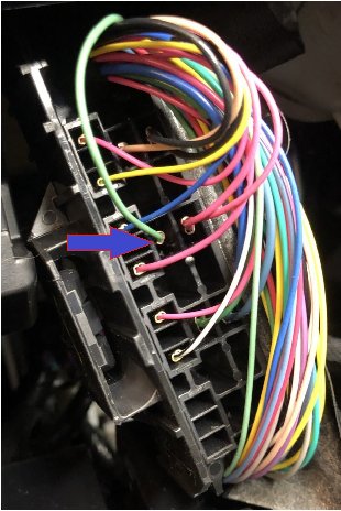

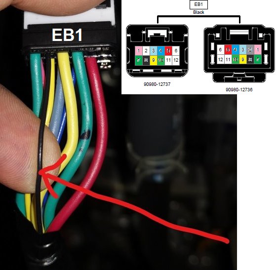

    Some versions of TACO's have a missing wire from the Engine Bay (EB1) to the Cab Cargo Lamp Relay.

    Interesting. Good to know. I took a chance after observing that my factory plug harness had a wire in each position that the plug has an electrical contact. Maybe lucky I guess. Something about 2020+ having everything necessary but not the earlier 2016-2019? Don't trust me though. My memory for thinking I heard something is bad. (Just ask my wife..)

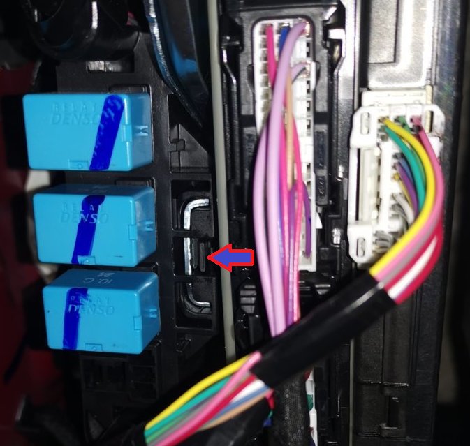

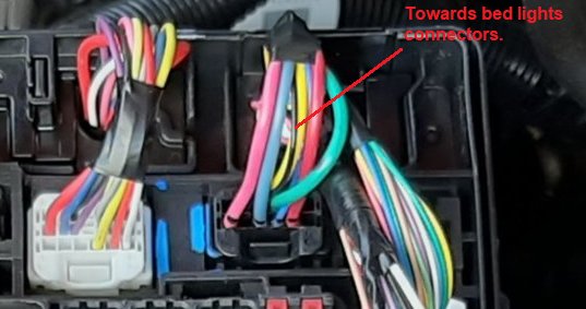

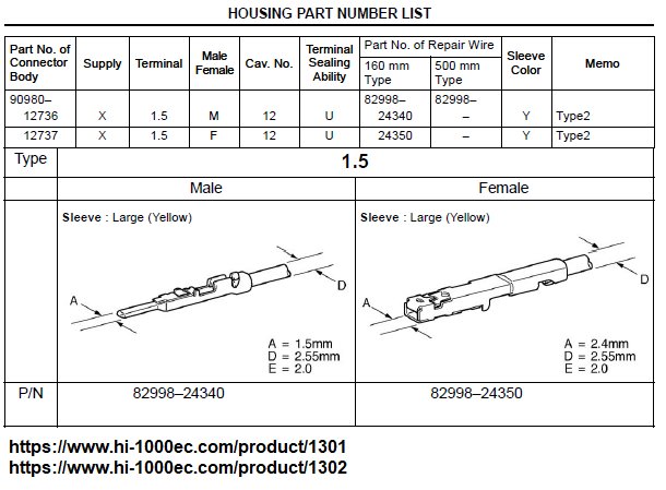

    You "could" add the missing wire(s)
    Or just run the missing wire to the Cargo Relay output:
    Press retainer to release relay block
    If there's a need to have higher amp lights then a relay set up can be added and the BLUE (L) wire having this added circuit in parallel with the Cargo Switch.

    With 2021 AC you should be good. I also went with plug and play China lights in the bed. Quite bright. For dash switch and lights it's an 8 sip beer job.
