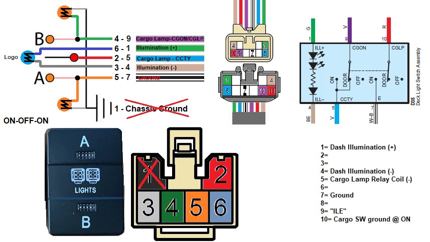

    Hi there, first post. Ive always been a lurker here but the sheer amount of info on this subject isn't very clear to me. I have a 2016 Access Cab SR5 and I'm about to install the OEM bed light kit. I ultimately want to use a DPDT rocker to mimic the Cargo switch functions in a double cab and I want to clear a few things before I order certain parts. I only know a little of what I'm attempting to talk about here

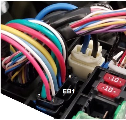

    Also, I do not have the IE1 pin#14 light green wire. I've read that I can tap the red light kit wire into the light green coming from the back of the relay holder thing? I've seen that "some tacos are missing a black EB1 wire" which has an effect on this somehow, I can not locate EB1 to check.
    And for the rocker switch, Ill follow the diagrams found in this thread https://www.tacomaworld.com/threads...g-double-cab-cargo-light-switch.436440/page-3. Viable with this switch? 7 pins vs the 8 shown in the thread but id think it can still work. https://www.amazon.com/dp/B099X49C3L?ref=ppx_yo2ov_dt_b_product_details
    and order 90980-10800 and some of the connector pins in order to make the switch happen^^

    EB1 is in the engine bay.

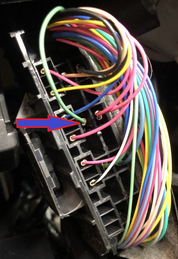

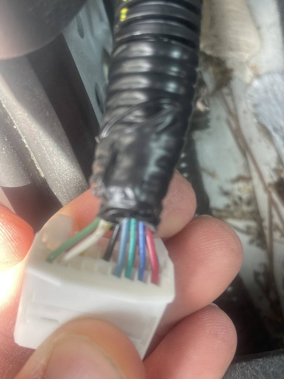

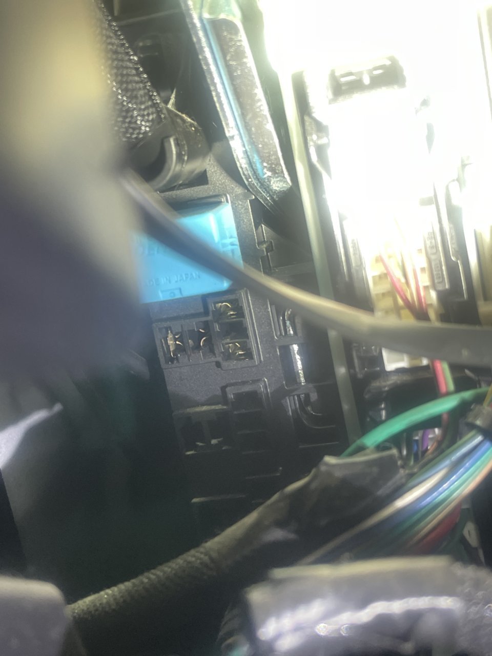

    I’ve got terminals in the relay housing, and I believe this in the picture is IE1
    0FD4FBE6-4BAB-4E45-AA57-DA084515766B.jpg 2A202276-8089-404E-98E3-5FC9454F8268.jpg

    I see you are missing the Lime Green to the Cargo lamp on IE1...

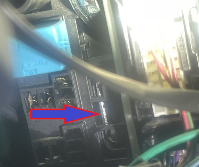

    Do you see the clip that retains the relay block? You could press it with finger nail, or small flat screwdriver to release it, and check the wires behind in. It pulls out towards you.
    Battery negative terminal removed...before hand.
    For a view like this:

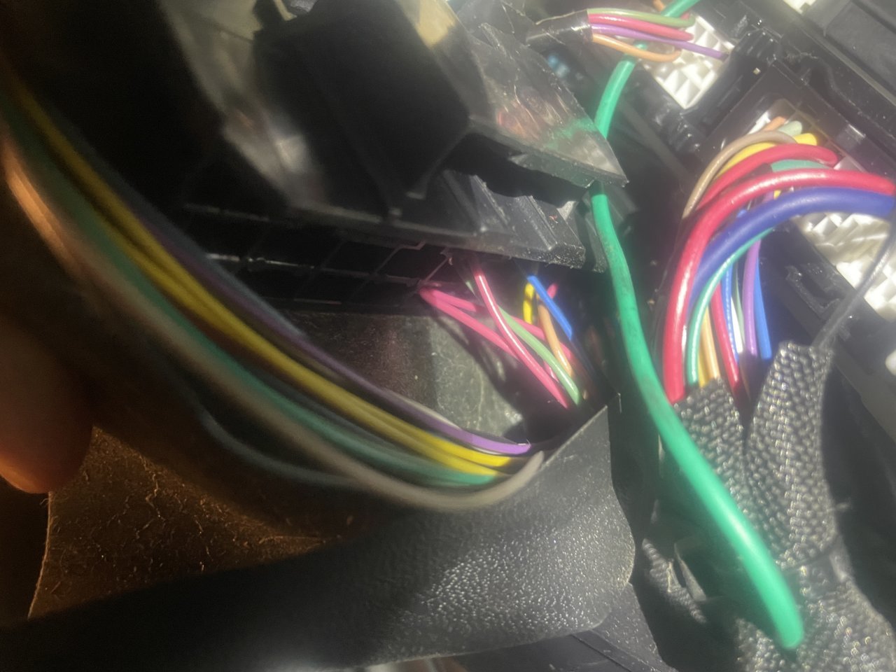

    Opening it up right now

    I know the picture could be better

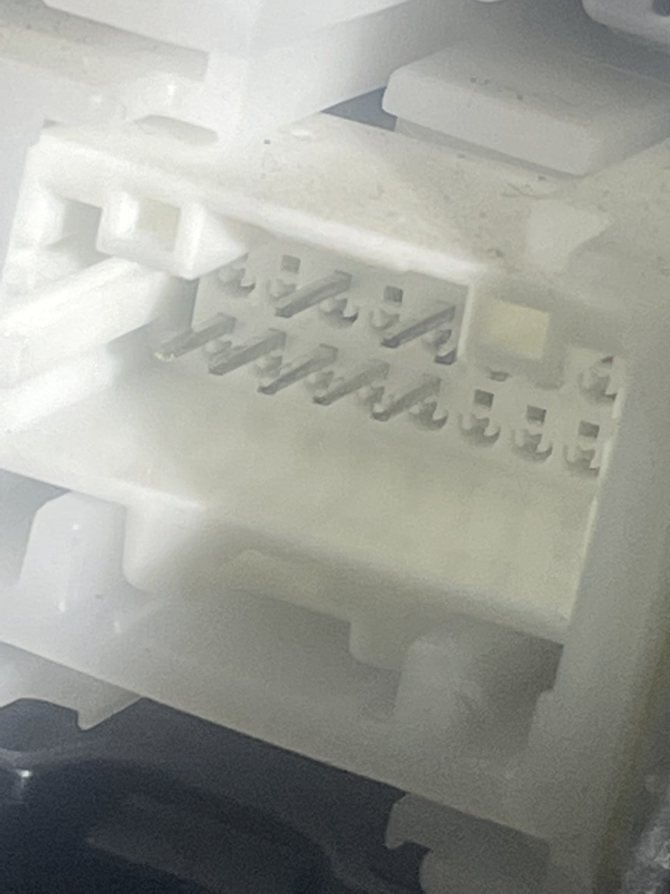

    Line Green wire is there...:thumbsup:
    One additional test, on IE1. Make note where the Lime Green wire would go, look at the opposite connector. There should be a pin on that location.

    5th from the left on the bottom, yes! I’m impressed you really know your stuff. Any switch recommendations? I might try for something more OEM looking than that button I ordered. I chose it because it matches the blue button illumination

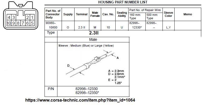

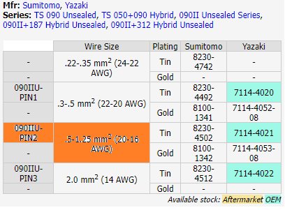

    What size pins should go into the connector I need to order? Cant find thsy in toyotsparts

    I don't have info on the terminal (pin) missing on the IE1 connector. You could use a Posi-tap from the rear of the connector to the added lamps.
