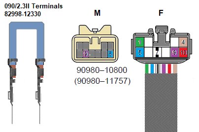

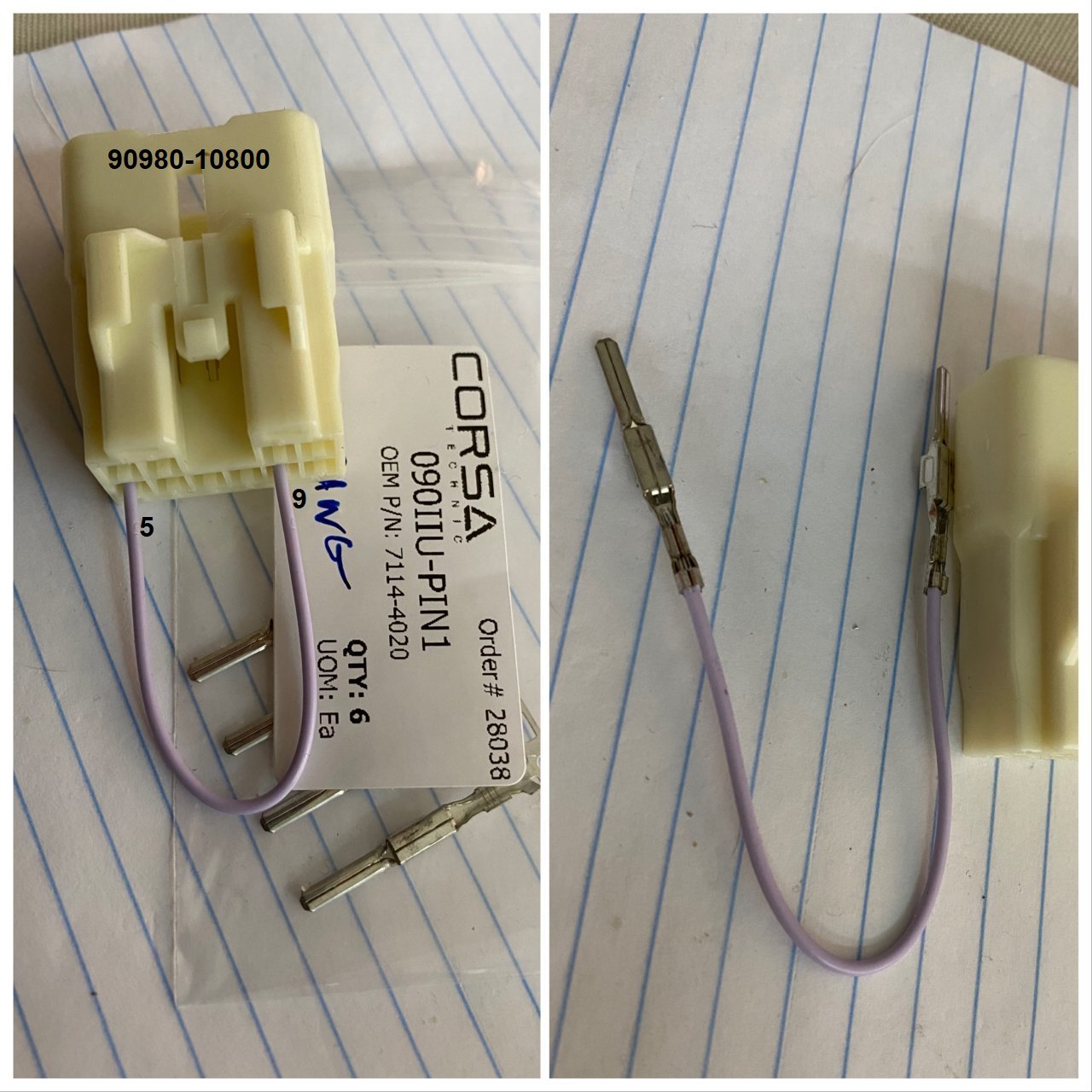

    OP, a jumper wire on the missing switch connector (5 & 9) would have the circuit ON at the DOOR feature. It would also include at Unlock/Lock.

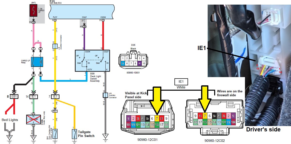

    If you wanted to maintain the circuit ON after the doors are closed, then a pin switch on the tailgate in parallel with a door open wire. One small gauge wire (loomed & secured) to the tailgate and the nearest/easiest tap is on the same connector that supplies the power to the bed lights.

    Arrows point to wire to tap the tailgate pin switch.
    IE1 is behind the Driver's Kick Panel.
