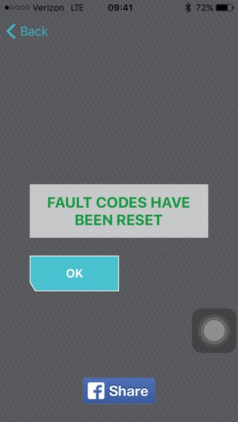

    Yes, bluetooth was on. I keep it on all the time and connects automatically to my truck. Below is a pic of the message I got (note the bluetooth icon); sent Carista an email and attached the pic as well. Gonna have to wait and see what they have to say.

    Could it just be a defective Carista hardware? Have you tried plugging it into another car to see if it powers on? Even if it can't connect to app
  18. Mar 24, 2016 at 12:10 PM
    #18
    easbaysav
    easbaysav [OP] Well-Known Member
    Jan 5, 2016
    #174053
    364
    Eddie
    Central Valley, CA
    2019 TRD Off Road AC Cement
    Works fine in another vehicle, even cleared a code. That's another check in the block so I'm pretty certain it's my OBD2 port not powering the Carista adapter or my OBD2 scanner.
