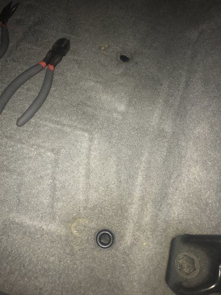

    Okay, so I accidentally broke the floor mat clips attempting to remove my weathertec liners. I picked up the replacement grommets, but I need to remove the carpet in order to install them. How exactly does it come apart? I just need to remove the driver's side to gain access I believe.

    Should be able to get ur hand under carpet by removing doorsill. I just snaps up and off.

    Oh okay, so you just pull up on the door seal and then the carpet can just be pulled up?

    Yes. The plastic part on the bottom.
