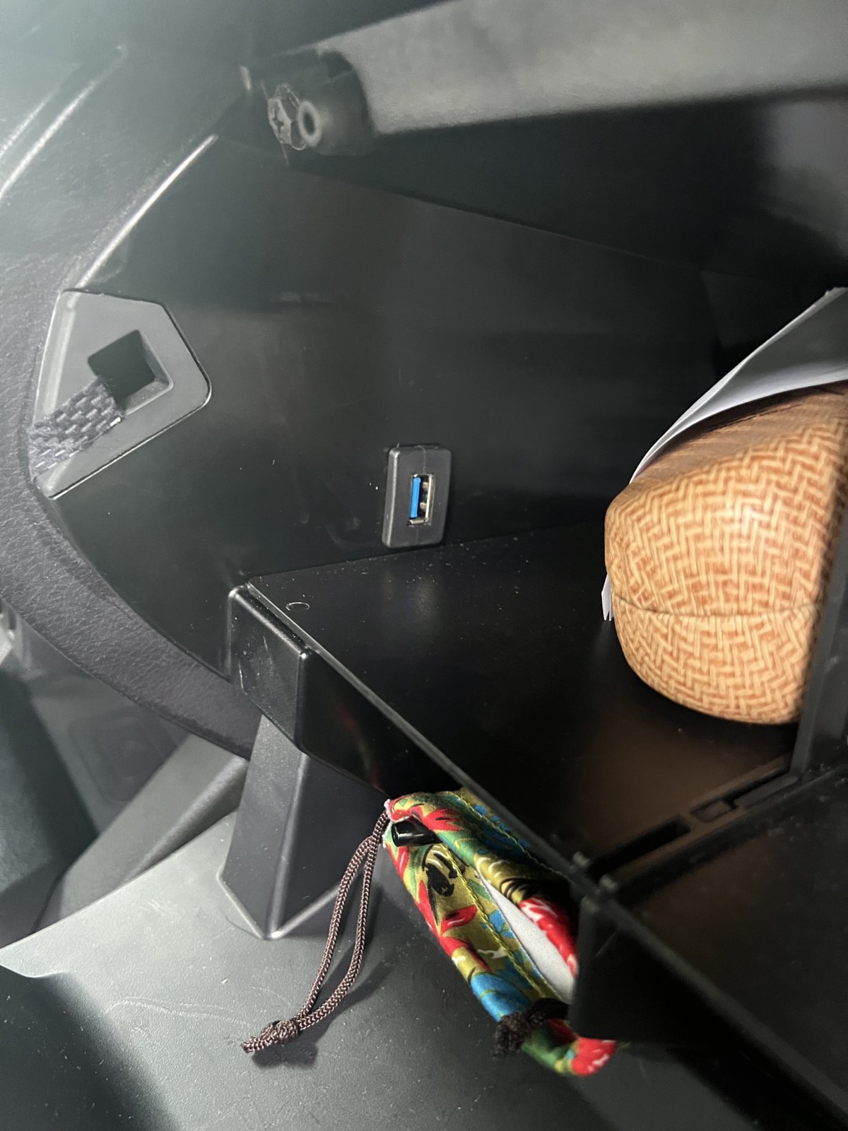

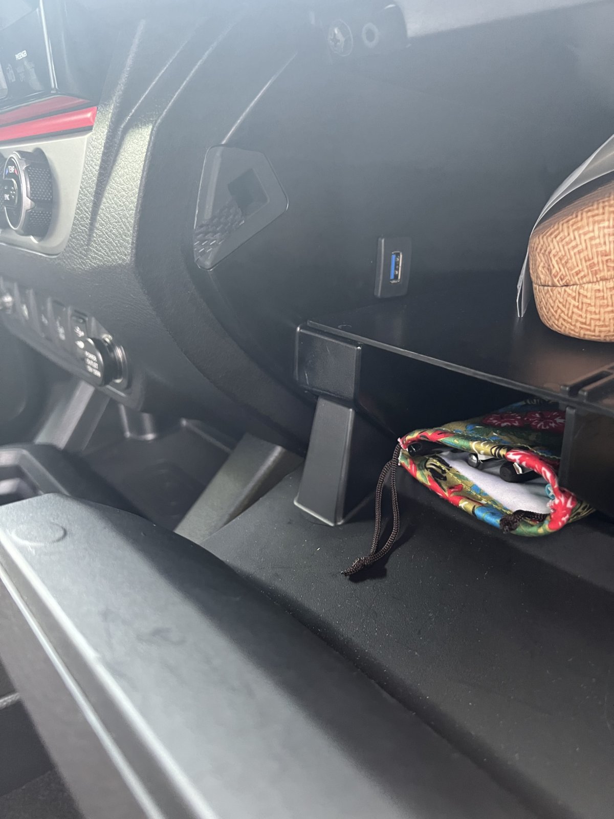

    For reference I ran my usb to the glove box since it won’t be used often. Poked a hole and installed this extender to make it look nice.

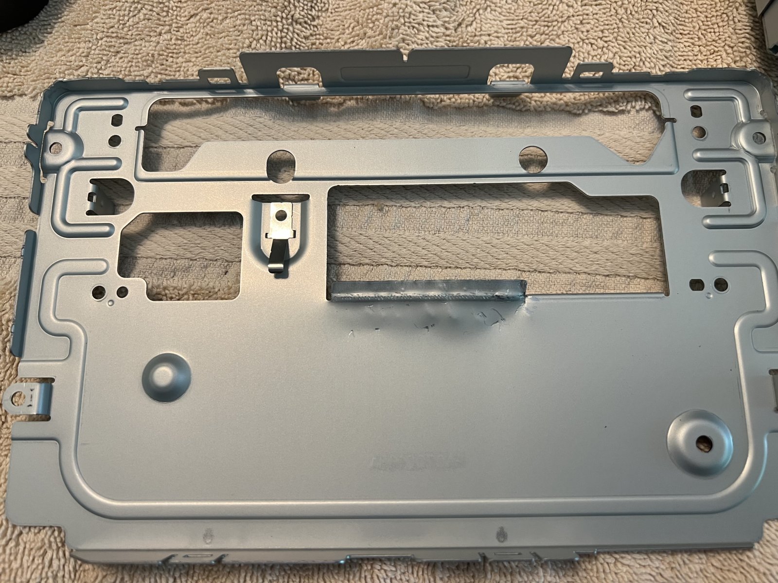

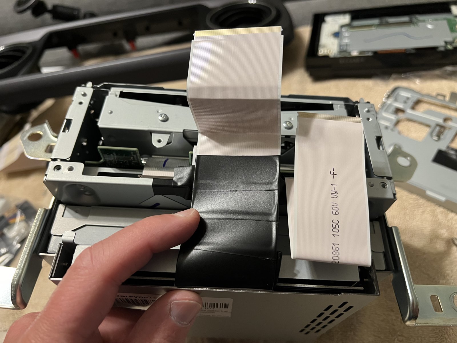

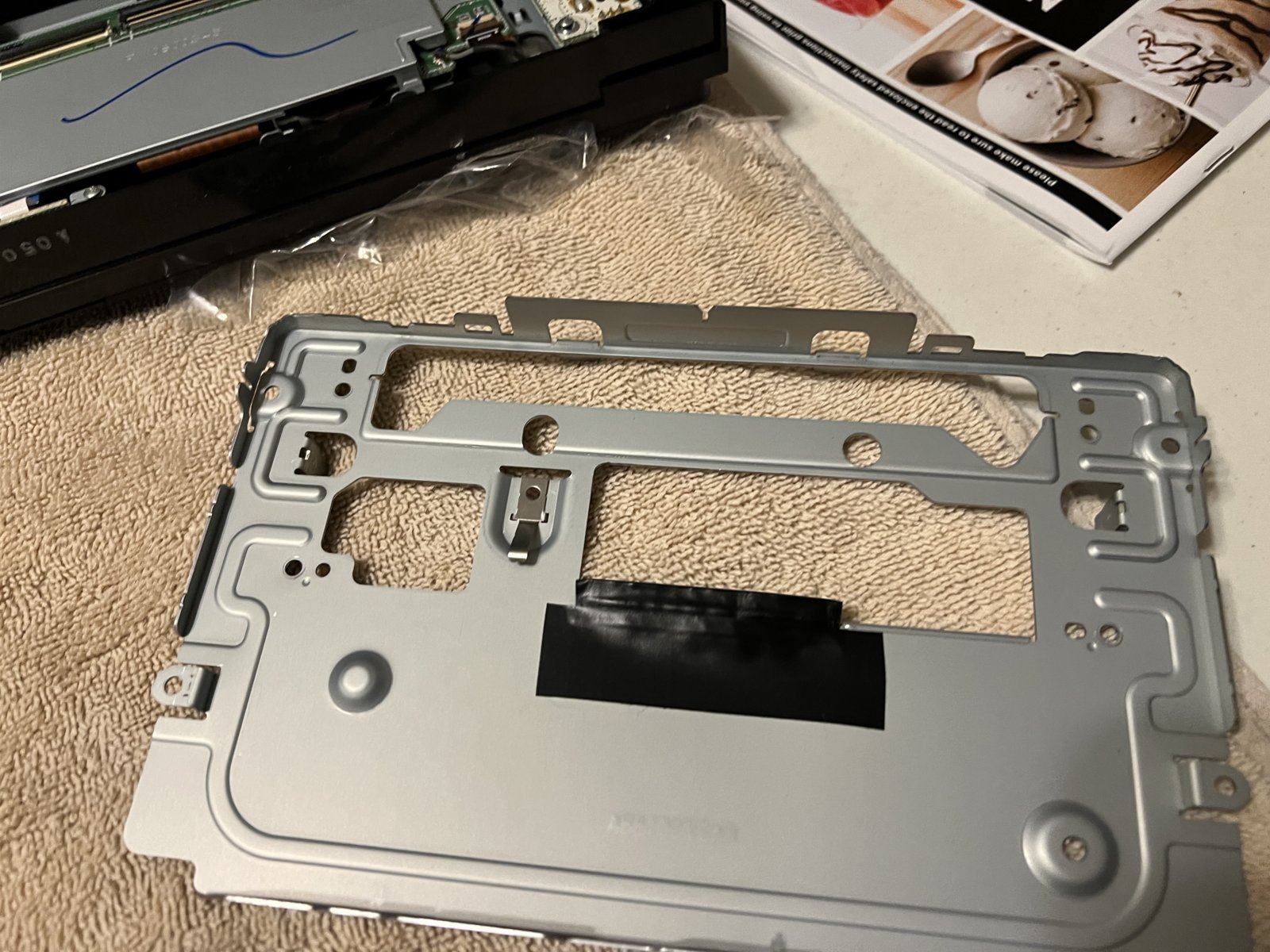

    I had a little bit of an issue fitting the ribbon cables around the front face plate. I choose to keep the XM module so that maybe that have caused the problem. I ended up cutting and bending the front face plates to keep from pinching the new ribbon cable.

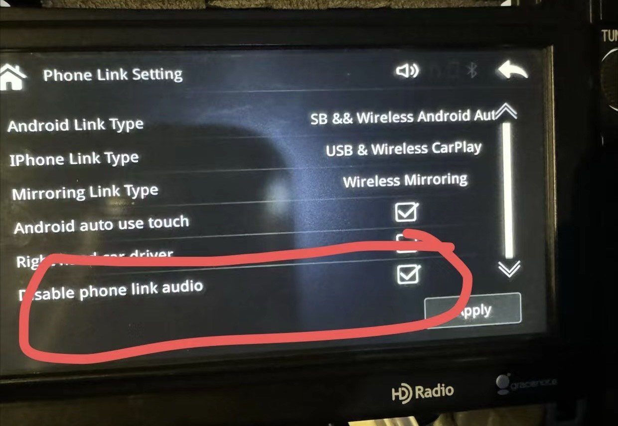

    So I received word back from tech support. I did not have a box checked in the system settings. Caused my audio not to connect correctly.
    From tech support “under decoder menu Settings > System Information > Factory Mode > Disable phone link audio is ON (ticked) must be ON”

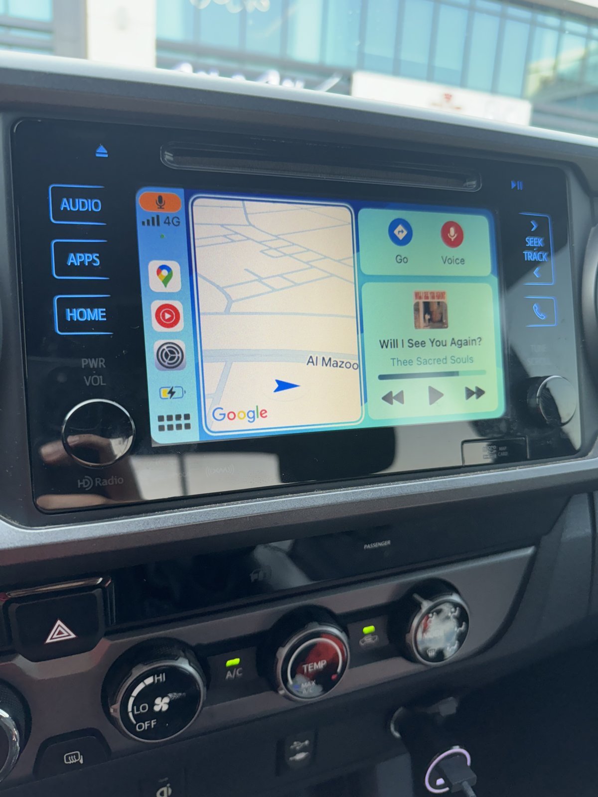

    After I checked this box everything is working like it should. Now I just need to find a permanent home for the USB cable.
    I am loving having CarPlay in my 2018 Tacoma!
