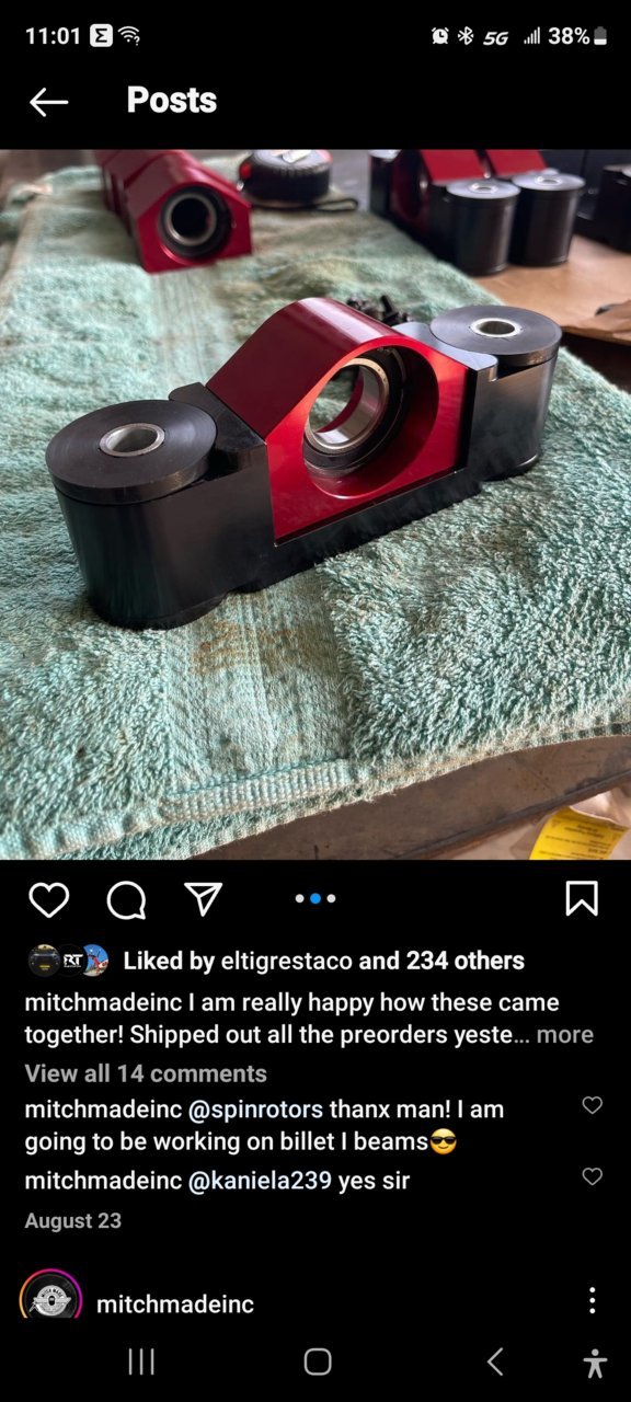

  14. Sep 14, 2023 at 9:39 AM
    #274
    Dvst8r1K
    Dvst8r1K Night-Taco
    Jan 27, 2017
    #208800
    687
    Greg
    2nd gen Black Tacoma SS 4.0l 4-dr 4x4
    1" Toytec body-lift, K&N filter, coolant by-pass, mesh cotton screen delete, TTBS, WeatherTech in channel visors, 2.5" Rancho full suspension kit, Oil Catch Can, Toyo 285/70 A/T-2's, 21.5" light bar in grill, blacked-out grill, de-badged entire truck; and again, more to come.....
    2nd gen carrier bearing issues resolved. Mitchmadeinc.com.
    I've not seen this on the site yet, nor have I bought one, but can someone set up a group buy with Mitch, and not only get a discount but finally do away with these other cheeseball c/b's that only temporarily fix the problem.
    otherphone likes this.
  15. Sep 14, 2023 at 10:20 AM
    #275
    TireFire
    TireFire Superunknown Member
    Feb 6, 2016
    #177349
    7,666
    Olympic Peninsula
    Not so sure this is the end all be all solution. Would still need to potentially adjust driveshaft angles with spacers etc. For how expensive this likely is, I’d stick with the Ranger bearing and cut to length tube spacers :)

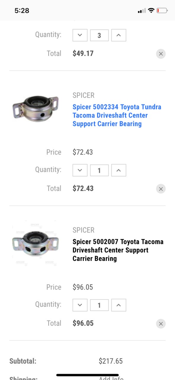

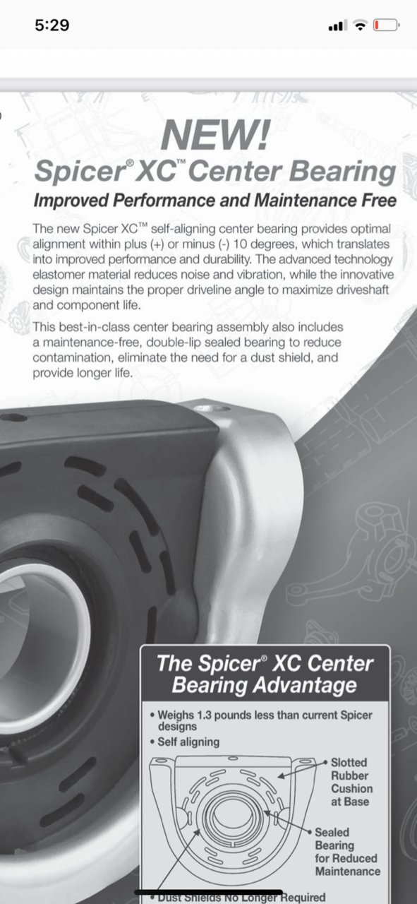

    otherphone
    otherphone Well-Known Member
    Aug 18, 2023
    #431549
    133
    MA
    09 tacoma sport
    OME2.5lift w/medium leafs
    Is spicer considered OEM for a 2nd gen Tacoma? And I look at their website and see the “xc” they claim is better. So I see these two on driveline America (see price difference) but they will not respond to emails/ inquiries. And the spicer website only list’s dimensions instead of truck listings , so it’s kind of hard to know what one to order. I guess if your replacing it , wouldn’t it be better to spend extra and get the “xc” ?
