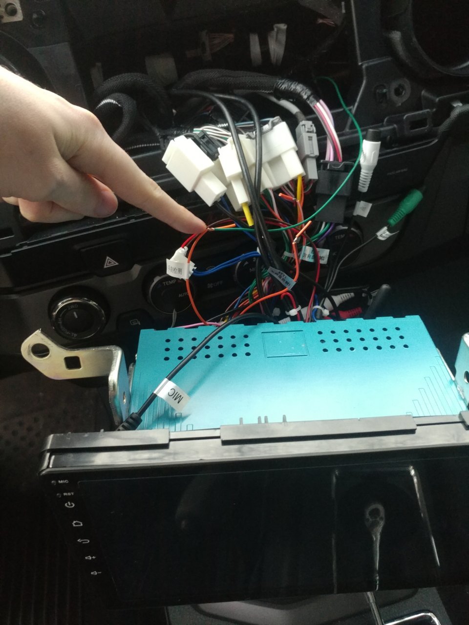

    Hello!
    I've installed one of these in my 2021 Tacoma. I had to select the 2020 model year when ordering, but it mostly works with my truck anyway.
    Here's some things from my experience so far.
    When installing, the black connector that went into the OEM head unit is not used. This doesn't appear to affect anything, despite all the wires it has. Aside from that one, there's pretty much only one place any given connector can go.
    The "USB 3.0 kit" is absolutely pointless, don't get it. The head unit just doesn't have the requisite number of pins for that.
    The black boxy connector with a USB port on it is not used.
    The "key1" and "key2" wires are unnecessary. The unit works with steering wheel controls out of the box.
    Drilling the OEM brackets isn't necessary, but grinding down the dimples is easy enough, so you might as well do it. The brackets the head unit comes with can be disregarded.
    I used this GPS retention adapter. It takes the time to get a fix from 4-15 minutes down to less than a minute. Definitely worth it.
    Bluetooth audio quality is absolutely terrible. Just do yourself a favor and stick your media on a flash drive. Playing directly from that it actually doesn't sound much different from the stock head unit, but then again I did have a higher trim level to begin with.
    Despite being "basically an android tablet" the head unit can only be paired with things. You can't pair things to it. So forget about headphones, bluetooth OBDII adapters, or bluetooth LED controllers.
    VLC probably requires the least amount of touching things out of anything I tried for both video and audio, unless you've got all your files tagged properly.

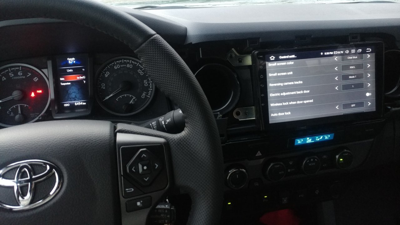

    The "control settings" app appears to offer some vehicle settings the OEM unit controlled. However, none of the items within this menu respond. I thought this was because "break" [sic] wire wasn't connected to anything, but it didn't seem to make a difference if I hooked it up to ground (pictured-the green wire goes to a bolt) or to a 12 volt source (a power drill battery).
    Consequently, whenever the head unit finishes booting, the odometer unit is changed to kilometers, even if you manage to change it back before it finishes booting. Also, going into this menu will sometimes cause the truck to beep once. I can live with this being stuck, but it still really bothers me, so if anyone has any ideas I'd be happy to hear them.
    I put one of the two extra USB ports between the steering column shell and the lower dashboard shell, right behind the ignition. The other connects to a USB ELM327 OBDII adapter behind the dashboard, which can be left in the port without draining the car battery.
    One handy setting is the battery voltage display, but that only gives you an idea of how charged your battery is while the engine is off.
    I've been having trouble with software instability. Basically, everything will be working fine, then out of nowhere, I'll turn the car on and try to launch something and I'll be assaulted with unending "[app] keeps stopping" dialog boxes. This can only be solved by a factory reset, which is annoying. So here's what I'm doing to try and control that:
    Set the head unit to fully shut down 30 seconds after ACC off instead of auto sleep.
    Do not install apps or download maps with removable storage in the head unit.
    Do not pair the head unit to your phone over bluetooth. If something requires internet access, I'll just join the head unit to my phone's wifi hotspot.
    Do not allow the head unit to shut down with removable storage inserted.
    Do not allow the head unit to shut down with any apps open.
    Items set in the factory settings menu persist after a factory reset. The password for that is 126.
    PiryongS likes this.
