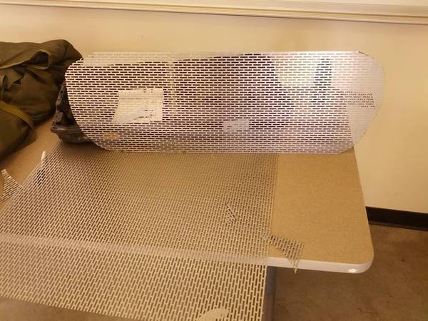

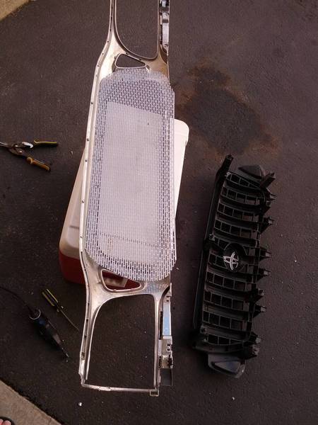

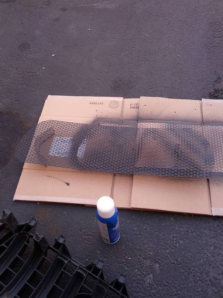

    DIY custom grill
    Made my custom grill today. I bought the perforate sheet from Pacific Grating and chose a carbon steel (not stainless) Side Staggered Slot sheet. The 4ft x 4ft sheet cost $25 and I used spray on plasti-dip to paint as carbon steel will rust fairly easily.
    Build and Install:
    1. Cutting out the sheet:
    I used a Dewalt cordless grinder/cutter/sander to cut out a rough match to fit the grill. I then used tin snips to do the finishing trimming just prior to painting. The perforated sheet is fairly thin and cuts well with the tin snips though thicker gauge you'd need to use a jig saw with metal fitting.
    2. I removed the grill assembly by removing the two top screws (Great talk through with pics) which are just to the right and left of the tops of the headlights. I then squeezed the six black plastic connectors between the OEM grill and the truck. If you look down between the grill and the radiator you can see all six. Then you just need to disconnect (tricky part) the connectors behind the painted plastic strip under each headlight. The best way is to reach under each headlight and feel around for the clip.
    3. The chrome portion of the grill and the black plastic OEM grill are glued together. I used a flat head screw driver to break off as much of the epoxy as I could while saving the clips because some would match nicely with the perforated grill. Once the plastic grill was off, I measured up the new grill with the chrome frame and made my final trims before spraying both sides with plastic (gives it a nice textured look).
    4. Because the new grill does not sit completely flat inside the chrome/plastic, I first applied some hard sealing epoxy and then zip tied the grill to a broom handle on the outside/front of the chrome/plastic to force the new grill to bend and conform with the natural concavity of the plastic/chrome. The grill needs to sit like that for 24 hours or the full curing time to ensure the epoxy is set because once you remove the zip ties, the metal mesh will want to flatten and unglue and will be assisted by every bump in the road and the force of the wind against the front while driving.
    5. Cut out a TRD stencil for the front.
    Complete project is my 12-5-13 picture at the top.

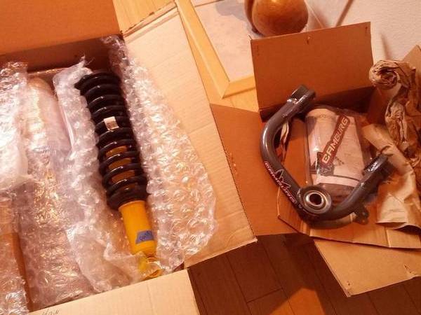

    Got these in the mail today. Going to attempt the marathon install tomorrow. It'll be the first time installing either for me so may take some serious effort.

    Curious why ya chose Camburg UCAs over the other brands?
  8. Dec 5, 2013 at 9:13 PM
    davidpick
    davidpick NWXPDTN
    Jan 21, 2010
    #29760
    2,380
    David
    Leavenworth, WA
    1988 Pickup 22R 5sp 2wd
    Weber 32/36, RV Cam, LCE exhaust headers, Desmogged
    nice! looks like you got the coils/shocks preassembled, which will save you a ton of time on the install. i'd remove your old coilovers as one unit too.
    Pro tip: getting the upper ball joint to separate from the stock UCA can be a huge pain. i tried all sorts of methods on my old tacoma -- pickle fork, cursing, 3-jaw puller, cursing, heat... did i mention cursing? ended up purchasing a 4 lb maul from home depot and i kid you not, 4 good whacks later, job done. other side was just as easy with the maul.

    Went with the Camburg UCA mainly because after reading through pages and pages on the suspension section no one had anything bad to say about the Camburg brand (as opposed to Light Racing) and it is cheaper than ICON or Total Chaos. The off-roading do is more expedition off-roading than rock crawling so I don't need absolute top of the line stuff.
    We'll see how it feels when I'm done. Anything will be better than my current crappy ride quality.
    As for installation, I've got access to a decent shop so I'll be able to leverage several tool options to get the ball joint separated. I've seen a few guys on here that did just what you did (David) and applied a few solid hits.

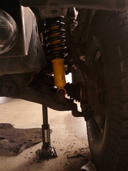

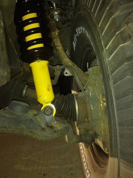

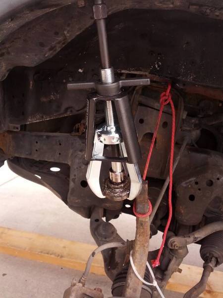

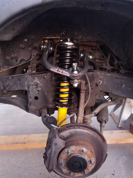

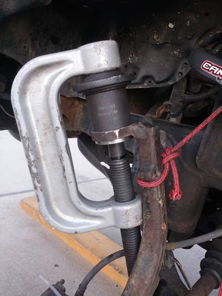

    How to install new Uni-Ball Upper Control Arms
    Here is the DIY install for Camburg Uni-Ball UCA on a 1st Gen Tacoma.
    Steps as I completed them:
    1. Apply WD-40 to all nuts and bolts once or twice in the 24 hours prior to work.
    2. Loosen nuts for both UCA and strut assembly (you can exclude the lower strut nut till you remove the assembly)
    3. Remove strut assembly
    4. Remove UCA
    5. Install new UCA
    6. Install new strut assembly
    Important tools not listed in required tools list:
    1. punch - used to get lower bolt out of the strut assembly. I used a punch and a narrow pry bar to work the bolt out then used a ratchet to twist it the rest of the way (warning: this will strip your bolt)
    2. pry bar - a very narrow, square 1/2" x 1/2", was very useful for working with the strut assembly
    3. WD-40 to pre-grease all connections
    4. Circular cutter/grinder - Very necessary to grind down some of the corrosion to ensure a flush fit of the uni-ball joint into the spindle.
    5. Sawsall - Used it to cut the ball-joint bolt because I was unable to separate the ball-joint from the stock UCA.
    6. Sandpaper - to clean the inside of the spindle of all corrosion to ensure a flush fit of the new joint.
    7. A thin coat of M-A-N: You're going to need it because some of those rust sealed nuts and bolts are going to hurt your feelings.
    Complete the install of the new Camburg Uni-Ball UCA and OME strutt assembly in about 12 hours over two days. I will not it took me about 3 hours to completely finish the second side as I'd learned several very useful lessons doing the first side (ie. F#@! trying to separate the old UCA from the ball joint, just cut it). Removing and replacing the strut assemblies was piece of cake though it did require some serious muscle at some points.
    1. Raise the vehicle and place on jackstands, ensure you place wheel blocks on the back wheels. Make sure you look in your owners manual (or google search) for the proper jack location on your frame as you can't just place it anywhere (who knew).
    2. Remove the wheels (if this is your first time ever doing anything like this, make sure you've already loosened the lug-nuts prior to lifting the tires off the ground)
    3. With the jack stands under the vehicle, use the jack to take off some of the pressure on the suspension. I found I raised and lowered the front suspension assembly 0-3 inches throughout the installation to get the strut assembly on and off and to work with the UCA.
    4. Remove the strut assembly. Loosen the three retention nuts at the top (obviously don't mess with the center which holds the actual assembly together). Then loosen and remove the nut and bolt at the bottom of the assembly. Never fear, though it may seem like a spring loaded strut assembly will shot down, it won't. However, this is where the punch comes in handy. Once the nut is off, I used a punch and hammer to push the bolt the rest of the way out; on the driver's side, in order to avoid getting my punch out, I used a ratchet to screw it the rest of the way out. Once the lower attachment is off, finish removing the top three nuts and then remove the strut assembly. It is heavy, so be prepared to man handle it out and avoid mashing your fingers on the lower control arm, which I did and then swore at nothing in particular.
    5. The easy part is now over, it is time to remove the old Upper Control Arm.
    As you can tell, there is some serious rust on the old spindle/ball joint. This proved to be a huge pain in the ass because I ended up breaking the 3 ton 3 jaw press I bought from Sears to press it out. Also, the typical U-joint press you get from your auto parts store doesn't fit very well on your spindle. IMPORTANT: if you are lucky enough to have a good O'Reilly's (like I do, but didn't realize when I did the install), they will have the Ball Joint Press 4wd kit to accompany the Ball Joint Press kit. The 4wd kit just has additional bits to help. Anyway, I ended up using a BFH to get the ball joint housing separated.
    Seen here: tied the spindle up to protect the cv boots and reduce droop, using the 3 jaw press to get the ball joint housing out of the spindle. The 3 jaw press is an amazing tool if you can find one at a local store.
    The U-joint press is awesome for pressing in the new Camburg uniball. IMPORTANT: Get some sand paper and clean inside and outside of your spindle thoroughly before you install the new uniball/balljoint. You need to ensure you have a completely flush fitting or installing the new o-rings will be a nightmare, trust me. Crank down on the U-joint until you pull a muscle, it is the only way you can ensure a solid fit.
    Here is everything on and done before putting the wheel back on. May as well rent a torsion wrench if you don't have one to get all your tensions correct during install.
    CV angle, I'll install the Diff drop tomorrow
    Final ride height. The front is definitely higher then before.

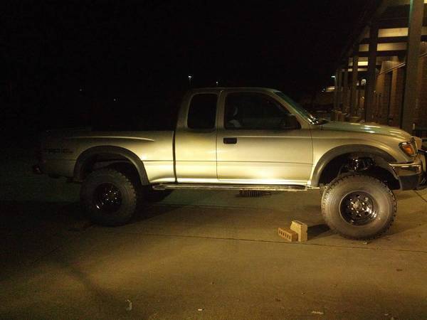

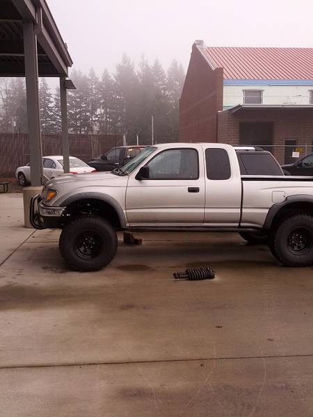

    I'll keep working on the DIY writeup. However, got a question for you guys regarding my CV angle: after installing the Toytec diff drop, I still have a pretty sizable angle, how harmful? As the new front suspension settles in, my front end will drop slightly, but hopefully the angle I have right now isn't too crazy.
    Here is how it looks from the side. There is a fairly substantial lift difference.
    Second question: This is my front wheel stance after the new front setup with 1.25" spacer. As you can see (maybe), there is a slight angle to the front wheels; will this go away as the suspension settles? What causes it?
    Third question: I'll start installing my second battery in the next few weeks; after reading through some threads I see some battery terminals with plastic caps on them, how important are these and how effective are they for preventing corrosion?

    you will need an alignment after installing that lift. give it a day or two to settle, then get it aligned!

    Looking good. The front will settle a bit..

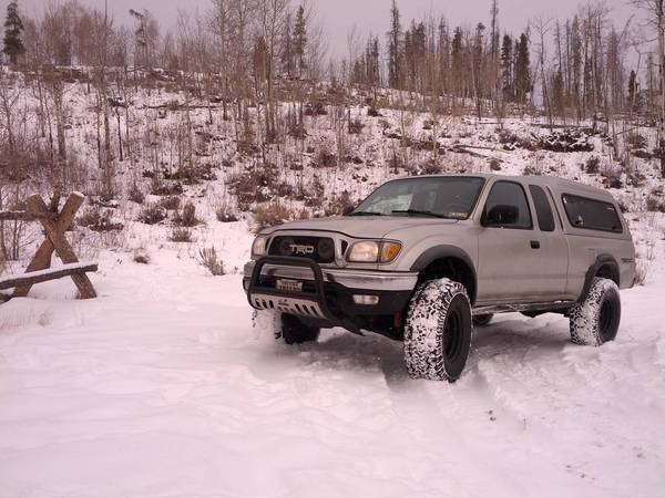

    Had the chance to tear around in the snow for a bit in Frisco, CO. Just had a transmission leak fix around the shifter. Turns out it is an easy fix with some industrial silicon sealant. 4wd is working great again.
    Lesson learned, going too fast in 4wd, even by mistake, will cause a leak.
