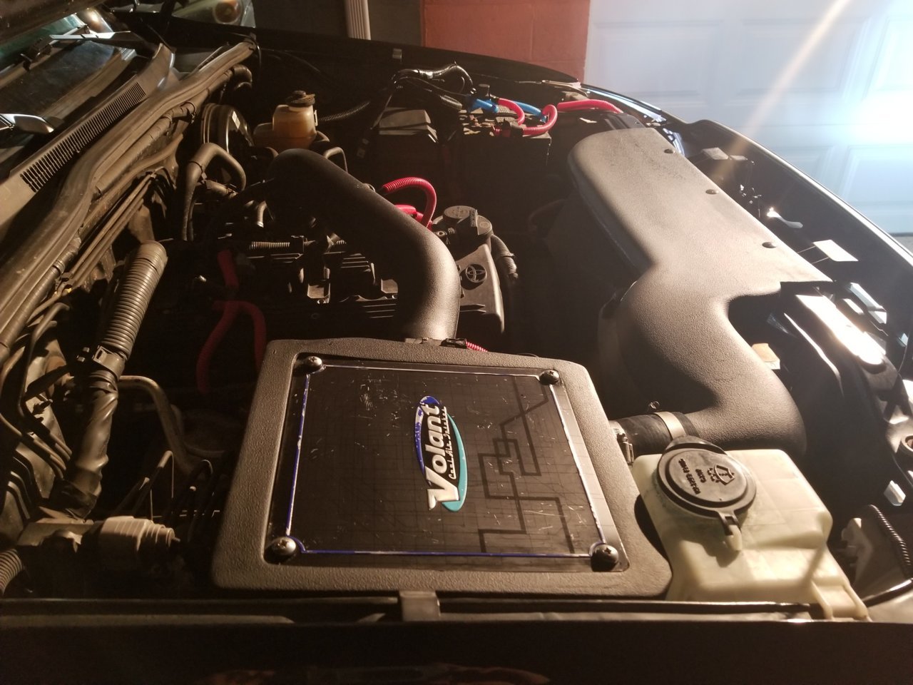

    I put a volant 2 piece ramair induction on mine for cold air
