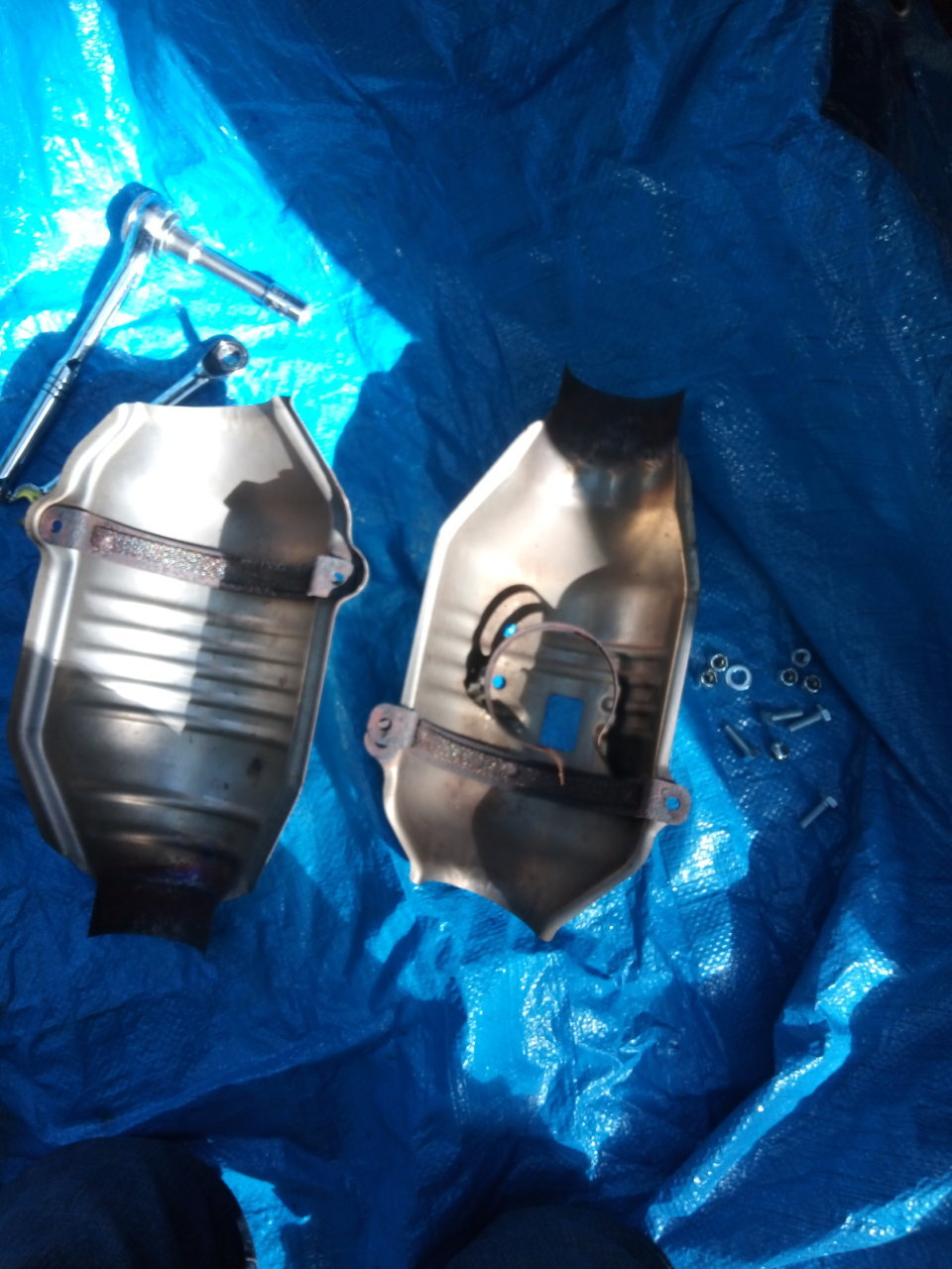

    I saw i post about this recently
    My taco started making rattling noises
    Check shield and it was loose
    The fasteners had rusted, i pulled one off the others i had to chisel off once i removed the shield
    I bought some 1” bolts and nylon nuts and reattached it
    So far so good

    Welcome to the club! Started getting a rattling noise a few years ago. That circular clamp attaching to the tail end of the shield had rusted out on mine requiring replacement.

    Same here, just cut mine off and never looked back lol

    Those nylon nuts may not last very long, due to the heat. More than likely you'll need to get some standard nuts. Be prepared for that.

    Spell check made it nylon nuts
    They are the nuts with nylon inside
    Your right though the nylon might melt
    If they melt will have to put a lock washer on
    Time will tell

    That rattle can be very annoying.
    I have always used a big hose clamp.
