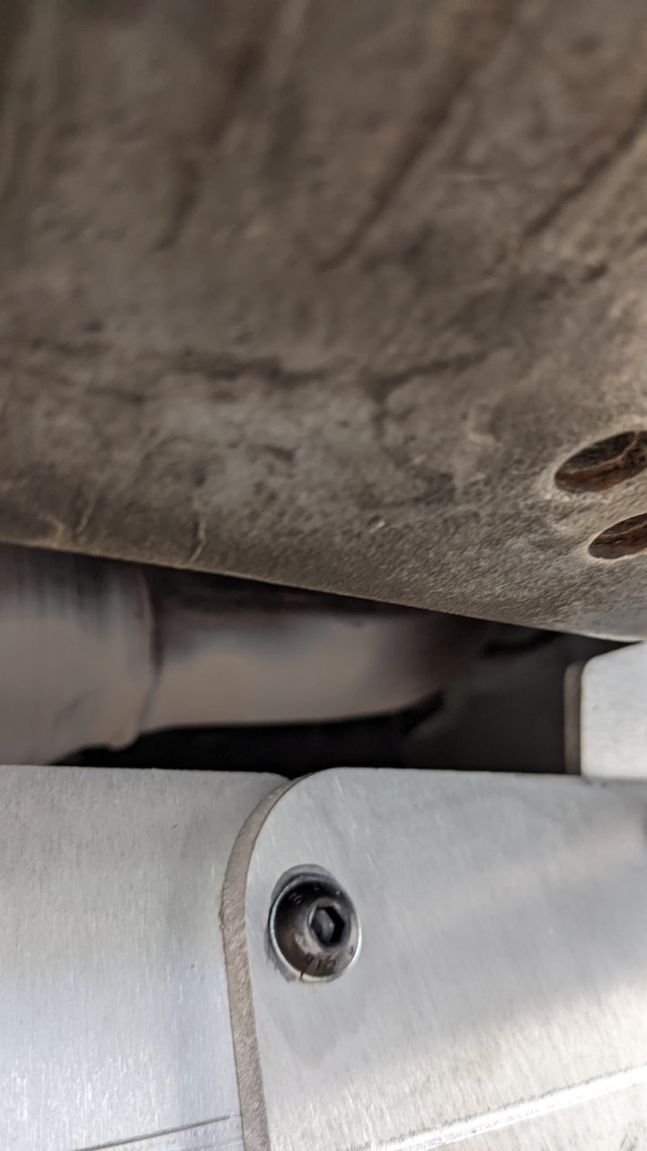

    25
    Rod
    2014 Barcelona TRD
    Just installed the Talon on my 2nd gen. Pretty disappointed in this. Before tightening it down, I checked the return policy to see if I could box it up and send it back. I feel this provides no deterrent other than visual, if a thief starts to crawl under and sees a shield, they may just move on, otherwise, if they have a long saw blade, it's easy to access the front of the pipe. The backside pipe has zero protection.
    If someone can tell me where I'm wrong and help me feel like I didn't just waste a bunch of money and time, please by all means I'd like to be corrected.
    UPDATE: Talon reached out to me and offered up a new improved wing design. I have posted some new pics further down this thread. The new wings provide great coverage and Talon told me the new wings will go out with future orders.

    I won't saw your wrong but trying to start a cut with end of a long blade is not easy, the tip dances all over the place
    an un-protected cat is gone in 30 seconds usually, so probably taking 4 or 5 times longer if the blade can actually reach all the way across the pipe

    I am sorry you feel this way, not sure if I messed an email from you or not.
    IMHO, a thief, under the dark truck at night, is likely not going to even find that small gap, or try to wiggle a saw up in there.

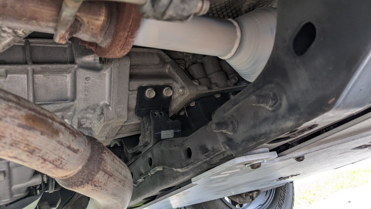

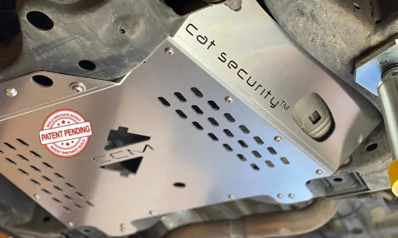

    Those braces come with 4WD Tacoma's and not 2WD, it's used to support the structure for the transfer case. This whole era of shields started out as skid plates now, because of cat thefts, shields are being made to protect them. Confusion between 4WD and 2WD shields started in the beginning with statements being made that 4WD shields can fit on 2WD. Not the case, the transmission crossmembers are different and the there is a height level difference between the trans. crossmember and front suspension. 4WD are basically flat where 2WD are offset, meaning the front suspension sits lower than the trans. crossmember. I will provide photos, Talon's shield is the last photo. Talon does sell the thickest shield, 1/4", but there are areas that thieves can get to and cut out the cats. Member Taco 14barc seems to have notice this problem. Cat Security does a better job, but their shield is only 1/8" thick. I decided to add an alarm system and put a shock sensor on the shield in the event that someone decides to cut the shield. The vibration will set off the alarm and hopefully scare them away. This idea of harming someone is validated, I would be piss off too, but you have to remember two things. The law prohibits you from outright hurting someone, unless you're defending yourself from bodily harm, and those you harm may come back later and do more damage to you, your family or your home. The money you may spend to protect your investment far outweighs the money you'll spend for repairs, finding a shop that isn't booked and what's getting harder...finding state certified cats. Probably because of the war in Ukraine or the growing level of a new virus, China has slowed or stopped their exporting.

    This image shows my reciprocating saw with blade resting on the cat intake pipe.
    UPDATE: Talon provided new wings that cover now cover the area very well, see pics further down this thread. they have updated the design so future orders get the improved wings.
