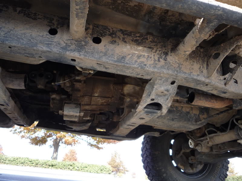

    Our trucks have 4 cats...the bottom aft 2 are the one's being ripped off. After reading about this happening a few years back I had a plate fabbed up. It's removable and attaches to the two threaded holes in the frame and the cross member useing hardware that a normal wrench or socket won't work on. I added additional heat protection around the wires to the sensors and made sure the design allowed for good air flow. It's been on for 3 years now with no problems.

    Can't remember who, but one guy recently made a cat cover out of expanded metal.

    That is what i have been looking at. From looking at it, the driver's side cat and oil pan hang about 1" lower than the frame, so i have to find someone with a sheet metal brake. I figured that and bolt it in with torx bolts, still up in the air as to cutting an access hole for the oil drain, or just dropping the whole plate each time. The air flow is a bit of a concern - wondering if maybe a few rows of 1" holes might work

    i got one made through a friend, 12ga steel, did the speed holes in it. Held up by 4 torx bits. just have to sand it down, clean it, and shoot it.
