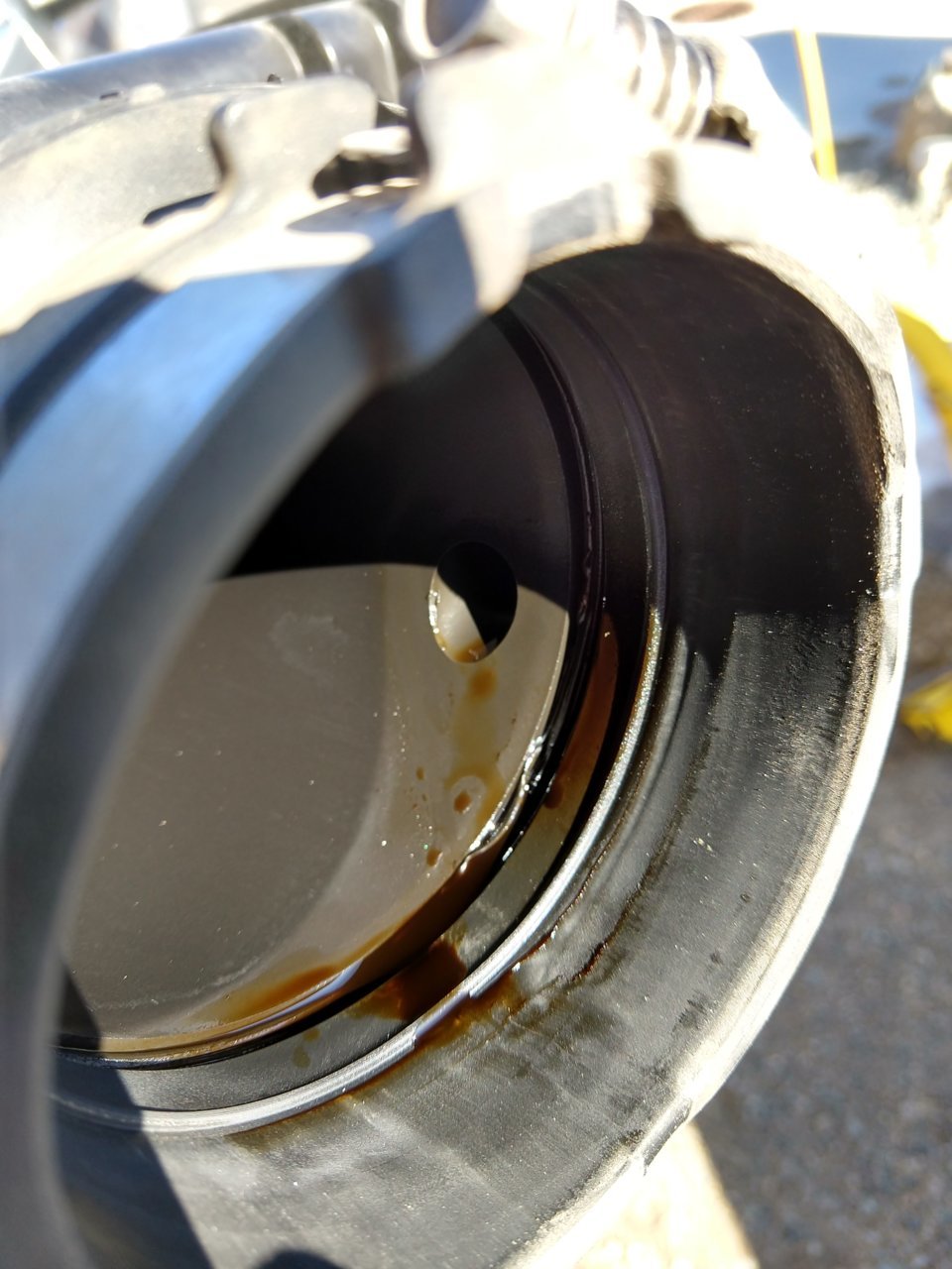

    Bilstein 8112+650lb coils, 8100+Deaver Stage II leaf pack, SPC UCA, DuroBumps, Mobtown 0* sliders W/fill plates, Mobtown Recovery Bar, Radium PVC & CCV Dual Oil Separator Catch Can System, Snugtop Hiliner Sport, ATH bed Stiffeners (cuz bottle openers!) + front corner tie down, Badger plates for Firestone airbag + Relentless U-bolt flip + Daystar cradles, TRD Pro shift knob, TRD Exhaust, HPS Silicone intake tube, Green Filter, TRD Intake Air Accelerator, 265-70-17 Toyo Open Country ATIII on TRD 17" Rockwarrior Cold Forged wheels, TRD alloy front skid, RCI Aluminum transmission & transfer case skids. Much Meso awesomeness, FreshMexicanTaco TacoGarage Camera Controller + DDM, 67 Designs cradles, Banks Pedal Monster + iDash gauge, WarFab Sheridan hitch skid, Ricochet LCA aluminum skids, Rago lower rear shock guards, FN Koning Countersteer 16" spare, OEM T4R 90105-14104 coilover lower mounting eye bolts
    Three years old, 35k miles, my truck. Never had the intake tube off, always replaced the air filter with OEM at 12k.
    This oil left a trail into the throttle body and tb flapper.
    This is the residual stuff that a proper catch can will collect before it goes into the intake and the throttle body.
    2016Taco likes this.
