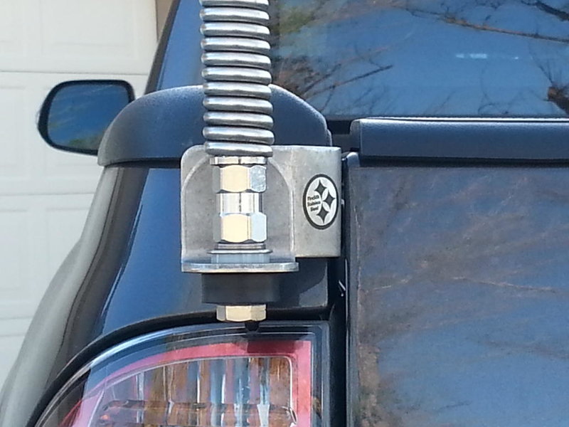

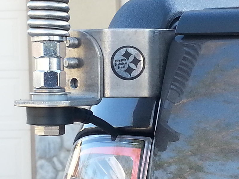

    After studying everybody's mounts I came up with this version of the install that works really well for me and allows me to install covers and or tops without any interference from the antenna. And it looks really clean without any wire hanging and when viewed from the back all you see is an antenna and the tail lights. The tail light is completely unobstructed.
    The key was using the fire ring for the fire stick which let me run the antenna cable into the crease of the tail lights and I just notched the tail light with a small file and then ran the cable up underneath the vehicle to the back of the cabin.
    GHammer and ZIB like this.

    Just wanted to say thank for posting your setup, I'm gonna go with pretty much exactly how you have your antenna mounted.

    Thanks markcgervase!
    I'll be doing the same set up! After hours of reading through threads and on-line shopping this seems like the set up for my rig. Is there anything you would have done differently and what CB are you using?

    Hey I'm not mark but I did about the same setup, just FYI it wasn't necessary to file away the taillight, if you look right about where the antenna mount is, there's a small opening just big enough for the antenna cable. I still had to remove the taillight to thread it, but doing so makes it a lot easier because there's also a circular opening right behind the tail light to continue on through. The only difference is that my firering is rotated slightly.
