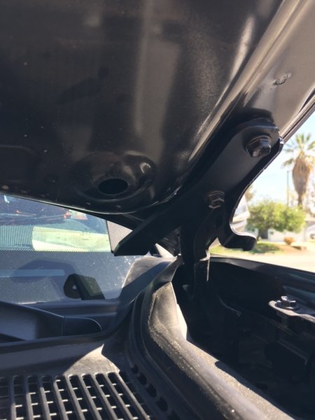

    Hey guys, received the CB mount this week and installed it in about 3 hours with my dad.
    First I poked a hole in the boot on the driver side firewall. Cut slits in the hole to allow the fat Firestik K8R9, and pulled it through with a wire hanger.
    Then I installed the Relentless Fab CB hood mount.
    http://www.relentlessfabrication.co...s/2016-tacoma-hood-hinge-ditch-light-brackets
    It was easy with my dad holding the hood in place. I primed and painted the bare steel, it turned out pretty clean. It's pretty much out of the field of view, I'm happy I went with the driver side (I was thinking long term for when I run wire for LED lightbars, etc. I wanted the fuse box and wires all run on the driver side).
    I had a 12 port Blue Sea Systems fuse panel.
    I did not want to commit to drilling into my truck, so I bought outdoor mounting tape and layered it on. (came out very stout, it's not going anywhere).
    Sat it right up next to the hood ditch. Now I can run all my accessories to that going forward.
    Unbolted the two bolts on the inside of the center console, and popped up the center console from the back seat (it's held on by snap clips by the center cup holder).
    I ran the CB power and antenna wire through the firewall, over the steering components, and through the center console to the back.
    A drill wouldn't fit so I took turns with my dad hand drilling on the inside of the center console. We fished the CB antenna wire through the back of the center console piece, and through the hole.
    I assembled the plate that came with my Cobra CB kit, and screwed it in. (the plate got warped a little when tightening, so we just smashed it back flush... that's why I wanted everything in the center console... out of sight, out of mind!).
    Got full power on the CB and perfect clarity testing about 30 feet away from my dad's Jeep. Nothing on the interior of my truck is messed with other than in the center console, so it's still got that stock look inside! Overall very happy with Relentless's craftsmanship and customer service. The antenna is sitting pretty straight up and down though, I might take off the assembly and bend the tab back just a little bit (and maybe weld a gusset to the bracket for sturdiness). Definitely going to buy a 2 foot antenna instead of the three foot seen above.
    Let me know what you guys think!
