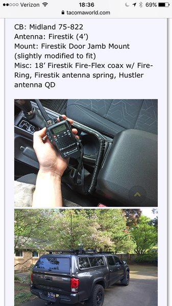

    Yeah, like the tonneau but I want to move to a bed cap. I really like this setup. I forgot who this was but it's pretty nice. All you have to do is run the coax thru the taillight onto the frame rail and up through the grommet under the passenger seat. I have yet to do it though!
