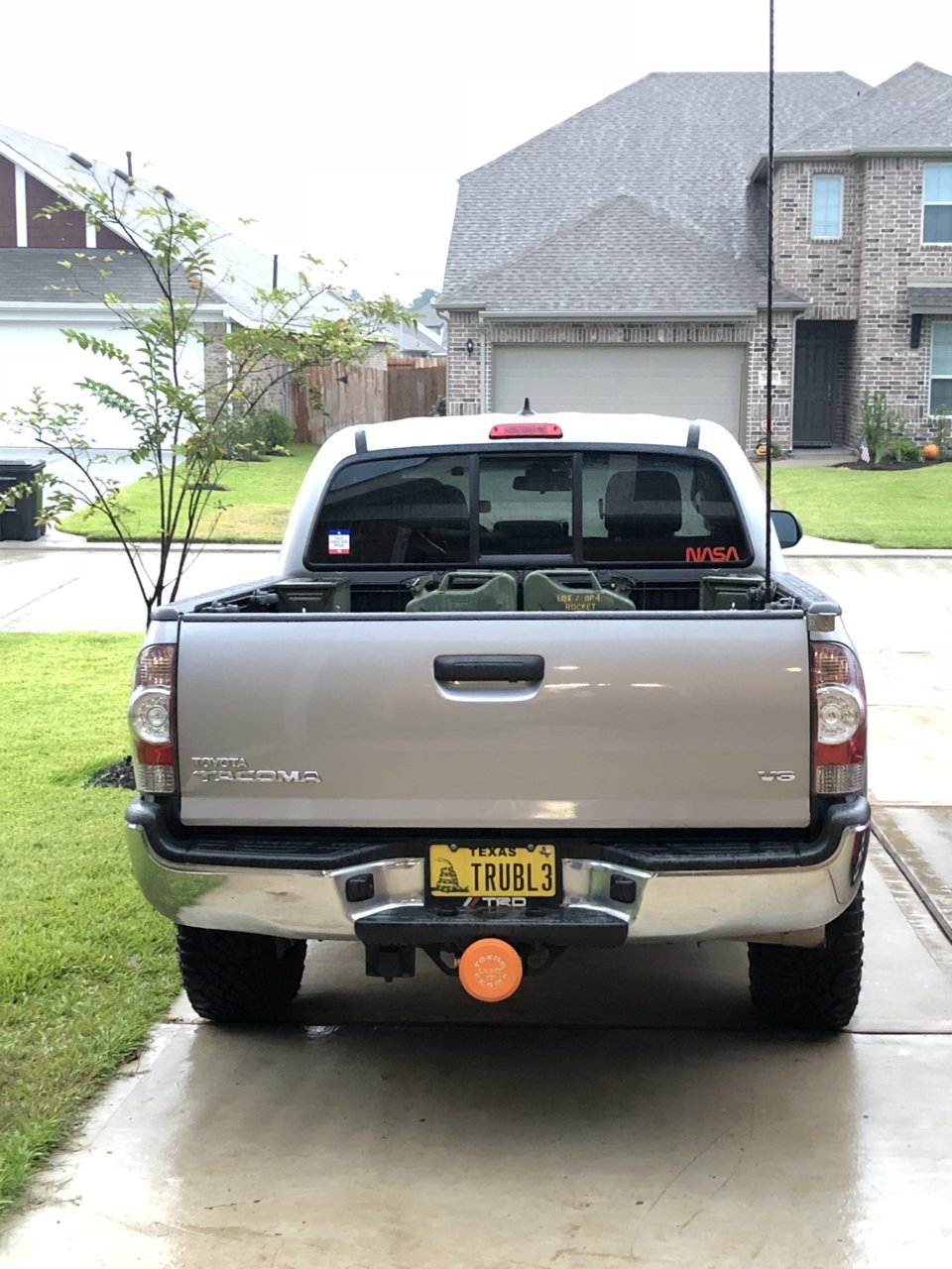

    2,270
    Conrad
    I have a 6ft firestick on a spring with 1.1 SWR mounted to my passenger side Total chaos bed stiffener. I have confirmed 7mi communications with it inside The Woodlands. If you’re getting into coms, save top of the roof for HAM antenna magnet mount.

    This is the 6ft Antenna I have
    This is the Spring that I have it mounted on
    If you go 5ft you can add quick disconnect
    Next Ham radio will be this one - Midland 5001z (currently on sale I think $30 off) Has a lot of great internal features. I just need more gain and squelch controls than the one I currently have. Uniden Pro505XL For $30 it's not bad at all. I can reach out 7mi in the woods (I've confirmed that). But sometimes you just can't get the noise out as it's pretty basic. Great for on the trail and budget stuff but I've grown out of it already.
    But dont forget it's all about your SWR. Please don't forget to tune your antenna and pick up an SWR meter.
