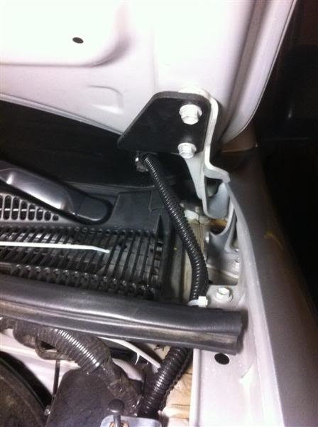

    Yeah, that is pretty much how I got my antenna cable into the cab as well. I however, put a hole in the center of that rubber cap that was just a little smaller than the cable so that it would still be water tight. My antenna cable had to be soldered on the other end yet when I did this.

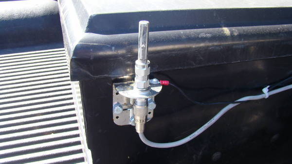

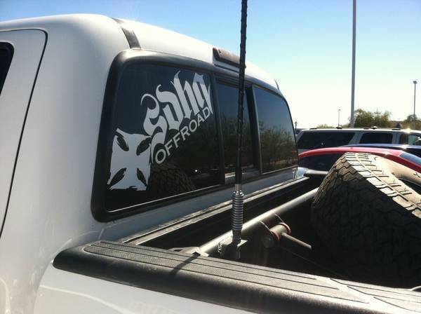

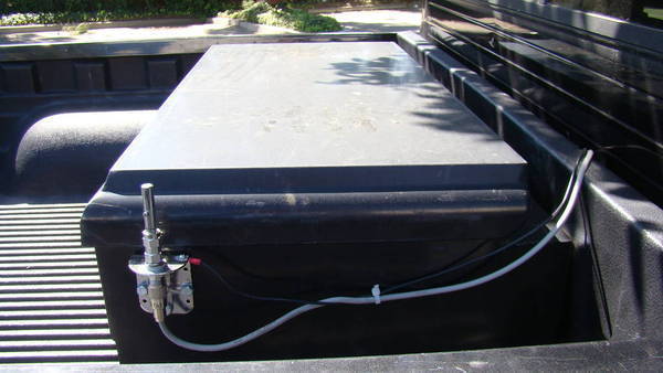

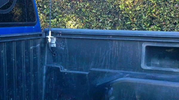

    562Tacoma
    562Tacoma [OP] Well-Known Member
    Sep 21, 2009
    #23079
    68
    Southern, CA (SoCal)
    08 PreRunner TRD Off Road 4x2
    -Maxtrac 4in lift spindles -5100's all the way around -Drilled and slotted rotors with ceramic break pads -Pro comp 1in AAL -17in wheels with a -6 offset (4.5 backspace) -1 - 10inch kicker comp (ported box)

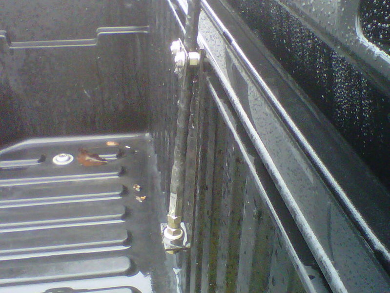

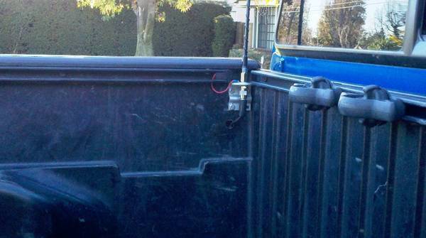

    CB is finnally on after I lagged on it forever... Thanks to everyone that posted pics up, hope my pics will help out anyone else that needs help

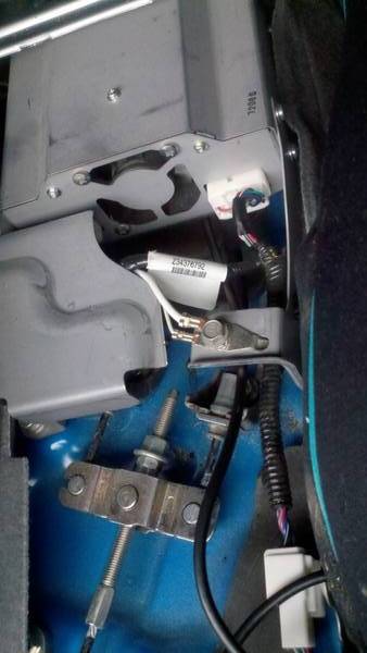

    Manwithoutaplan
    Manwithoutaplan the full Monty
    Jan 30, 2008
    #4500
    54,643
    ID
    Here are pictures on where i mounted mine

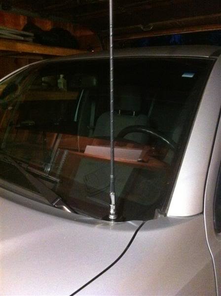

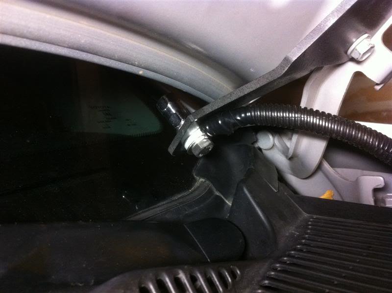

    Cleanest installation(no drilling for bracket install necessary) and looks really good from the outside in my opinion too....
    Thanks to PRS for the mounting idea from when he still had his Tacoma.
    PM me if you're interested in one of these brackets.
