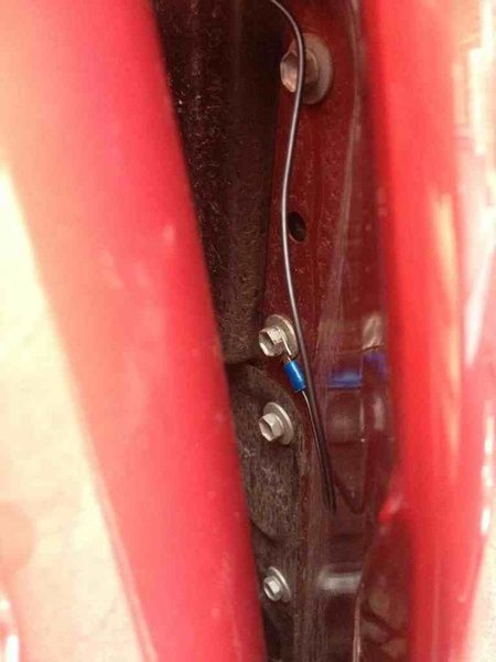

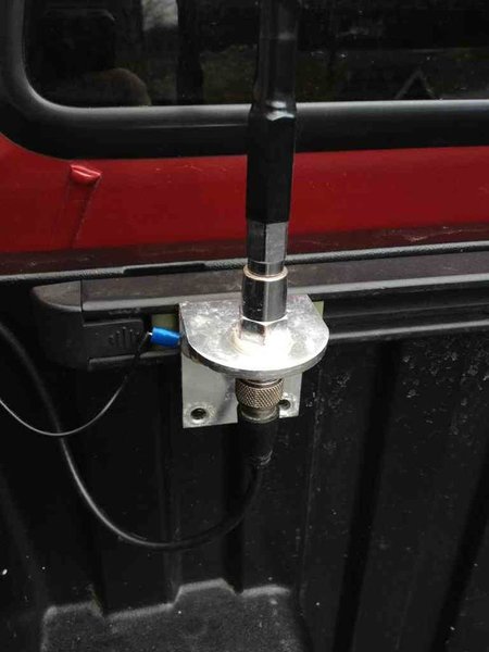

    Here are some pics... I'm still getting feedback and am about to throw the fucking out the window...
    im back to thinking the feedback is coming in through the power line to the cb, but wiring it to the battery or anywhere else doesn't change it. my ground to the radio is wired directly to the battery terminal..

    Rather than run the ground directly to the coax connector, try running it to the bolts holding the 90* bracket on. Also, use larger AWG wire -- 12 as a minimum. While I'll bet it is, are you *sure* that bolt you chose is a good ground? You might try adding some toothed washers to both connectors of your grounding wire.
    Do you have a pic of the underside of the bracket, where the coax connects? I'd be interested to see what your washer stack is there. Perhaps an exploded view (disassemble the whole thing and lay it out in order of installation)?
    If following the above steps (larger AWG wire, dead-sure of the ground, toothed washers, connecting the ground wire to the bracket and not the connector) doesn't solve or at least significantly improve your situation, try some of these:
    Unwind your coax and let it have as much breathing room as possible. It's possible that the sheer number of loops and parallel winds is not only causing an electro-magnetic feedback loop, but may also be picking up interference from the truck wiring that's in there.
    Move your antenna location to someplace significantly different (say, front bumper, hood hinge, rear bumper, roof). It's possible this is just a hands-down bad location; it's also possible that it's too close to the cab, and you're getting a bounce-back feedback effect (rare, but happens).
    Try choosing a different grounding bolt. The best would be if you could find a stock grounding bolt (will have wires coming from under it), because you'll KNOW it's good. It's possible the bolt you chose isn't as grounded as you think (it is, after all, a body mounting bolt not intended for electrical conductivity).
    Try a different antenna. I say this because I was experiencing a constant 3.0:1 SWR (indicative of a bad ground), and I was dead positive my old Astatik 3K was fine......until I swapped it for a brand-spankin' new Firestik, and suddenly everything worked like it should.
    Try a different, SHORTER coax. It's possible this one is bad, is too long (I've never heard of a 21' coax), or maybe is broken internally from your packing job under the door sill.
    If all else fails, and you've done all this, try moving the power locations. I doubt this is it, but it is entirely possible. Hook it directly to the battery to start with, then start moving the negative power wire around to different grounds. You might also try adding a grounding wire from the body of the radio to a good grounding location in the truck (so that you effectively have two negative/ground wires for the radio).
    And if you have done all this and you're still not seeing any improvement, I would tend to say your grounding issue has fried the internals of your radio. Have a shop look at it, or swap it out for another known good radio. If you were running for any kind of time with the antenna signal and ground wires shorted, you may have damaged the radio itself.
    Something to keep in mind during all this: Try everything one at a time so you can isolate the culprit. Do it all in a temporary manner so that once you find the problem, you can then permanently install the system with that one issue addressed -- don't do testing in a "permanent install" mindset, because you'll only get frustrated that you have to keep tearing it all down and re-doing it. While you're dong all this step-by-step testing, you should have all kinds of wires dangling out of all kinds of places in your truck, with all kinds of doors open (test operation with doors closed, however. It can make a difference). You may even have the radio sitting on your seat, upside down and open, so that you can try out different power/grounding combinations.

    the ground wire is running from a bolt on the 90 degree mount to that body bolt for ground. not sure if its good or not, just saw some other members do it, and it was a pain in the ass to get it there so I hope its a good ground... I unraveled the coax and it still feeds back, no difference :notsure:
    ill try some of the other suggestions and report back.

    After looking at your pics I'd say make a bigger better ground wire and go directly to the frame. As far as material try to find some braided copper like from here: http://www.mcmaster.com/#braided-straps/=kgpsmn
    I run my HF antenna(s) on the back bed pillar and run an extra big strap from the pillar to the frame, on 10 meters ( ham frequencies near CB) I have a dead flat match or 1.1:1.

    Honestly man I think it's where you have it mounted I've tried to mount it in the bed twice with no luck. After moving it to The front it's fine. Even had my ground on the same bolt. It's just not enough back there.

    From an experiential point of view, Nick and Stewart are correct. Also from a thinking-it-through-using-common-sense point of view.
    The antenna wants a large hunk of metal it can ground to. A simple grounding wire isn't going to work (it can be a backup for people like me who didn't want to remove powdercoat over a big hunk of metal the antenna is mounted to). I know I never hinted at this, but I was thinking it in the back of my head the whole time, and should have been more clear.
    Get it out of the plastic bed and onto something metal. Also get it away from obstructions (like the back of your cab) -- the more antenna you have above the truck the better the performance.
    As far as Stewart's claims about needing a huge flat surface area, this just does not agree with actual reality. In theory, yes, this is ideal. But I challenge you to find me anyone that actually does that (ok, so there are plenty of people who use a magnet mount on top of their roof) -- keeping in mind the number of Big Trucks there are, and how many you've seen mount the antenna anywhere other than the mirrors (Big Trucks are about half fiberglass and half aluminum -- the horizontal surfaces and the front clip are all fiberglass, while the cab and sleeper are aluminum). I'm getting a better-than-perfect 1.05:1 SWR with my Firestick II mounted via pipe clamps on the hoop of my powdercoated ARB bumper.
