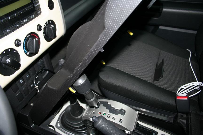

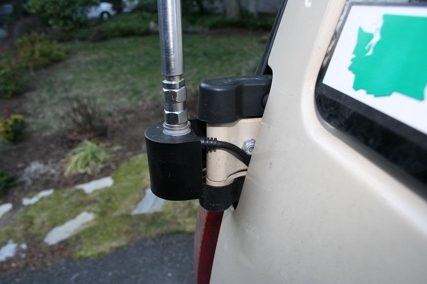

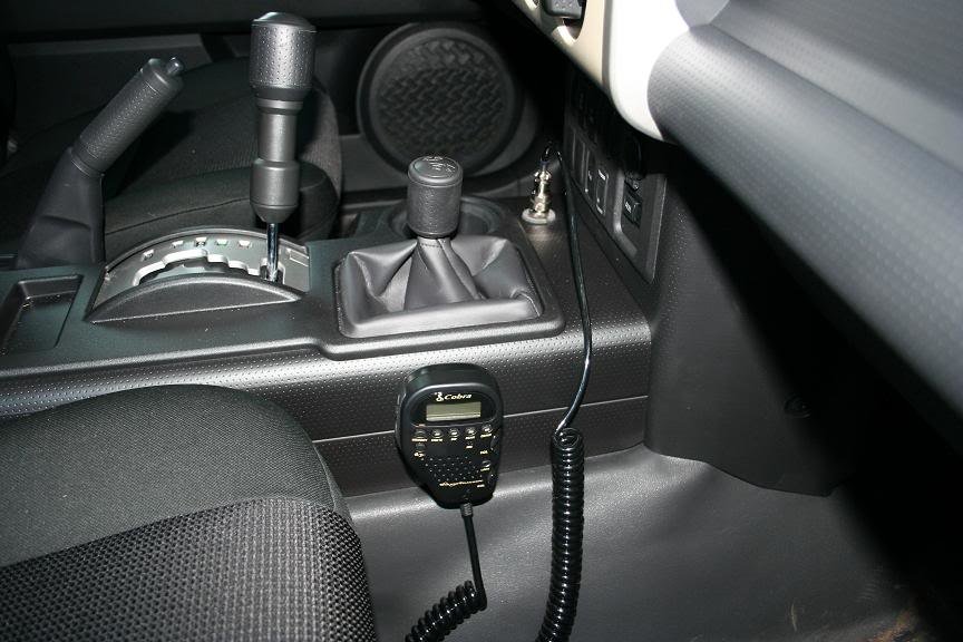

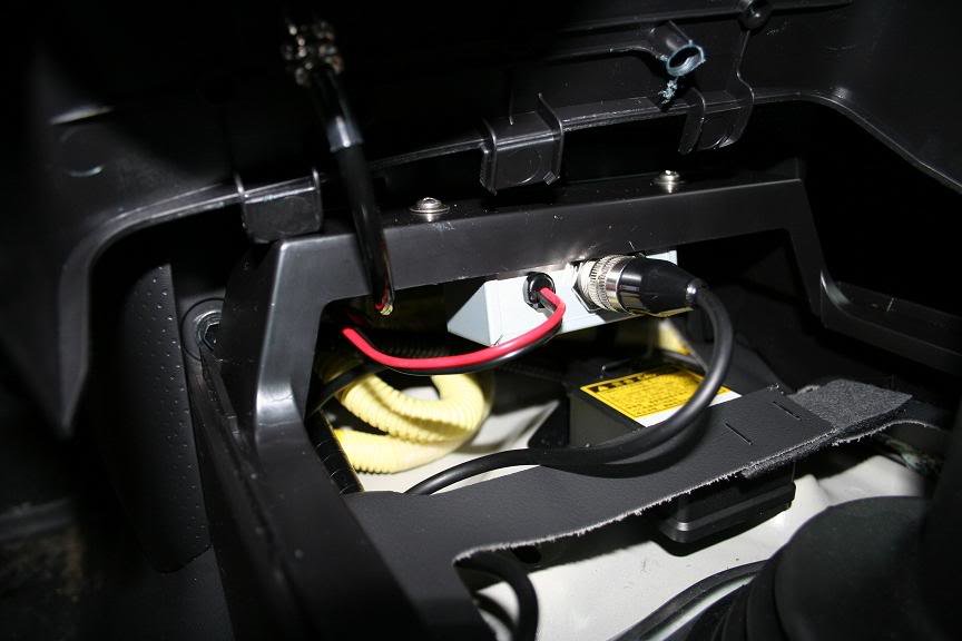

    I recommend the Cobra 75 WXST for a small compact cb for anyone looking.
    Since I got the FJ and the Wife was very against major surgery into any of the plastic so I looked around and found a cool setup being offered from Walcott CB called the "BigBillCombo". What really sold me was the nifty little "Bandi mount", created by a guy on FJCruiserforums.
    Got it for xmas and finally got off my lazy ass and installed it one weekend.
    I decided to mount the cb remote unit and cb in the center console and it worked out perfectly for me, the FJ's center console comes apart in 2 pieces and I was able to mount the remote unit under the upper covering piece and the actual connection to the upper covering piece. I wired power directly to the battery.
    Lastly I picked up a Vanco SWR meter and did a tune on it, probably the most important part of an cb install is the tuning of the antenna.
    Oh and the other cb I had for the Tacoma and 4Runner were sold to a friend that is trying to get a Heep, err I mean Jeep running.
    Upper piece removed
    Remote unit installed
    Mount installed
    Finally installed

    very nice mic hook up
